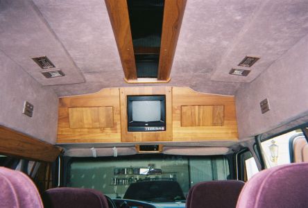

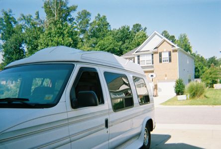

Here's my trouble-maker: My Van
https://images.2carpros.com/forum/automotive_pictures/216159_432177R102611A_013_1.jpg
Van - view from the bed inside
https://images.2carpros.com/forum/automotive_pictures/216159_432177R102410A_012_1.jpg

Looks like it's in cosmetically good shape!
