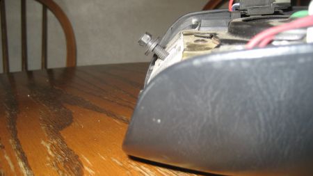

PINGELITO
  • 5 POSTS
the bolts on my airbag are a 8MM ( a very close relative to the 5/16.) however this is from my '98 and I know they changed the steering wheel style between then and '92. I wish I knew exactly then set up on the 92, but mine only has two 8 mm head bolts from the back of the wheel. there may be some little plastic caps that cover the bolt holes, and I remember having some trouble getting a socket on mine as well. a small mirror might be useful because the bolts are at a very strange angle compared to the airbag (Thank you again ford engineering dept!!!) the picture shows that you definitely have to search for the bolt head at more like a 45 degree angle than straight at the wheel. getting to see what you were looking at with a mirror may be the very best option. hope that can help some.
https://images.2carpros.com/forum/automotive_pictures/394354_airbag_bolt_1.jpg
Aug 12, 2009 at 8:03 PM
RAVENSANCTUARY
  • 35 POSTS
Thanks for the super quick reply to that one. I think the caps are his problem. and the angle thing was a good inclusion. I did the question for the that was driving his van and it quit like it was out of gas on the highway . mine did that right in front of a police station. It was a good one!!! and it stumped a dealer as well. Check out my reply. Thanks again too!!!
