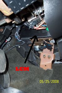

As it turns out, many people with the 2000 and newer CVPI's have had this problem. After taking advice from Dave and my mechanic, and running diagnostics, and checking with Ford Fleet operations, the concensus seems to be on the LCM or Lighting Control Module. If you have this same problem then I would recommend looking for a used LCM rather than a new one since they tend to cost between 400 and 600 bucks new. Ford knows of this problem and is still working on it but they have not as of yet fixed it. It seems to be happening with model years up to 06 and after that a different LCM was put in to the 07 and 08 models. I will be replacing my LCM soon and hopefully that will fix the problem. I will try to update this after I get it replaced and determine whether or not it is fixed.

I put in a new LCM which cost $442 and a new multi-function switch which cost $87. It took me about 20 minutes to replace them and since I have not had any problems with lights and I also noticed that the headlights are even brighter than before especially with the Silverstar Ultras I have. If you have the same problem with your CVPI, then you might want to think about replacing them both or atleast the LCM. But for sure get them both checked before spending the money. Don't take it to the dealer or mechanic to replace though, save your money and to do it yourself. All you will need is a phillips screwdriver, T20 star bit driver, and a 9/32 nut driver. Also a little patience when working with the plastic steering column shroud and the LCM connectors is a must! Good luck to all who have been following this posting in hopes of finding help.

Lets go through your questions. I asked the service guys at my local dealership about using a scan module and they said it is not neccessary if replacing the LCM, though it is generally a good idea. They do alot of replacements for the cab companies and city police departments in the area so its not an uncommon problem. I did ask the ford fleet rep about the module being a safety issue and they did consider recalling but since the problem was spread out and not one single LCM number contained the problem they said it is more of a case by case basis. And it is not detectable until it actually occurs. About the tick, I had that too when the lights went out. According to my service guys at ford it was the circuit breaker switching, but that is what its supposed to do. As for the entire unit going dead it was not. I still had my dash lights and tail lights working. Apparently it is some sort of design flaw in the LCM and it only applies to the low beams and constant on High beam function. The flash to pass function will still work though when it was malfunctioning. As for the wipers I have no clue about that. Same with the AC. I'm not a mechanic, just a loyal P71 owner. As for buying a used LCM, I would not because you never know if that LCM will have the problem. I bought a new LCM from Ford which was produced for the newer model years and was supposed to be clear of any problems. It did cost me about 420 bucks but if it keeps my lights working for while then its worth it, especially in my job.
