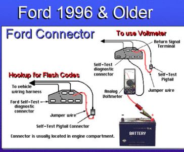

Even if the check engine light is burned out, test it by turning the key on, does it light? If not, it's peobably either burned out, or the circuit is shorted. If it's the bulb test it with an analog volt/ohm meter and count the needle sweeps.
https://images.2carpros.com/forum/automotive_pictures/62217_Test_Connector_Pre96_28.jpg
Count the flashes, a 22 will flash as 2 flashes then a short pause, then 2 flashes, if more than one code is stored, the pause will be longer. The codes will display three times and end with 11 or 111. Write them down and post here. First do this with the ke on engine off, then again with it running.
