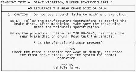

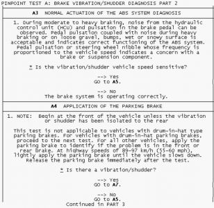

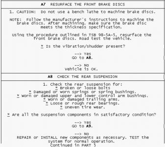

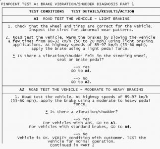

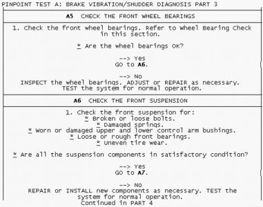

I had front rotors and pads replaced 3 times (2 re-dos) at about 54000 miles - each time there was a niticeable vibration when I applied the brakes. Problem continued and got a bit worse between then and now (75K). Went back to tire store and they replaced pads and rotors again. Now I feel a minor vinration but only when brakes are applied (gently) between 30 MPH and 40 MPH. Tire store assures me rotors were miked and are perfect. What is the problem?

Here's the Ford vibration diagnstic chart, work your way throught it!
https://images.2carpros.com/forum/automotive_pictures/62217_1_15.jpg
https://images.2carpros.com/forum/automotive_pictures/62217_2_15.jpg
https://images.2carpros.com/forum/automotive_pictures/62217_3_19.jpg
https://images.2carpros.com/forum/automotive_pictures/62217_4_6.jpg
https://images.2carpros.com/forum/automotive_pictures/62217_5_4.jpg
