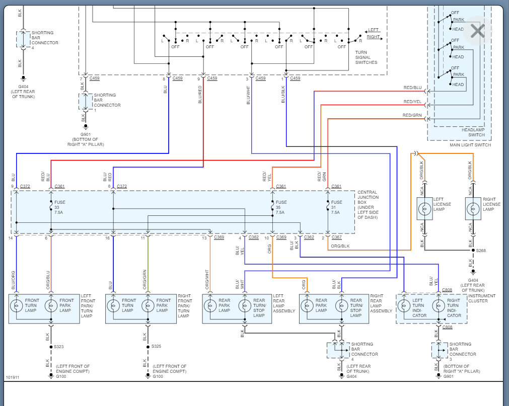

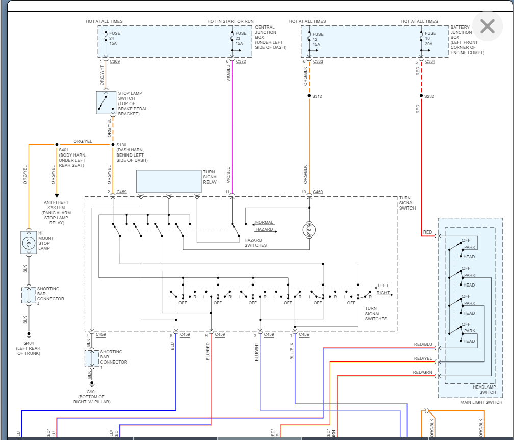

Turn signal just dead. Could it be a fuse
Jul 2, 2009 at 12:44 AM
BMRFIXIT
  • 19,053 POSTS
It could be a fuse but this is a shared fuse so I would think the likely cause of this is a switch issue.
So let's start with checking the voltage coming from the switch when the turn signals are on.
Below is the wiring diagram so we need to start with this and go from there.
Please let us know what questions you have. Thanks
