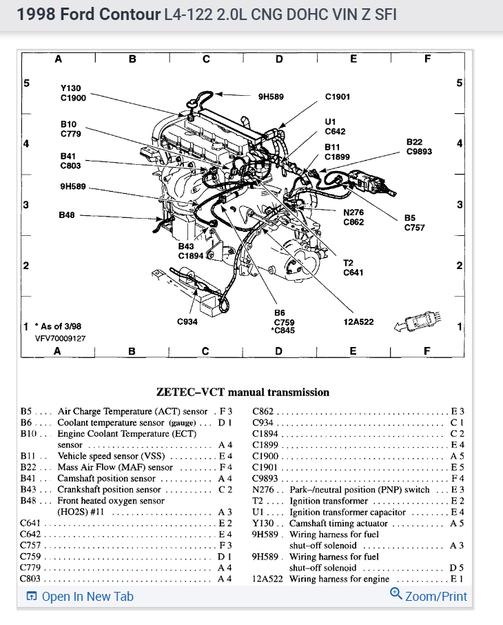

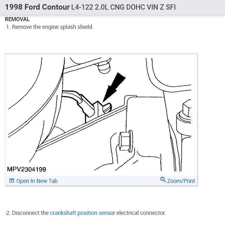

I can't find it if there's a picture it would be better. I have a book but it's not helping much. Thank you very much.
Jul 18, 2009 at 8:10 AM
✓Experienced Mechanic
75,992 POSTS

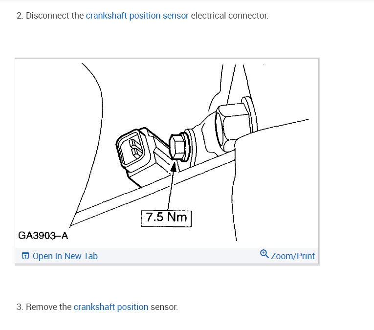

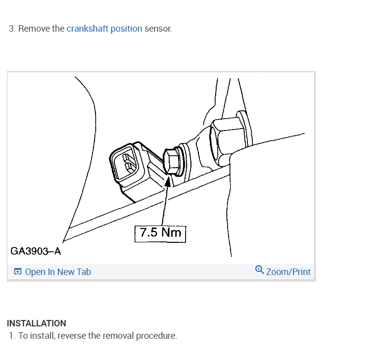

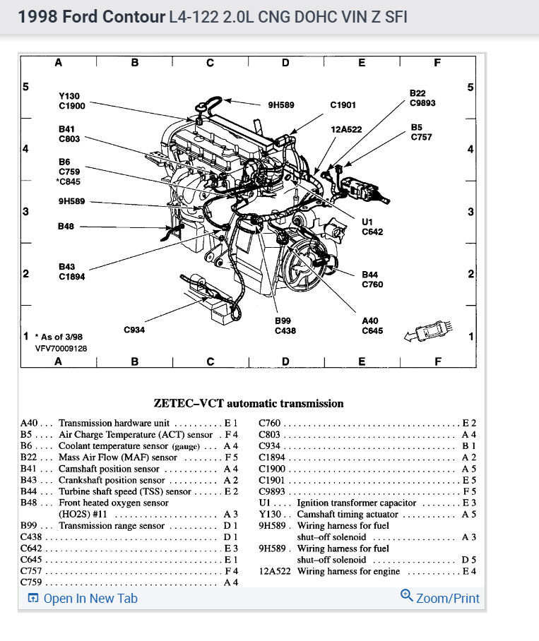

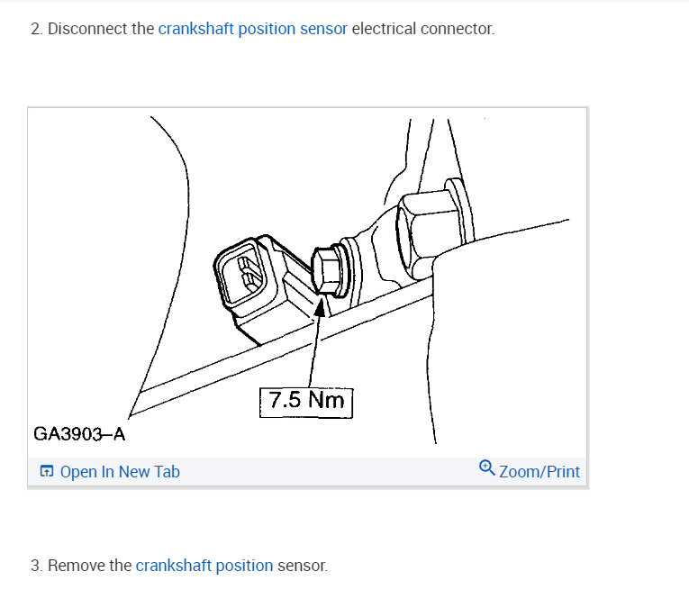

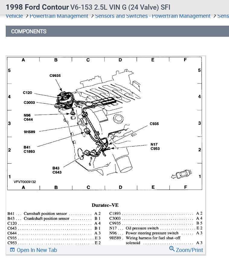

The crankshaft positioning sensor is located lower left side of engine. Here is both 4 cylinder and 6 cylinder engine locations in the images below. There is a difference between auto and manual transmissions. Check out the images (Below). Please let us know if you need anything else to get the problem fixed.
