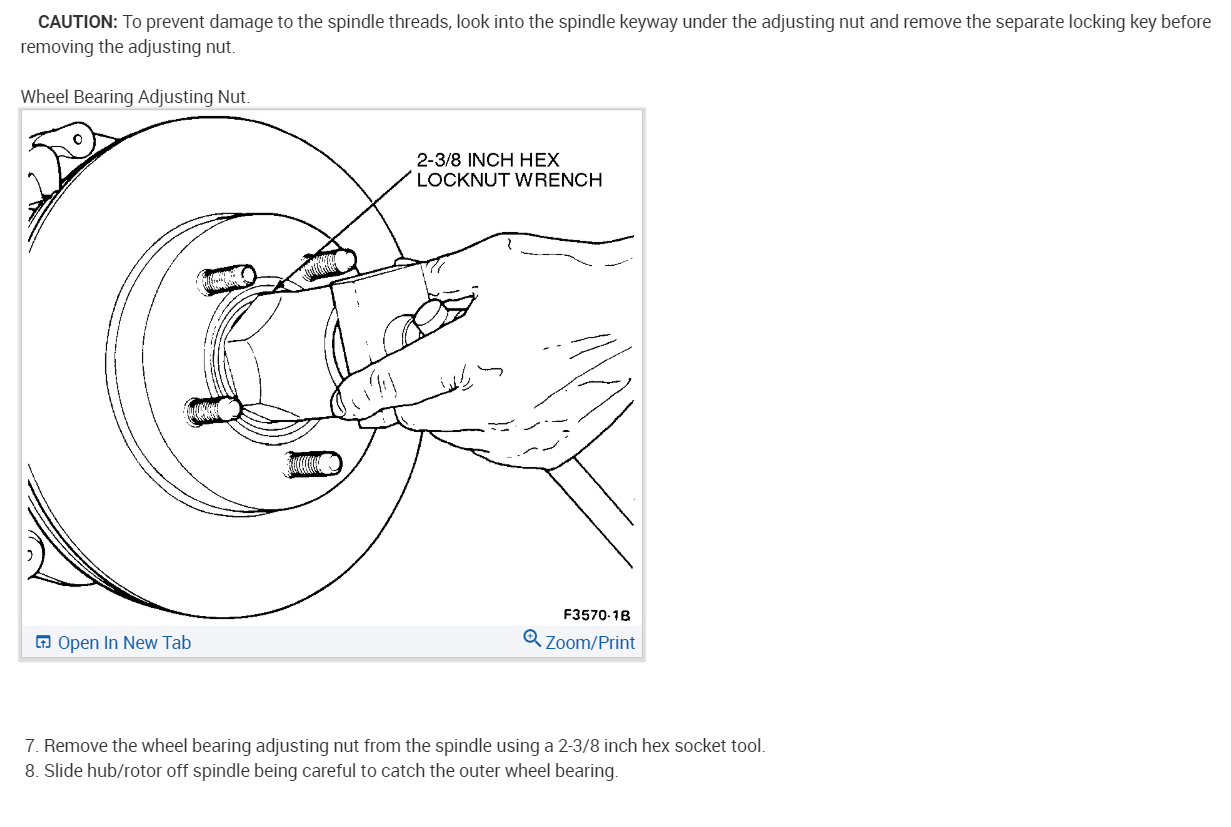

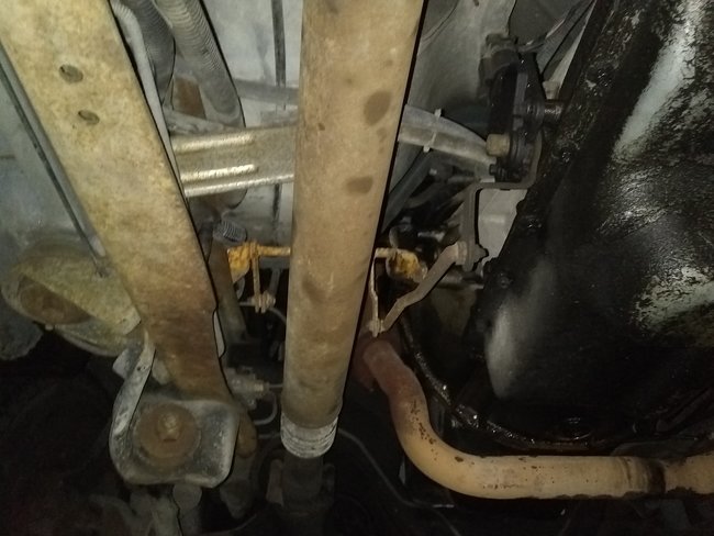

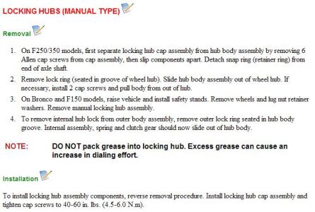

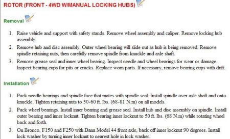

trying to change a rotor, took cop off of the locking assembly, took off the outer snap ring, took off inner sap ring, still can't get it off, comes out as far as the outer snap ring grove is there somthing I missed?
Sep 5, 2019 at 3:41 AM (Merged)
BLUELIGHTNIN6
  • 16,542 POSTS
auto or manual locking hubs?
MISER26
I have manual looking hubs, still having a problem
BLUELIGHTNIN6
  • 16,542 POSTS
https://images.2carpros.com/forum/automotive_pictures/261618_Noname_1603.jpg

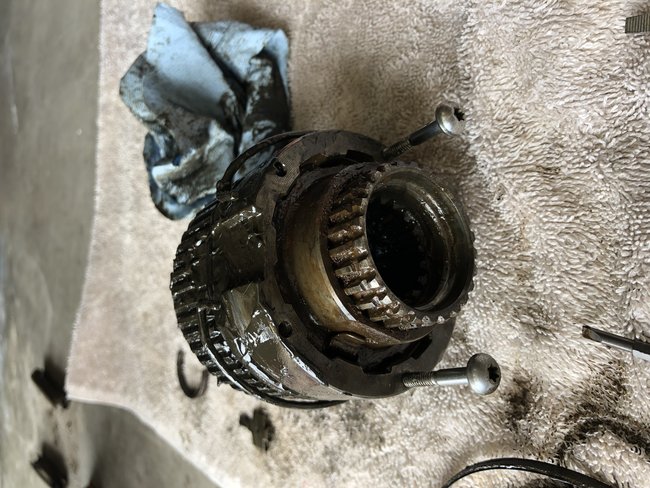

DONNY GURRUSQUIETA

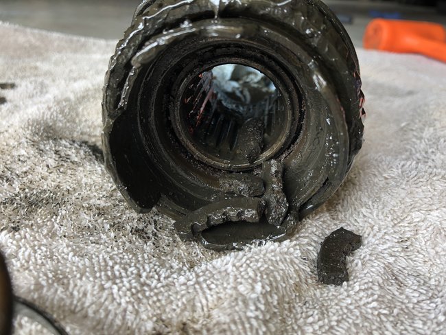

I have a similar problem with the assembly but mine is auto. I was able to pull the hub assembly but as I pulled the it off, pieces of what appear to be a gear ring fell off. Have no clue what or where they need to be replaced. I stopped there and haven’t pulled off the spindle nut to get to the bearings. Does anyone have an exploding diagram that I can reference to see what this part is and order a replacement somewhere? Also maybe a procedure or link on how to replace the rotors since these are shot(original) :-0? Thanks!!

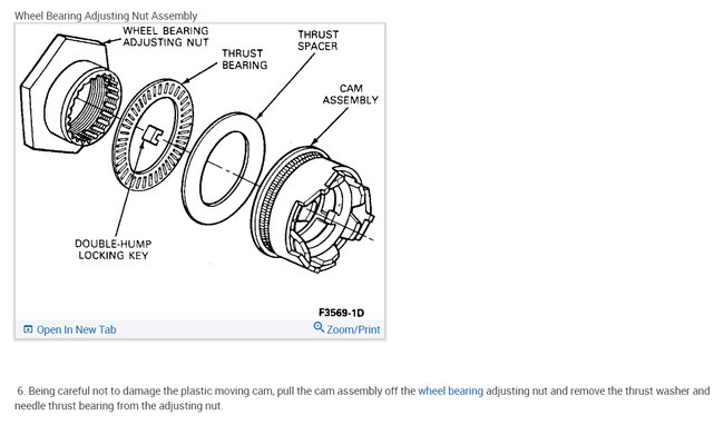

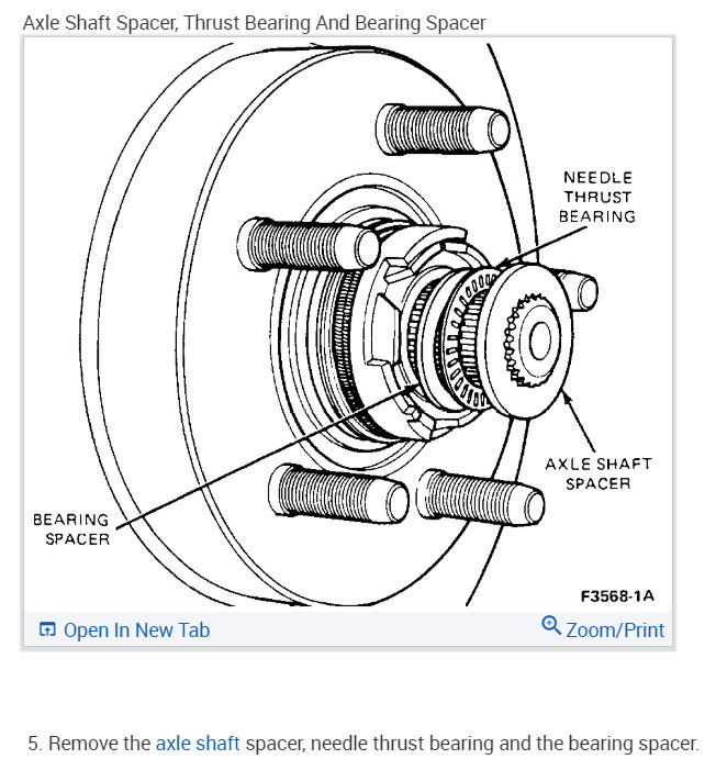

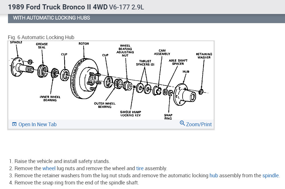

Here are the diagrams for the front auto locking hubs. Check out the diagrams (below). Please let us know if you need anything else to get the problem fixed.
