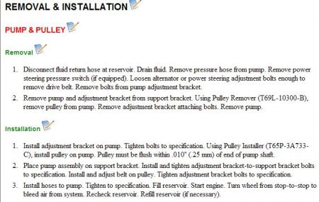

BLUELIGHTNIN6
  • 16,542 POSTS
Okay. Below are full details for removing your power steering pump. It involves the use of a special service tool (pulley remover).

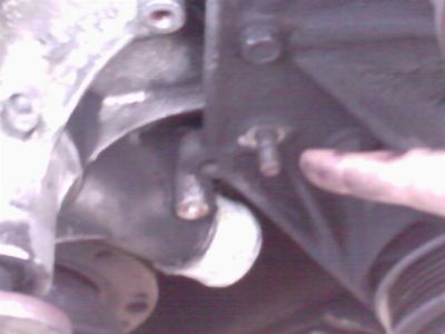

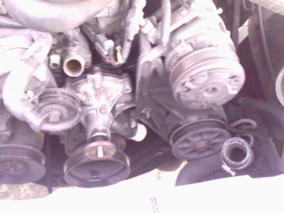

HOBEE88
  • 5 POSTS
https://www.2carpros.com/forum/automotive_pictures/308427_overview_of_engine_1.jpg
https://www.2carpros.com/forum/automotive_pictures/308427_specific_bolt_1.jpg
I have attached a couple of pics. One of the whole engine and the other I am pointing to the specific bolt. We can not figure out how to swing the power steering pump or ps bracket assembly out the way. As you can see from this picture this bolt is in the way. What am I missing here?

BLUELIGHTNIN6
  • 16,542 POSTS
You can not get to bolt from behind bracket to remove bolt? Or is it stud?
Saturday, January 31st, 2009 AT 11:08 AM
HOBEE88
  • 5 POSTS
Its a bolt or stud I guess coming off the water pump so you would either have to move the bracket forward towards the front bumper or the pump backwards towards the rear bumper to back it out of the hole neither of which is possible?
Saturday, January 31st, 2009 AT 12:26 PM
KEN L
  • MASTER CERTIFIED MECHANIC
  • 48,712 POSTS
Hi, you will need to remove the other bolts that hold the bracket, then remove the rear power steering pump bracket, this will allow the whole assembley to come forward off of the stud. There is a hex on the stud after you remove the braket/pump assembly to remove the pump.
Saturday, January 31st, 2009 AT 8:47 PM
HOBEE88
  • 5 POSTS
Thanks for all your help so far. We have removed the two bolts you can easily see in the pic but can not figure out where else there might be bolts that need to be removed. Any chance you can provide specific locations of the additional bolts and pics if you have them. Thanks again.
Saturday, January 31st, 2009 AT 9:06 PM
BLUELIGHTNIN6
  • 16,542 POSTS
Should be bolts from behind bracket.
