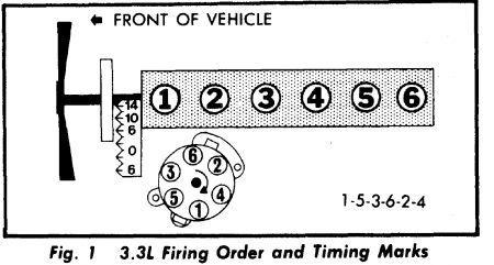

The engine will turn and sometimes acts like it wants to start, it also sometimes backfires while it is turning over. I pulled the spark plugs out one at a time to clear them out and a couple popped out a white/grey smoke. Is this because the wires are put on incorrectly? Or bad? If possible, can I get a spark plug diagram on where each wire goes?

This is what I have 3.3 I6:
https://www.2carpros.com/forum/automotive_pictures/62217_3_49.jpg

But does this apply to the 4.9L?

Yes firing order is the same, but I think the timing marks might be different, you can compare.
https://www.2carpros.com/forum/automotive_pictures/62217_4_23.jpg
