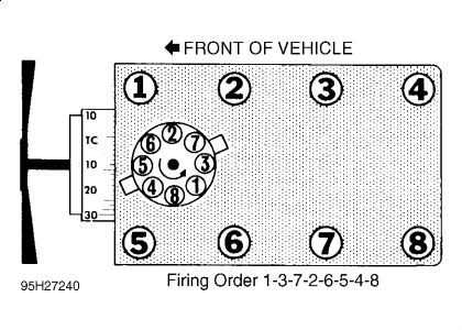

what is the firing order for a 95 ford bronco 5.8L v8

Does it matter where #1 starts. Or as long as its in that order it will be fine.

For sure it does matter you have to have it as you see it unless the distributor was removed and turned
