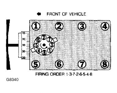

need firng order please

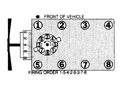

5.8L
5.0L & 7.5L
