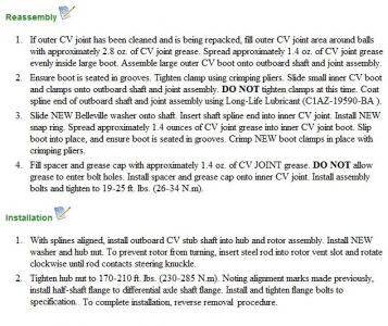

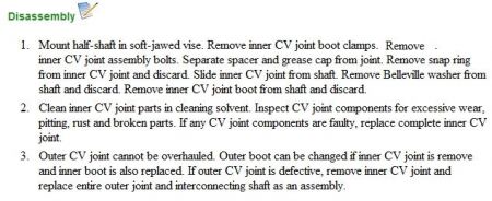

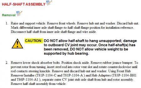

I have a torn cv boot and need to replace it. I need to know 1) can I reuse the hub? 2) Are there different types of boots? 3) Is the axle two pieces? Can it be separated to slide the new boot on? 4) Will i need a special ring spreader or will I be able to use a screwdrive and pliers?-(I bet it depends on what ring is sent with the boot)
Yes, I'm female and haven't worked on cars much since high school. 25 yrs ago!

Hello and thanks for donating Below are the proper steps to take in replacing your vehicle's cv boots. If you need further assistance with this repair just let me know..
https://images.2carpros.com/forum/automotive_pictures/261618_Noname_2408.jpg
https://images.2carpros.com/forum/automotive_pictures/261618_Noname2_781.jpg
https://images.2carpros.com/forum/automotive_pictures/261618_Noname3_286.jpg
