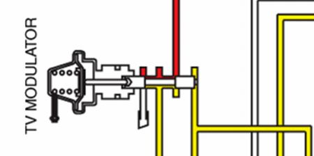

I am adding about 2 quarts of transmission fluid every two weeks and have no leaks. After driving for 15 miles or so I notice that I am getting blue smoke from my tailpipe. I am not burning any engine oil.I have changed the transmission filter and gasket and have not had any luck. Is it possible that fluid is making its way up to the engine and I am burning fluid that way.

TV modulator is no good. Has a vacuum line and the diaphram is leaking tranny fluid, which is being sucked into the engine and burned off.

Just made the repair. Problem solved.
Thank you
