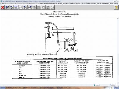

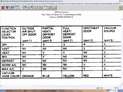

On the feed line look for the small check valve, it will be on the line from the manifold, if the check valve allows suction both ways, replace it. You are looking for the white vac line and the check valve, if it works OK check the vacuum line to the auxillairy heater in back.
https://images.2carpros.com/forum/automotive_pictures/62217_Aerostar_1.jpg
https://images.2carpros.com/forum/automotive_pictures/62217_AerostaAuxr_1.jpg
https://images.2carpros.com/forum/automotive_pictures/62217_AerostaVT_1.jpg
Test the vacuum at the control head, if it's as shown, the leak is in the enine compartment, or the rear line. You may have a vacuum leak, get a can of spray gumout, spray the vac lines and maniflod area, when the idle changes, youve found the leak! You want the engine running and spray on the outside but do direct the stream onto the hoses, if it is a vacuum leak, the engine idle will change speed, then you have detected a leak,
