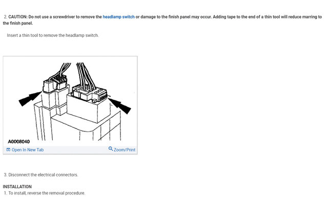

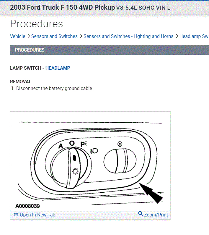

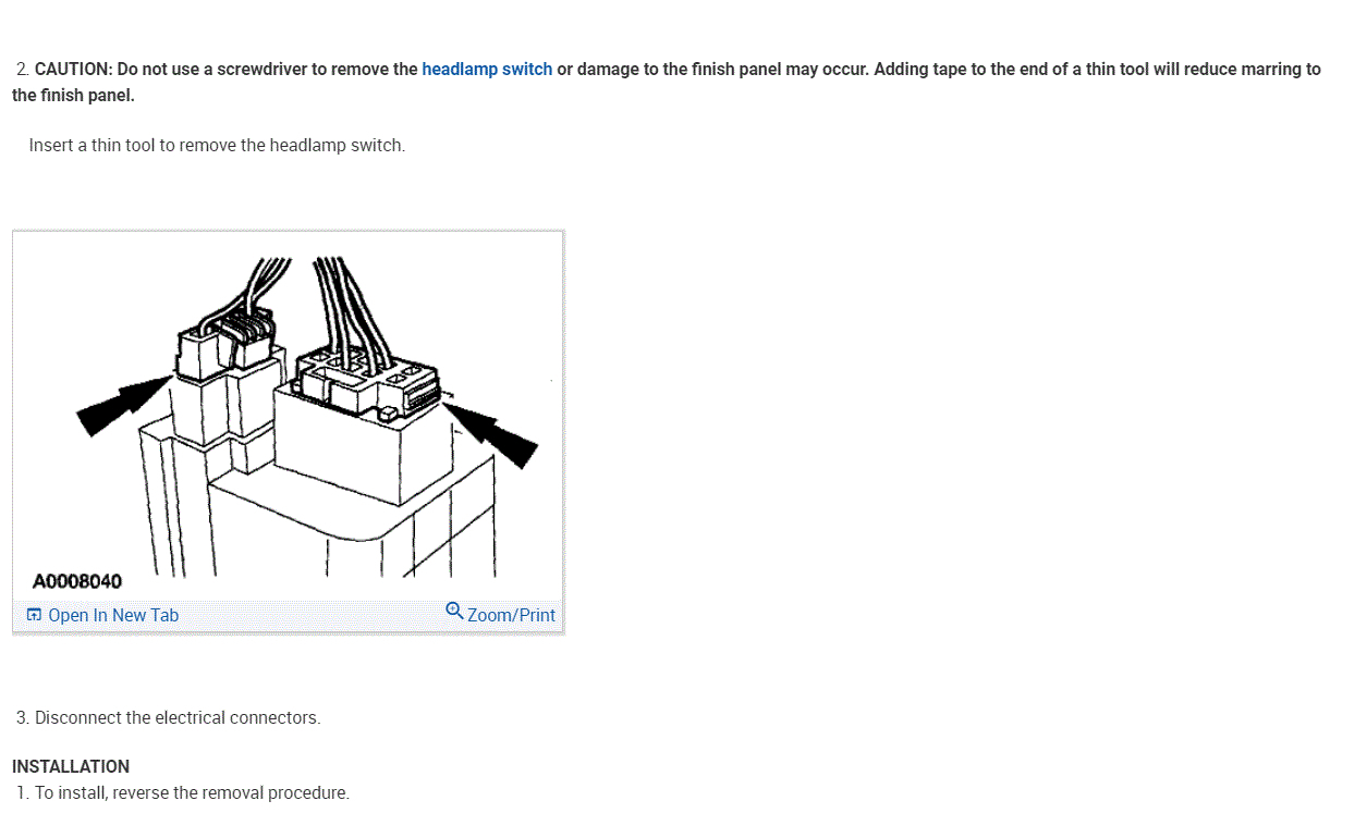

Sounds good. Let me know if that takes care of the issue. Also, I attached the directions below for replacing the switch. I don't know if you need them, but I figured I would add them in case you do.
