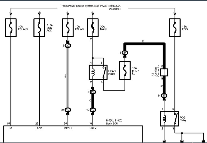

If so how do I do it? I see the pull out panels in by the front bumper area.
Jun 5, 2021 at 10:50 PM
DANNY L
  • 5,648 POSTS
Hello, I'm Danny.

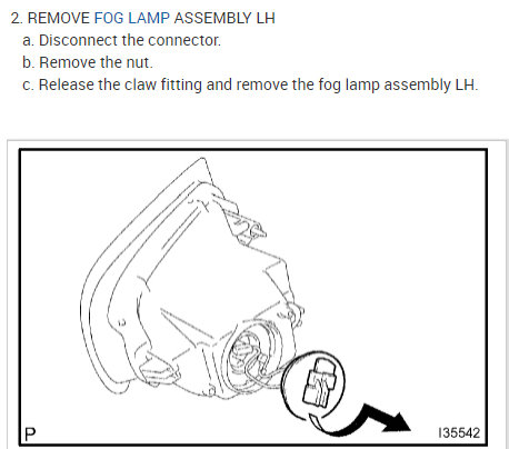

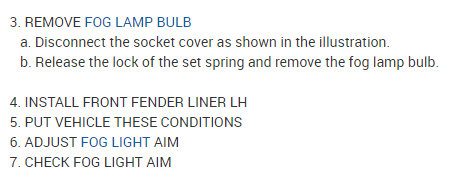

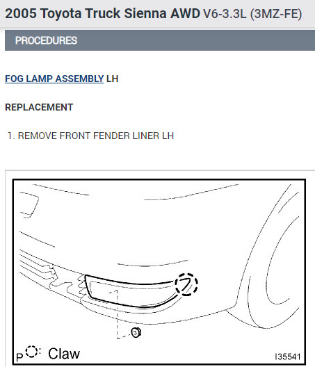

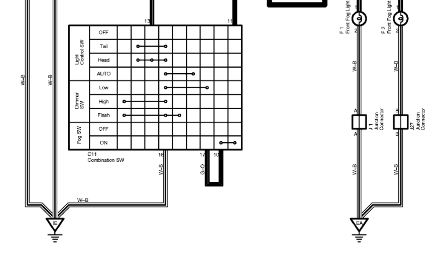

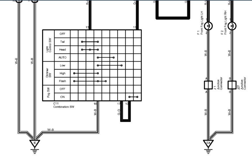

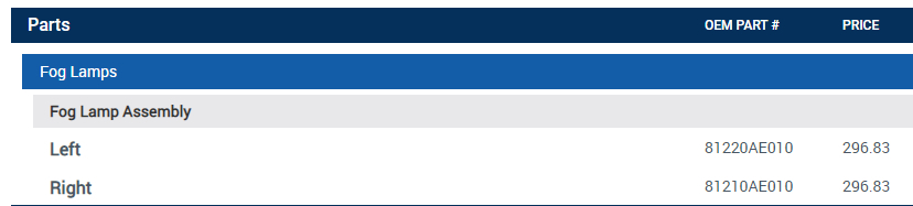

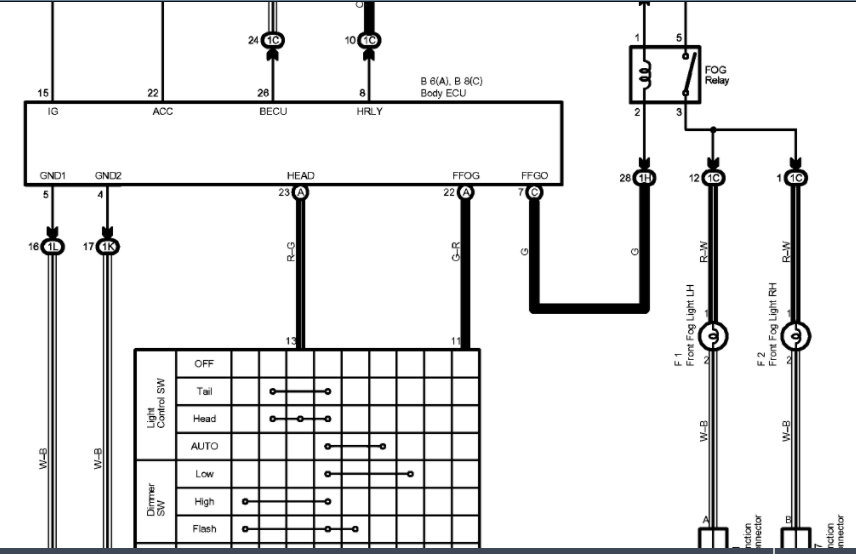

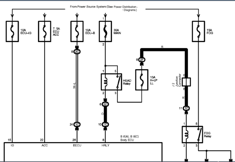

Yes, it's fairly simple. You need to purchase the factory fog light assemblies and then it's simply plug and play. After removing the cover panels the mounting holes and factory wiring connectors are there. I've attached the mounting procedure and fog light wiring harness for a reference. I've cut the wiring diagram into 3 pieces so you can view larger. Let us know if you have any further questions on this issue. I've also attached a picture of the factory Toyota fog light part numbers. Hope this helps and thanks for using 2CarPros.

so the wiring is there, all I need to do is just buy the fog lamp assembly and just plug and play. No running wires, splicing and finding grounds and power and running cables through the firewall underneath the hood.

IMAGING
  • 151 POSTS
how do I look up the light assemblies? will this do?
Jun 6, 2021 at 10:29 PM
DANNY L
  • 5,648 POSTS
Hello again.
Yes. Those will work. Remove factory cover. Install fog light. Plug factory harness to bulb. Done. Hope this helps and thanks again for using 2CarPros.

DANNY L
  • 5,648 POSTS
Hello again.

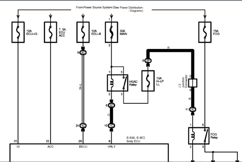

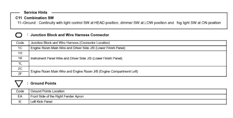

I've attached pictures below of the fog lamp wiring diagram for you to view as to what to look for adding fog lamps to your vehicle. I've cut the picture into 3 pieces so you can view larger. Hope this helps and thanks again for using 2CarPros.

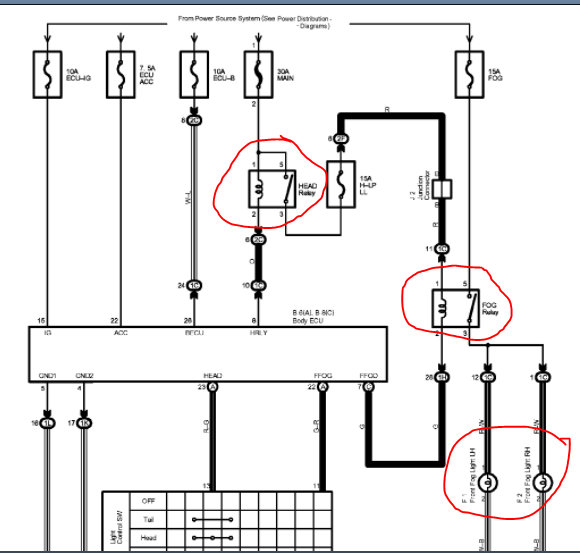

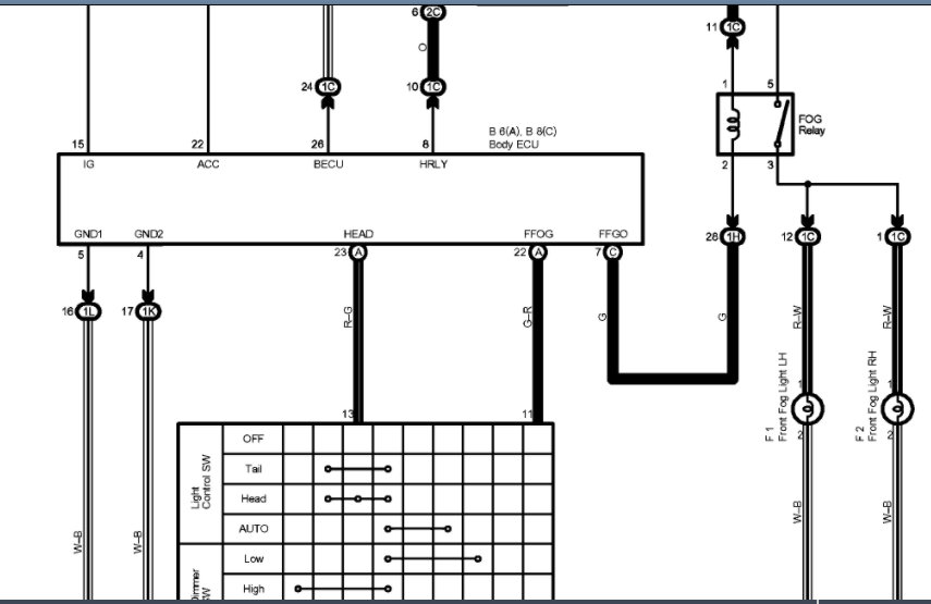

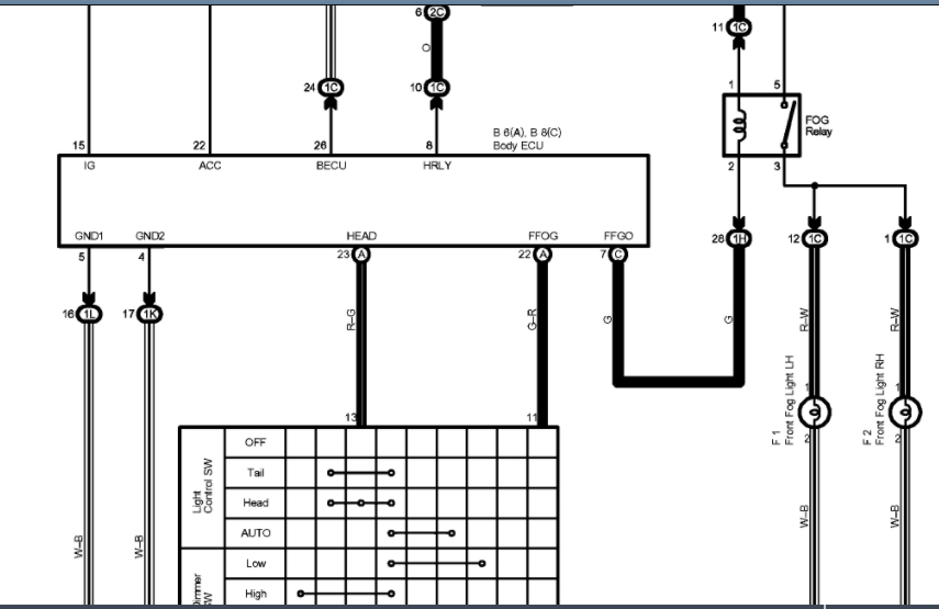

There is a harness for the fog lamps. I found it behind the fog lamp compartment. I connect it to the fog lamp assembly but the lamps don't go on. I just need to know where this harness is going. Is it connected to the low beam headlamp power line? I would like to have a switch to turn on and off the fog lamps but I don't want to add a harness if there is one there already. Less labor and time.
Jun 23, 2021 at 9:50 PM
STEVE W.
  • 15,295 POSTS
That harness is controlled by the body module and that has to be programmed to enable the fog light circuit to operate. As your vehicle didn't have fog lights it was never activated.
The fog light switch is part of the multifunction switch assembly and also is required for the lights to work along with the fog lamp relay.
Now if you still wanted to use the factory wiring and control of the fog lights with the low beam lights turning it on you could add a switch to the wire that comes off of terminal 2 of the fog lamp relay. If that switch was wired so it provides a ground when on and opens when off the relay will turn on when grounded and you have fog lights with low beams. That is what the OE switch does, it tells the BCM to ground the fog light output and turn the lights on.

DANNY L
  • 5,648 POSTS
Hello again.
The Toyota diagram show the fog lamps run into the fog lamp relay and then into the headlamp relay. It's controlled by the Body Control Module. Diagram is attached below. The factory multi-switch is what controlled it from the factory but in conjunction with the headlamps but with a different switch you can turn then on and off independently of the headlamps. I will look into this wiring more and find what additions and switch is needed. Thanks again for using 2CarPros
