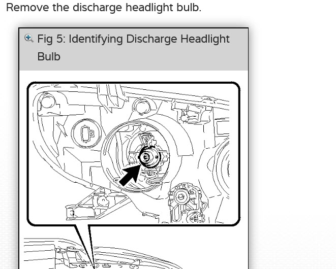

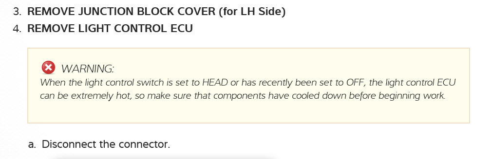

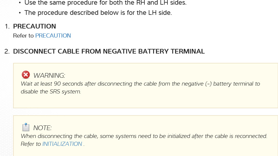

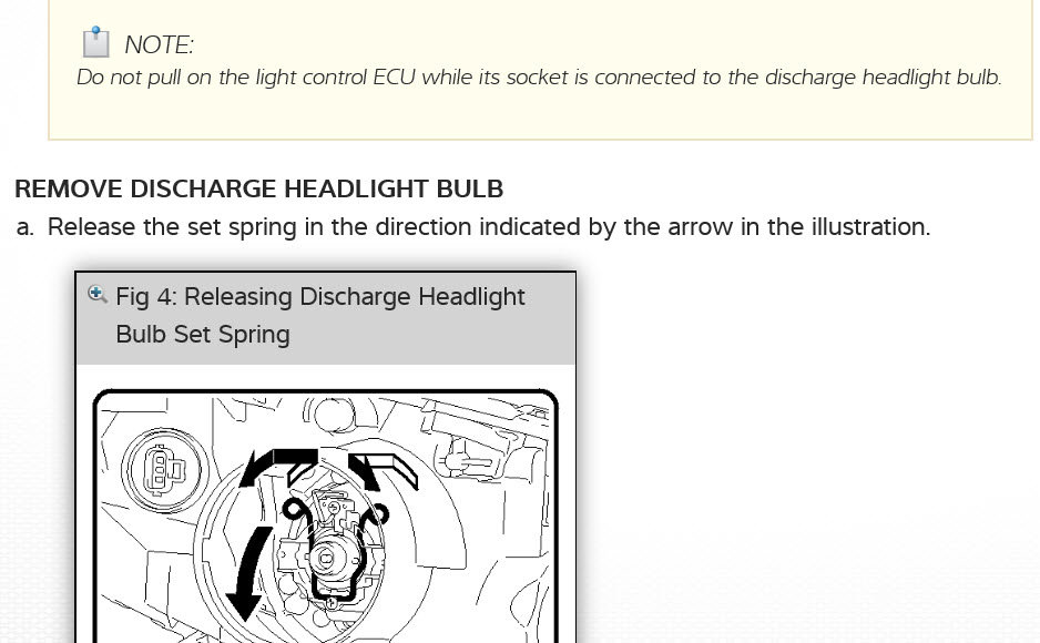

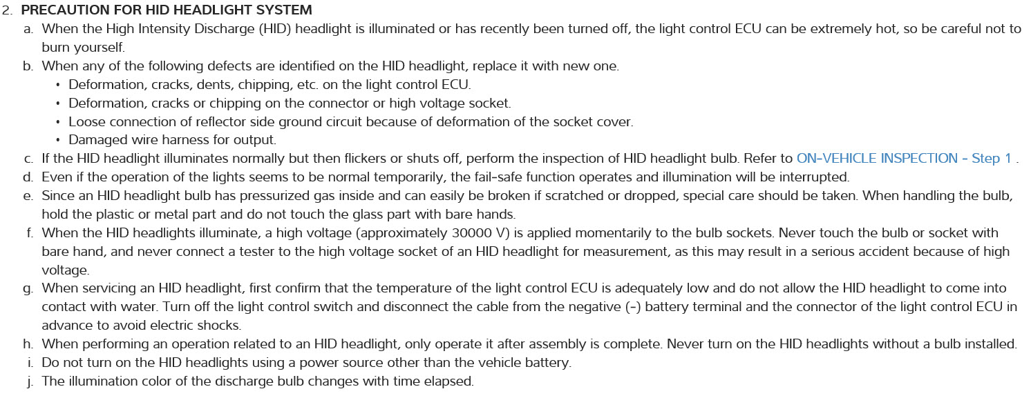

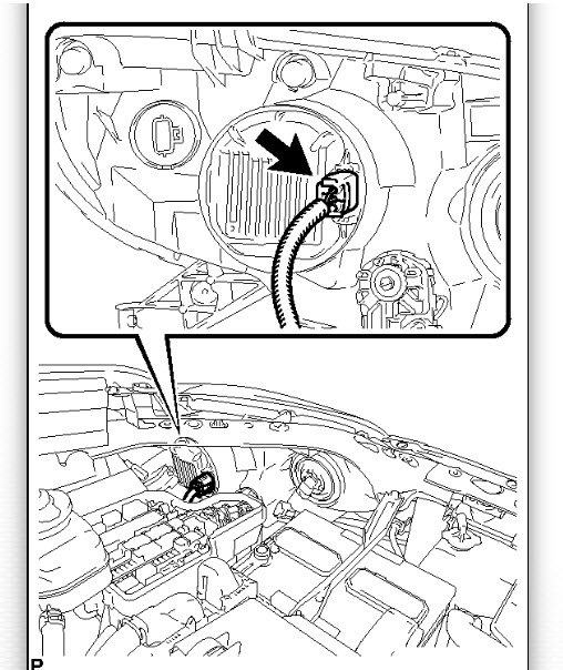

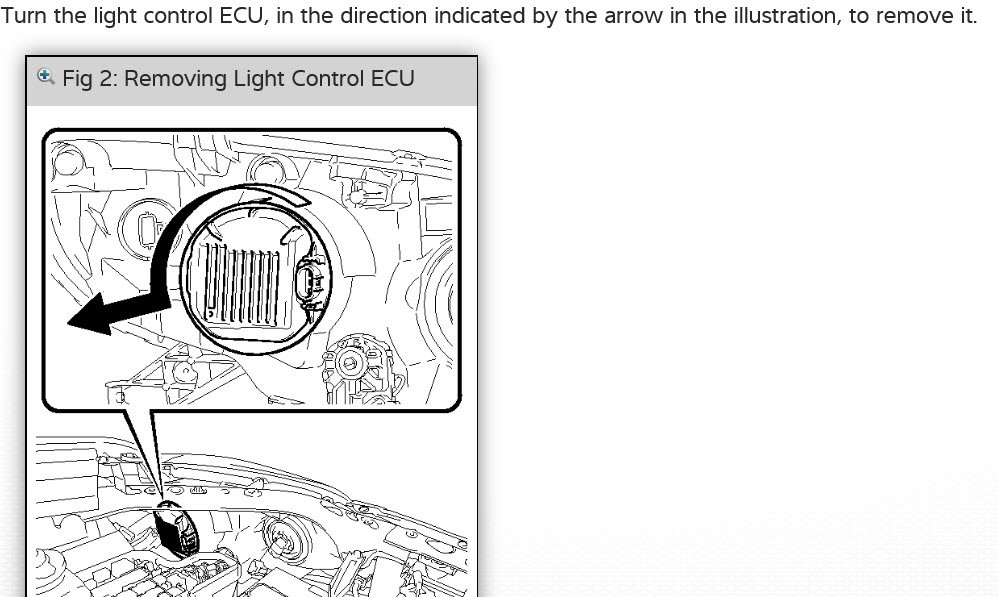

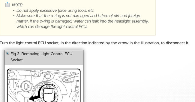

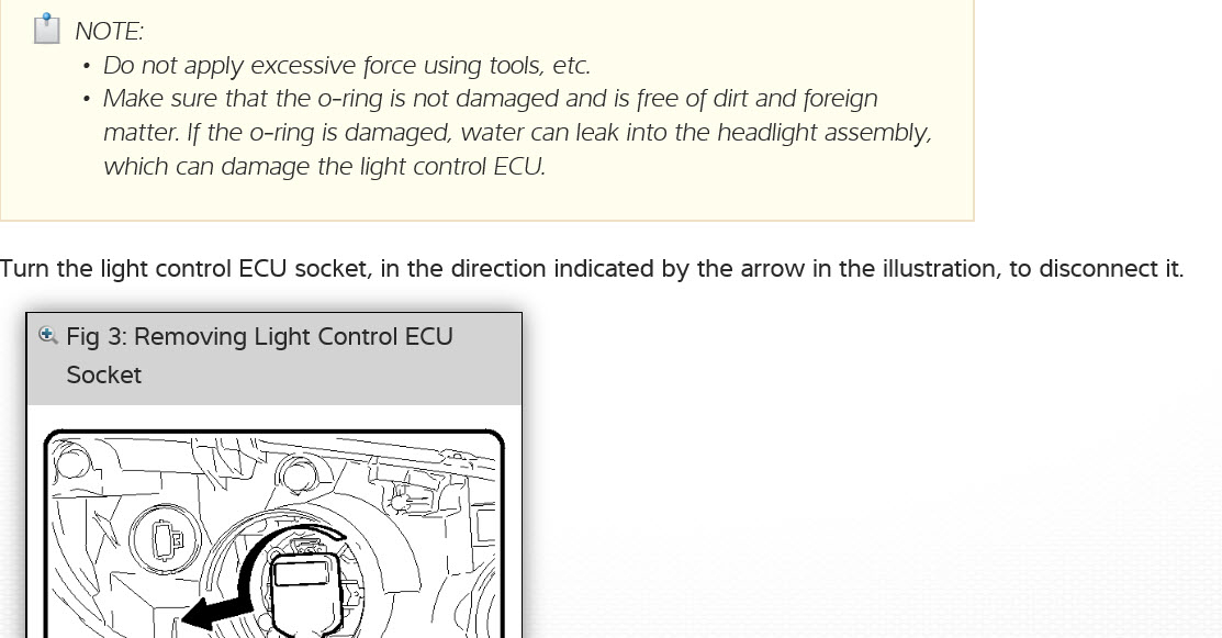

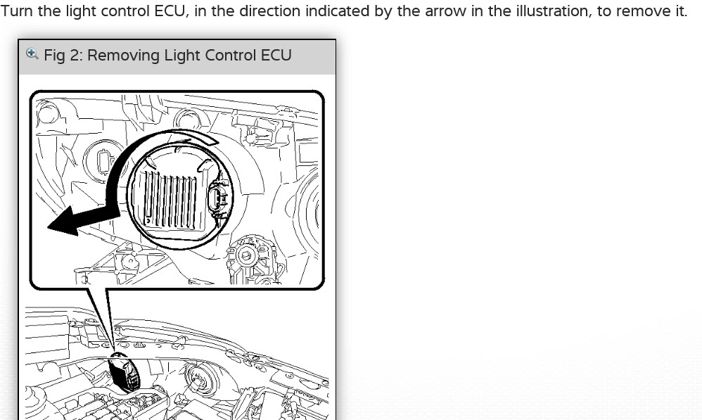

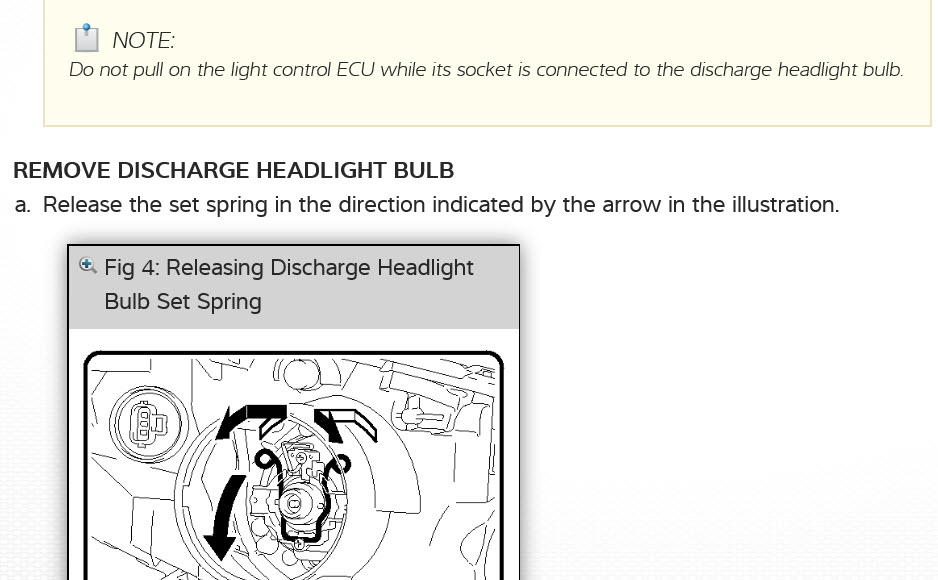

How do i remove the HID bulb on the passenger side headlamp?
Dec 29, 2015 at 7:40 AM
HMAC300
Experienced Mechanic
48,601 POSTS
please read precaustion first.... first pic. see other pics.
