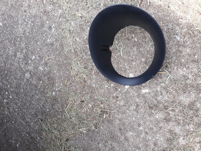

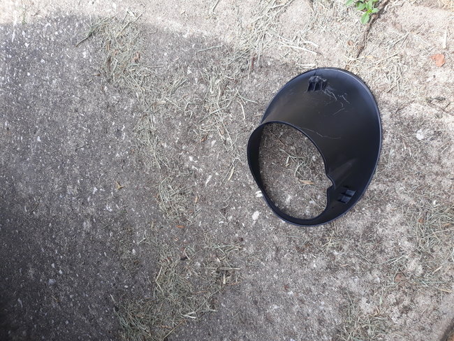

Having trouble fitting fog light dimel into place on my truck listed above 1500 slt truck.

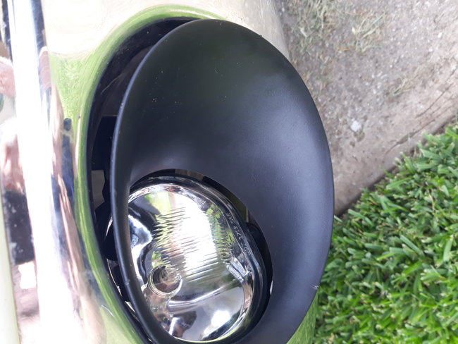

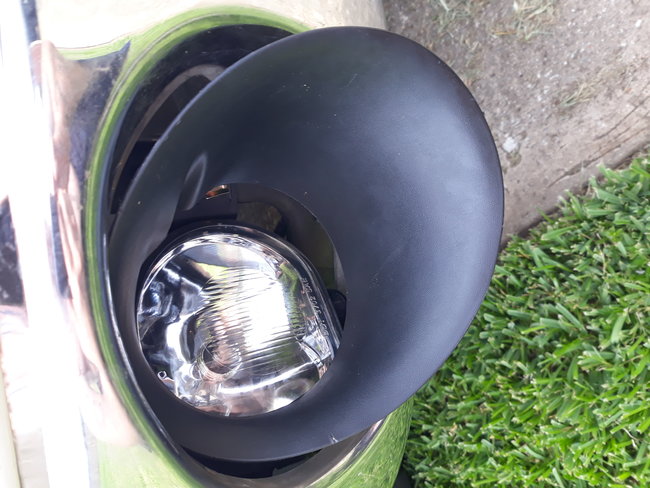

I am sending pictures of the part and where it is supposed to be fitted into the chrome steel bumper where I can't seem to fit it in because it keeps popping out of place where it will not stay fitted inside fog light hole inside the truck's front bumper.

So your trying to put a cover on, the fog light probably need to be adjusted back to have it fit or is there no fog light and your just fitting a cover to block it? Can you send a pic of the hole and the cover your trying to install?

I think I understand a little better. Where did you buy these if you don't mind me asking? Tom raises a good point but if these are the same that I have seen installed before, the fog light needs to be removed and then the cover is put in and the bulb actually holds them in. Most then likely you may have to trim them to fit snug because the ones I have seen, the bulb would not go back in until the smaller end of the cover was trimmed.

I finally fixed the problem by finding a fog light cover from another same model truck at the auto salvage by pulling out the same passenger side fog light cover out of the salvaged truck, then fitting it into the bumper of my truck and it fit. also so after doing some research I learned that there are different fog light covers for different year model bumpers and the prongs on the fog light cover need to match the same year model bumper bezel hole . There are part numbers for each fog light bezel cover so you have to make sure you order the right bezel to match the right bumper hole or make a trip to the salvage yard like I did to find the matching bezel for your year model truck .
