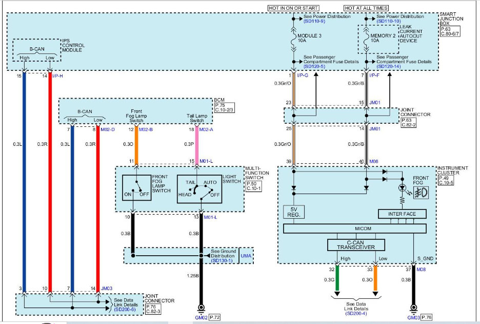

I replaced the fog light bulb and the light still does not work.
Aug 30, 2022 at 6:19 AM
  • 110,244 POSTS
I looked at the wiring schematics and noted that there are a few different modules that communicate via what is called the can-bus which may be the issue. However, let's start easy.

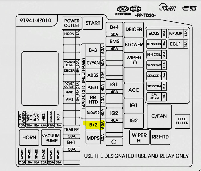

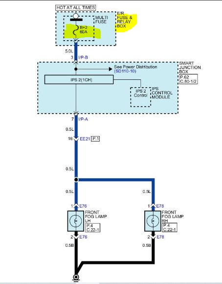

If you look at pic 1, you will see different modules. Pic 2 shows the power supply for the fog lights. Start there. See if the fuse is good. In addition to checking the fuse, confirm there is power to and from it.
Pic 3 shows the fuse location.
Let me know if this helps or if you have other questions. Also, let me know if both bulbs failed at the same time.
