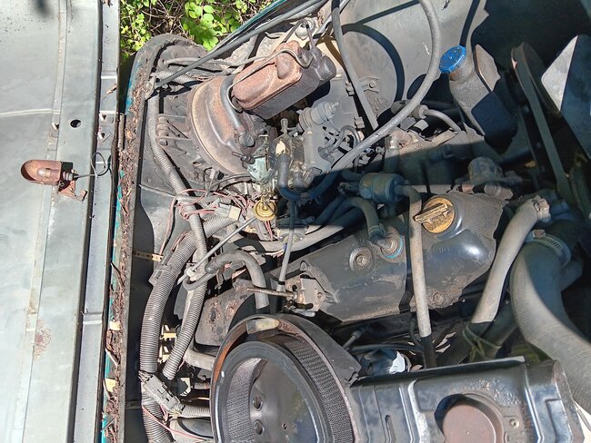

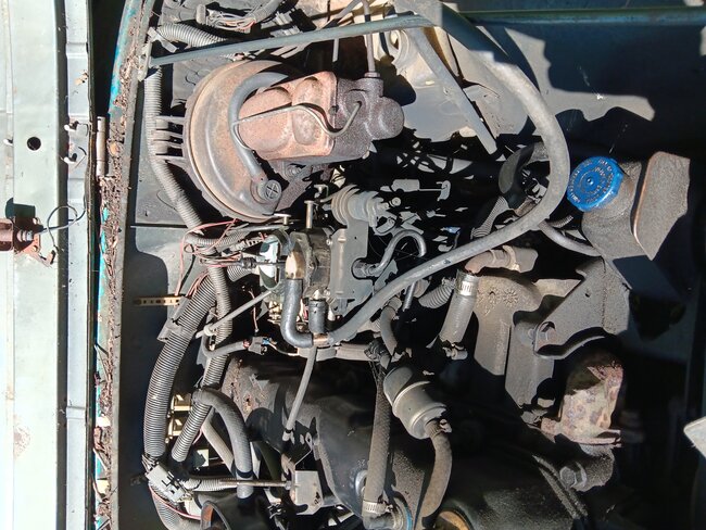

I've been working on this vehicle for a few weeks now and can't figure it out. It will run for a while then it will flood while just sitting there idling, I've gone through the vacuum lines and capped off anything unnecessary. I've replaced the cap and rotor but still nothing. It runs and idles great but after about 10 to 20 minutes it floods.
Update: Just got it started again and it's now running like an old tractor. You can't let off the gas or it'll just stall.

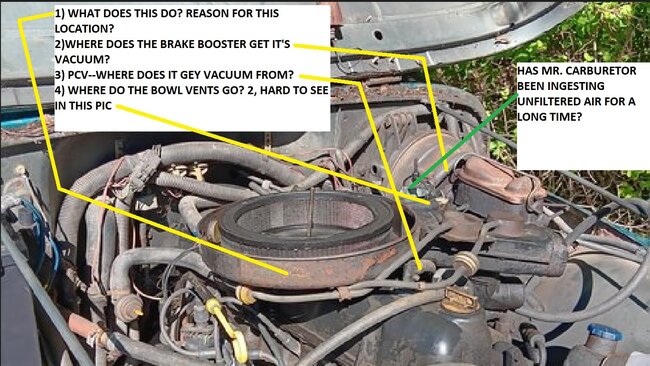

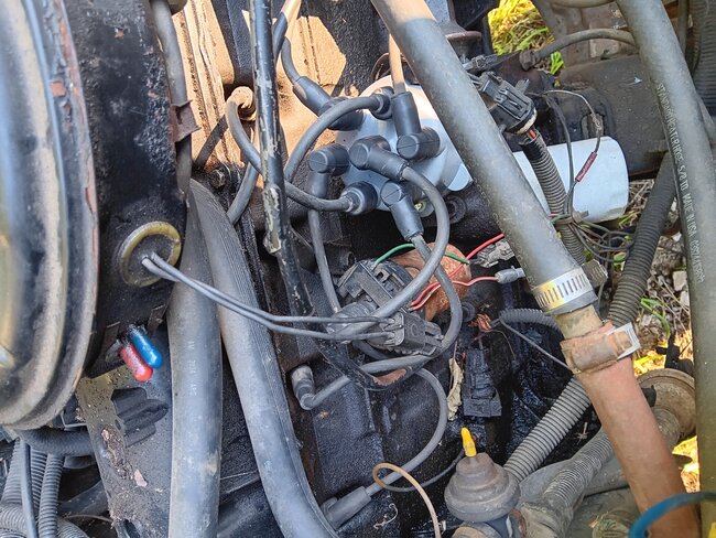

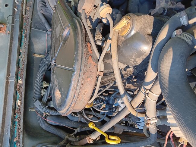

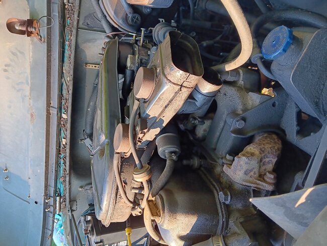

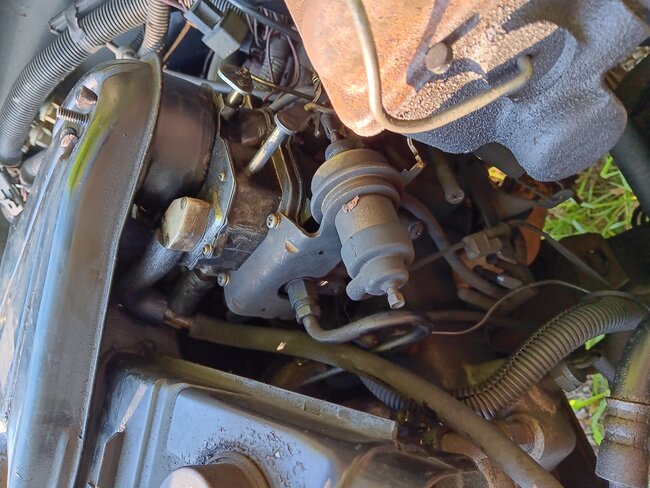

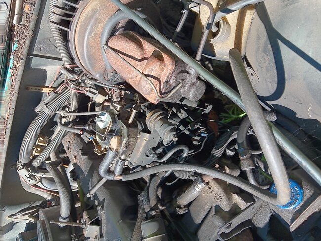

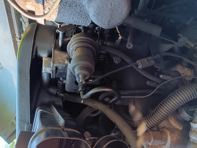

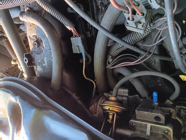

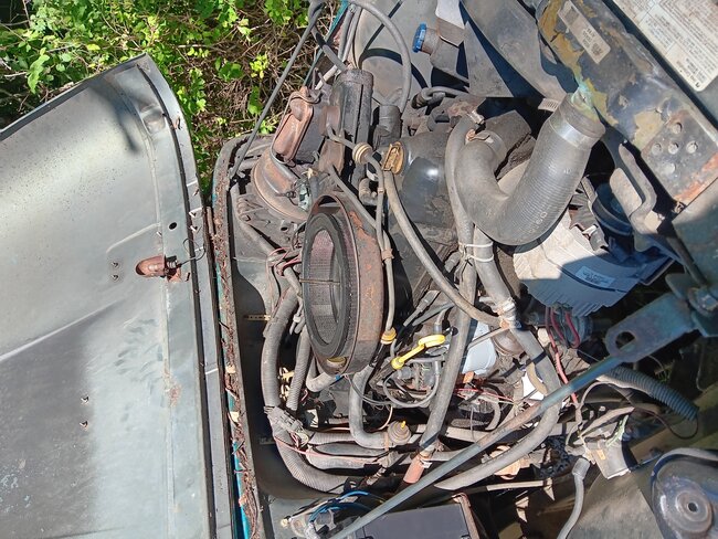

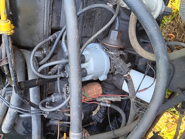

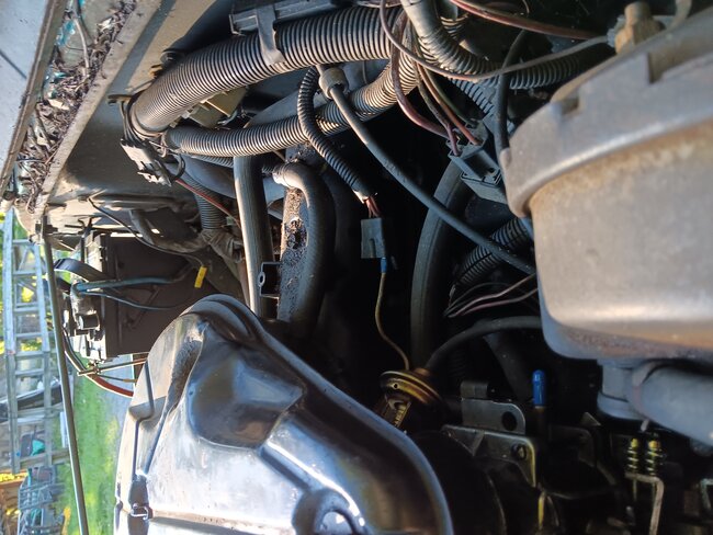

Here's the photos:
Sep 1, 2023 at 1:02 PM
CJ MEDEVAC
  • 11,004 POSTS
It's not always a fast fix---but we try the best we can!
Some Jeep threads I've answered on here are over 100 posts long!
Maybe some more closer (not too close) pics around the
carburetor, intake manifold
(vacuum lines)
and maybe some around the distributor.
Do you have tools/ meters/ etc that you can use to correctly tune
your Jeep? Timing light/ dwell-tach/ vacuum gauge?
Do you know how to use them?

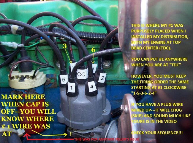

I have a couple of pics for you.
----The Medic
