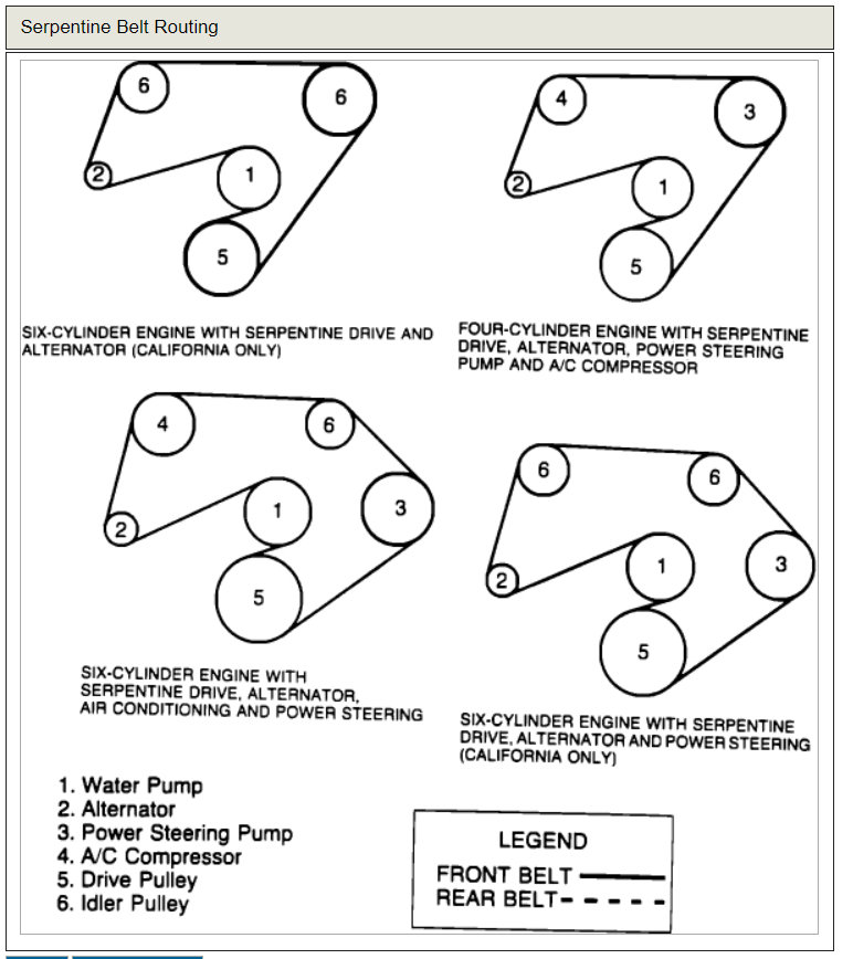

How do I adjust the serpentine belt on my CJ7?

The belt adjustment is done by the alternator slider. Here is a diagram to show you how the belt goes and you can see the small pulley which is the alternator.
