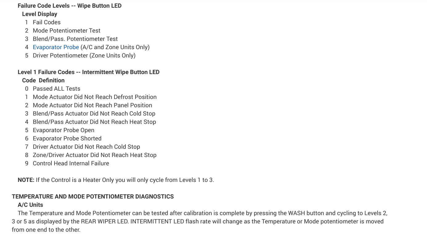

The battery got discharged because the engine hood was not properly closed so the engine compartment light bulb was on overnight.
I successfully recharged the battery using my other car battery via jumper cable. The only problem is the A/C switch light and the Air Flow Vent beside it keep flashing.
I turned the engine off and on multiple times hoping that it will work but to no avail.
Please advise.

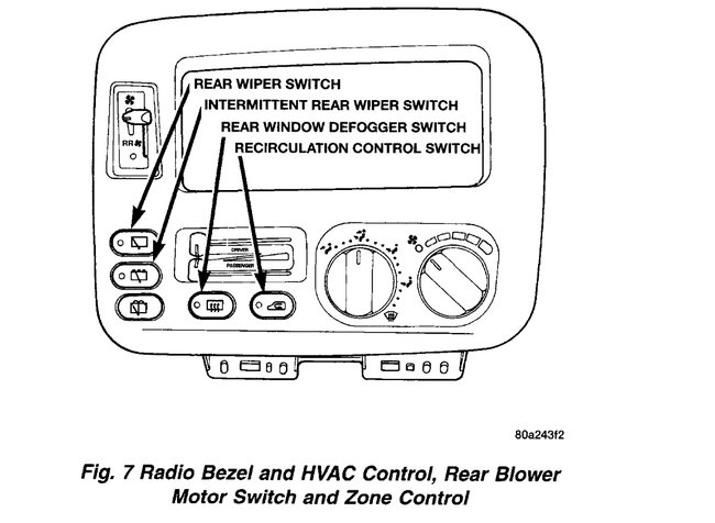

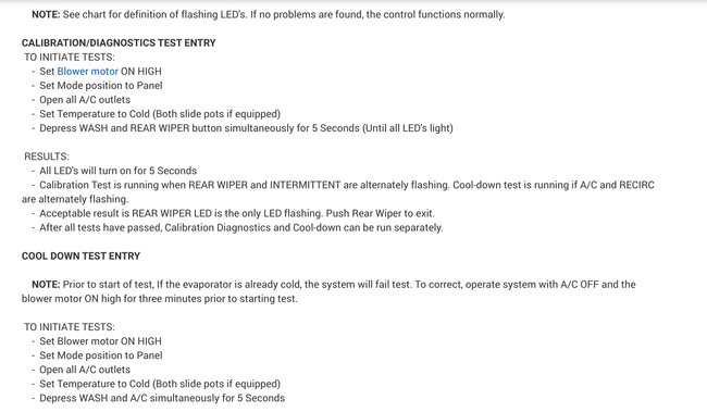

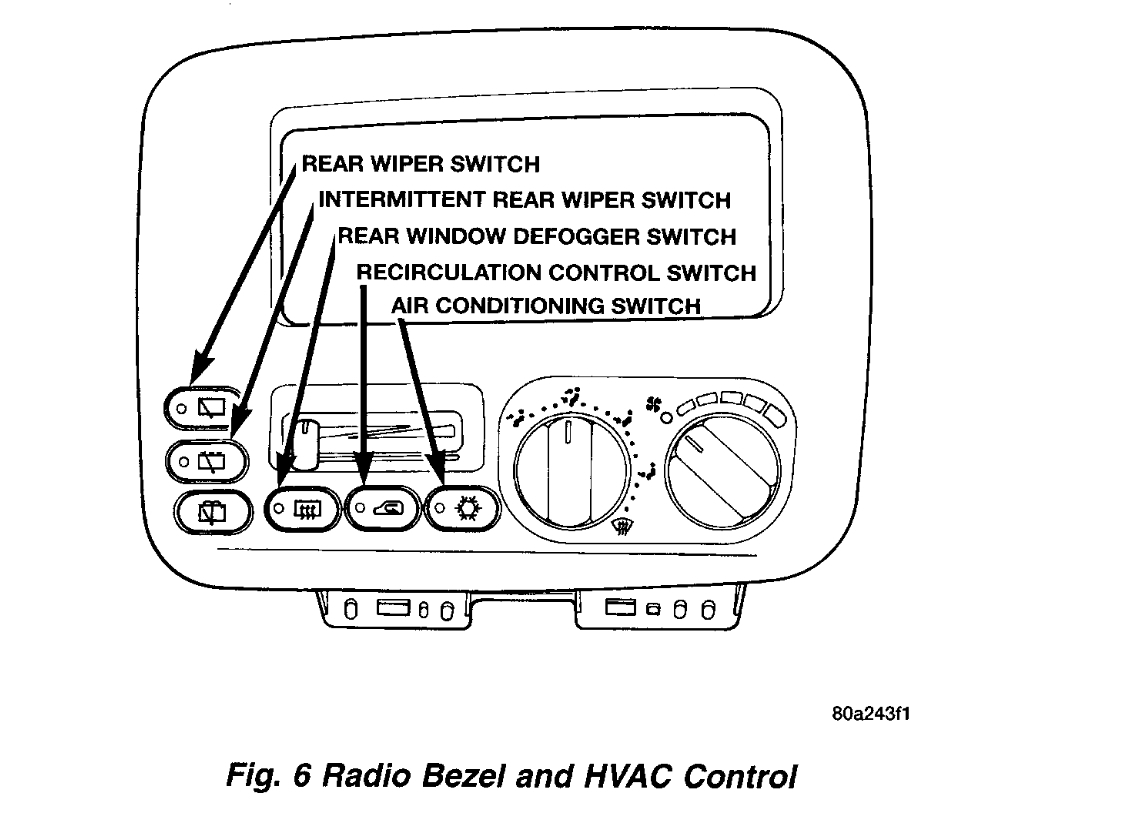

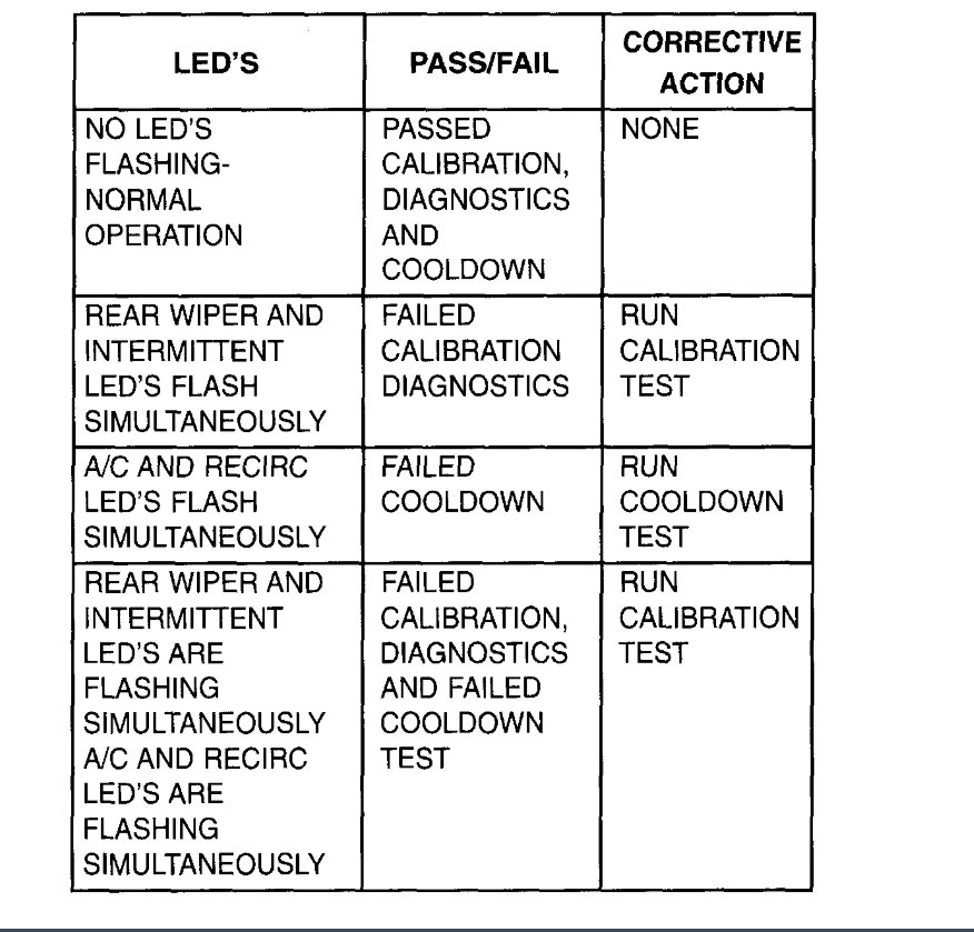

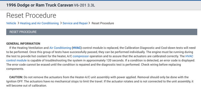

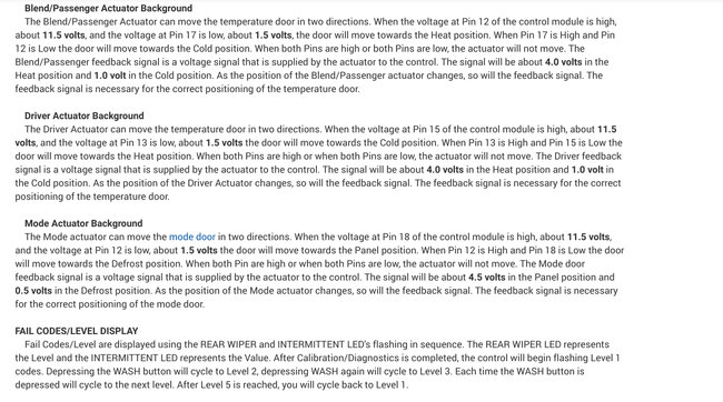

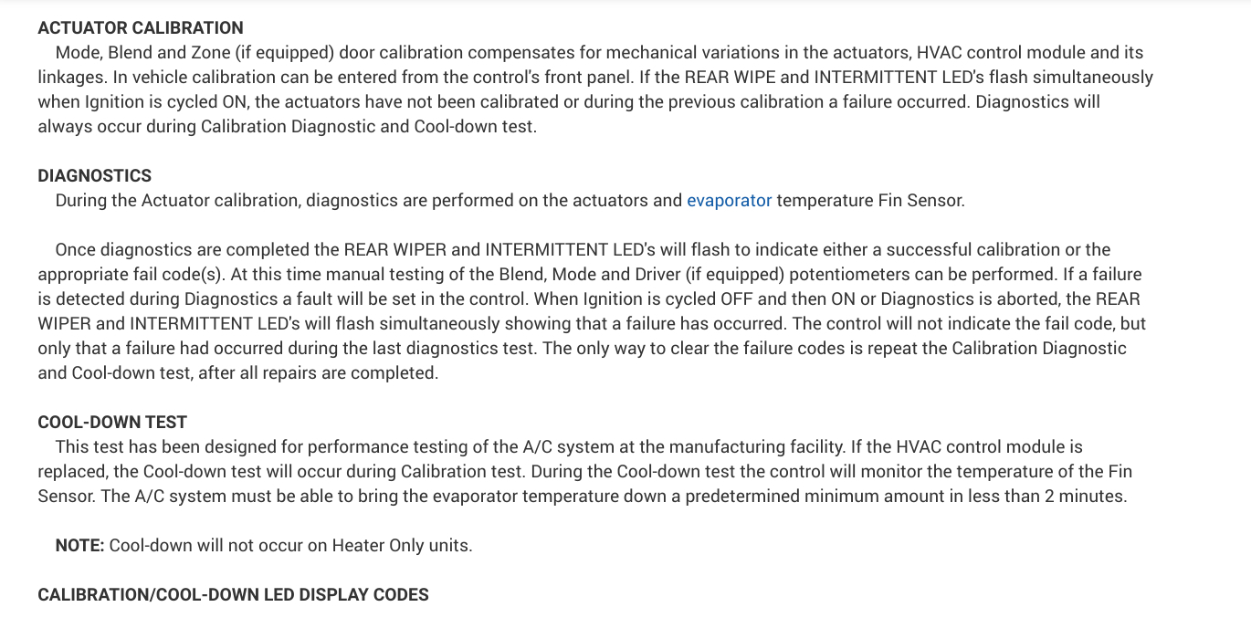

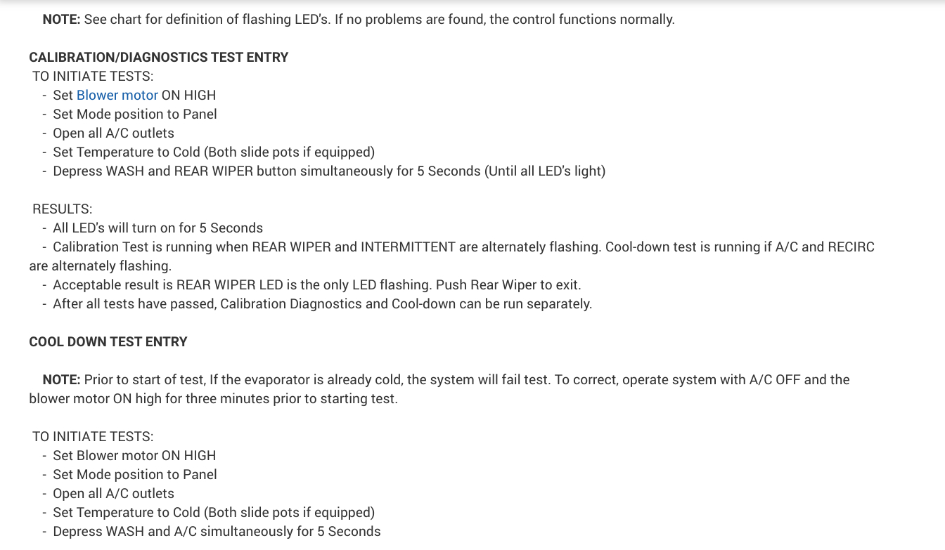

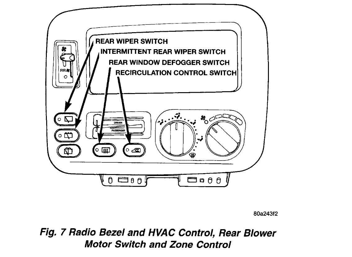

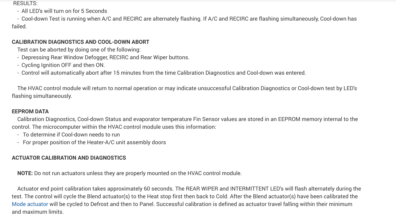

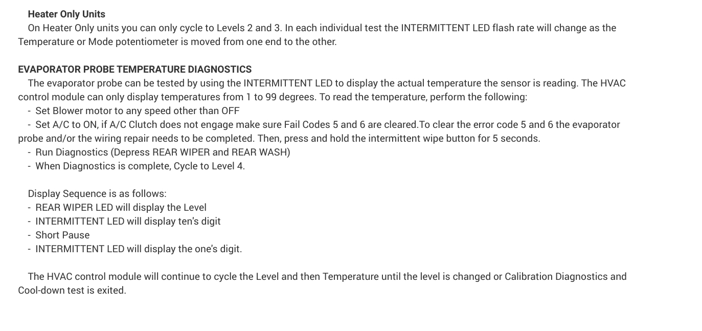

This sounds like you might have to run a reset procedure on your vehicle's Heating Ventilation and Air Conditioning[HVAC] system. In the diagrams down below I have included the instructions from the vehicle manufacturer for the reset procedures for your vehicle's HVAC system. Please go through this guide and report back with how everything turns out.

Hello Alex,
I did the tests but was not successful.
After the calibration/diagnostic test, the rear wiper and intermittent lights flash alternately, and with the cool down test, the recirculation and A/C lights continue to flash simultaneously after the test.

Please allow me to butt in and add a few comments of value. I used to have to do this at the dealership, and the cool down test can be rather frustrating. My record is 20 attempts. To add to the frustration, there's a good chance the cool down test won't pass if you follow the service manual procedure exactly.
The mode door calibration test passes very easily, but the cool down test requires the AC system to be operational. If, for example, you don't want to repair a leak in the system, this test will never pass.
The manual tells you to start with the temperature set to "Cold". To pass the test, the computer wants to see an 80 degree drop in temperature within 20 seconds. How is that supposed to happen when it's already cold? Instead, run the system with the heater set to ""Hot" and with the AC system running. The AC turns on any time the system is set to "defrost". As soon as you press the two switches to start the cool down test, move the temperature control to full "Cold". The calibration should complete after 20 seconds.
