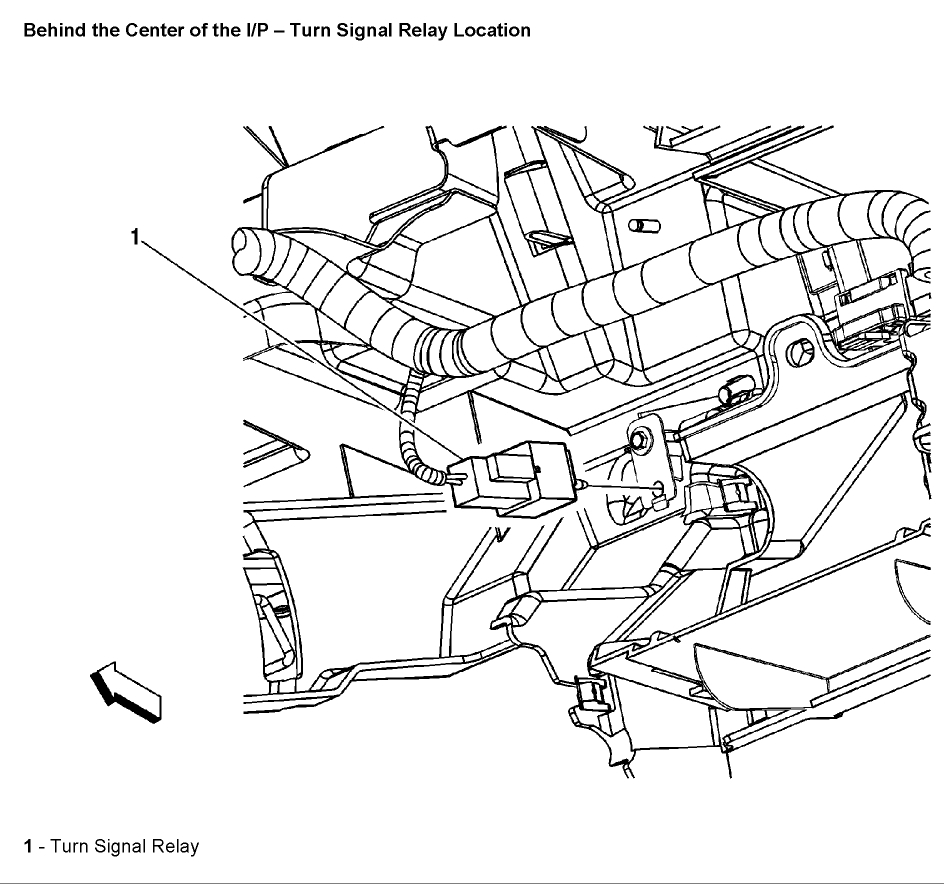

All my flashers and hazard lights are not working. all fuses are good. what do I check next?

Try turning the hazard switch on/off a few times, if nothing happens the turn relay/flasher has failed. It is behind the stereo in the dash. You remove the entire trim section by gently prying it up starting at the bottom, it is clipped in. Then disconnect the electrical connections. Now remove the radio screws and pull the radio out. I have usually been able to reach in and changes the relay without disconnecting the radio.
