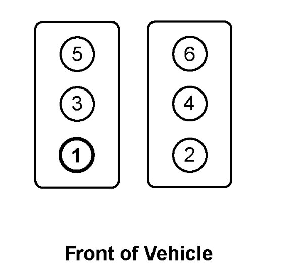

Can I get the firing order diagram?
2015 GMC CANYON
120,000 MILES • 3.6L • V6 • AUTOMATIC
DIRT POOR
  • 25 POSTS

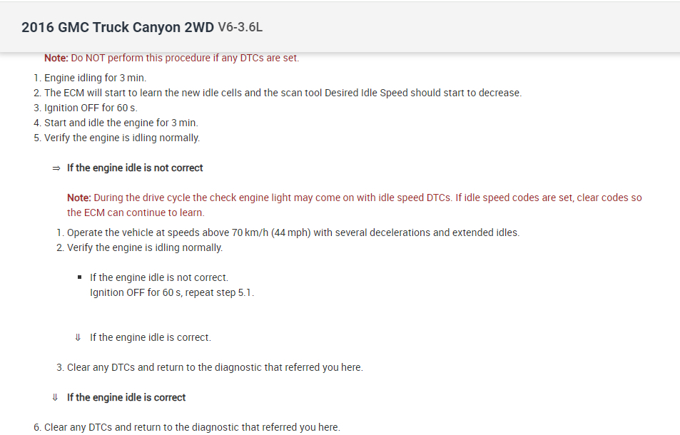

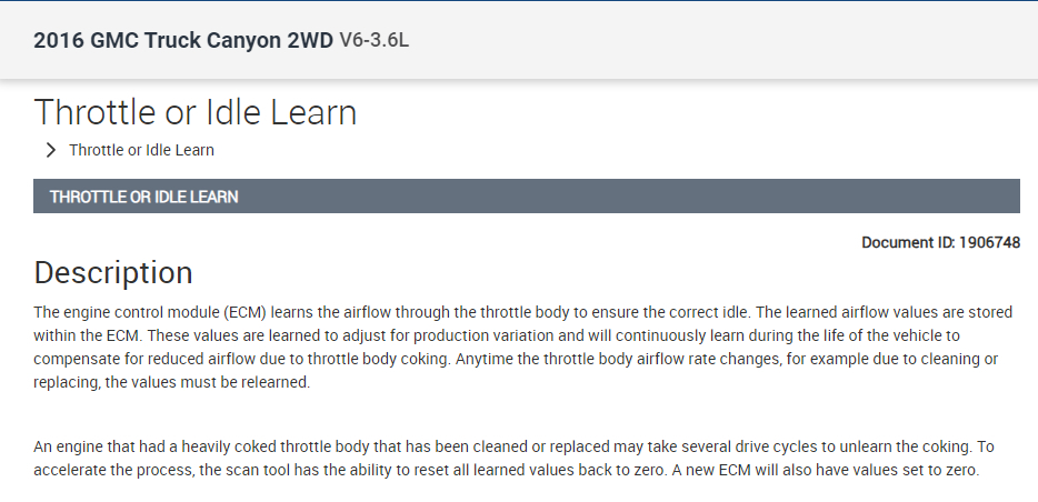

I need a firing order diagram and throttle body relearn procedure without a scanner.
Feb 17, 2024 at 4:51 AM
  • 110,244 POSTS
The cylinders are arranged in 2 banks of 3 with a 60-degree included angle. The right bank of cylinders are number 1-3-5 and the left bank of cylinders are 2-4-6, viewed from the flywheel end of the engine. The engine firing order is 1-2-3-4-5-6. (see pic below)

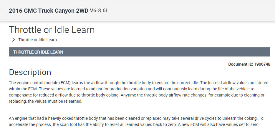

As far as the relearn, the remaining pics explain how that is done.
Take a look through this info and let me know if that is what you need or if you have other questions
joe
see pics below.
