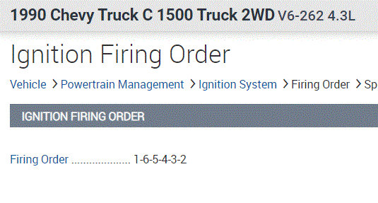

won't start and keeps backfiring.
Apr 7, 2021 at 7:42 PM
  • 110,194 POSTS

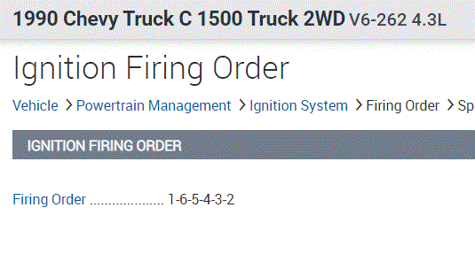

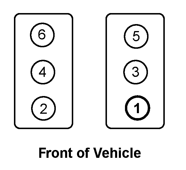

If you look at pics 1 and 2, they provide the firing order and cylinder location (cylinder 1).
If the spark plug wires were not removed, the firing order shouldn't have changed. Take a look through this link. It discusses the most common causes of a backfire.

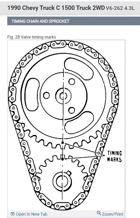

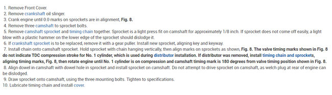

As far as the timing chain replacement, pics 3 and 4 provide the directions and show where the marks on the sprockets should be.
