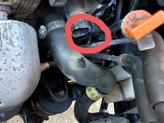

The picture below is what had happened. As you can see, the hose came loose. First, what would it had caused it to come loose and secondly, the highlighted area, is that the radiator housing and should I replace that?

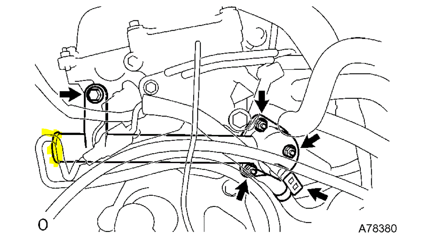

Don't laugh, but I need to see under the red circle at the top. It looks like something has broken.
If you look at the attached pic, there should be like a barbed end on the connection which prevents the hose from coming off because the clamp can't fit over it when tightened. From what I see, it appears to have broken. Is a part of the connection still in the radiator?
See pic below / the highlighted portion is what appears to be missing.

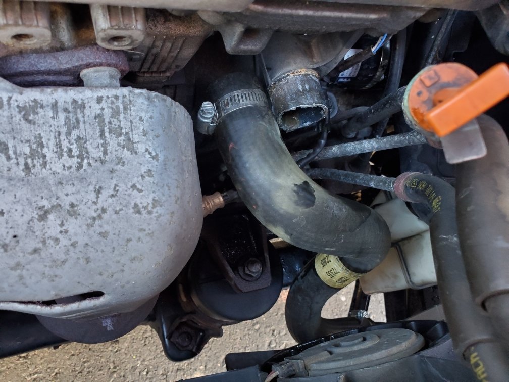

Here is the picture without the red highlight. Can I purchase that piece separately or do I need to replace the whole thermostat housing? Now. how do you think that piece broke off? And what is the name for the thermostat housing?

Yep, you can replace it. And you nailed it. It is simply called a thermostat housing.
As far as breaking, it is really odd that it did, but it's plastic so anything is possible. Is the broken part still inside the hose?

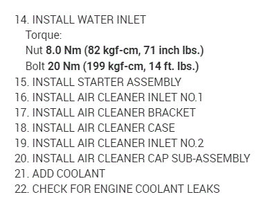

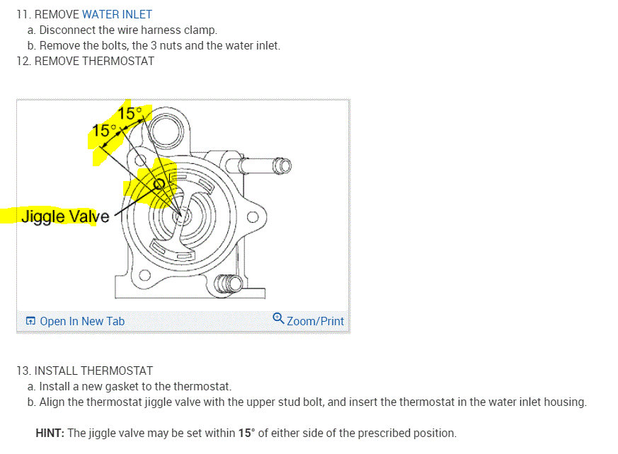

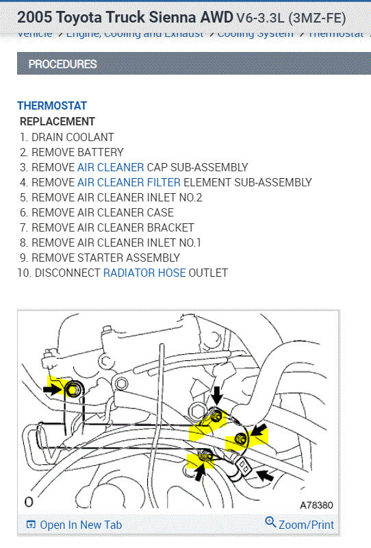

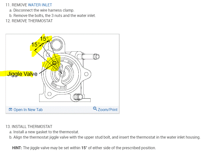

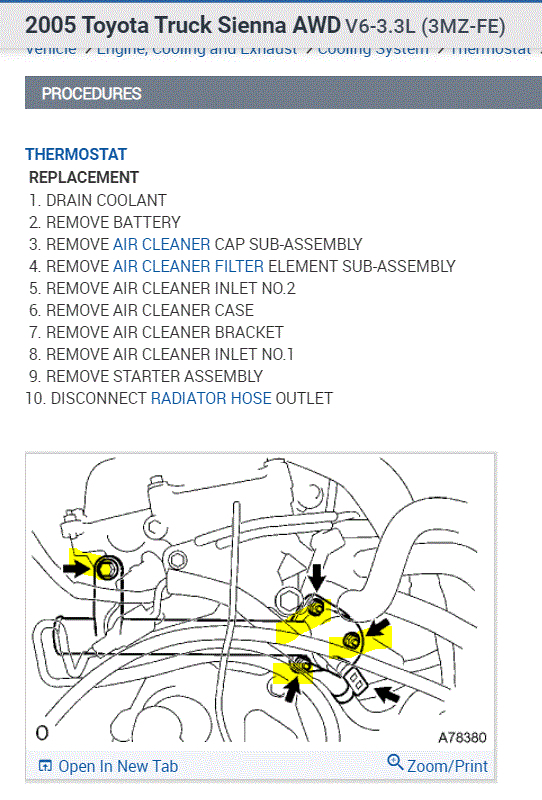

I attached the directions for replacing it below. If you look at pics 1 and 2, I highlighted points of interest. In pic 1, I highlighted the bolts holding it in place. Note: There is also an electrical connection that will need unplugged. In pic 2, I highlighted what is called a jiggle valve. That is on the thermostat itself (which I would replace at this point). Make sure that is positioned correctly. It allows air to exit the cooling system while refilling the coolant. If you point it directly down (6 o'clock) it will be very hard to bleed the system.
The worst part about this job is the starter needs to be removed. Make sure the negative battery terminal is disconnected before working on the starter.
Now, the housing won't be hard to find. It should be under 30.00 dollars. Make sure when reinstalling it to replace the thermostat gasket, which should come with the housing.
As far as aftermarket parts, I found that Dorman makes them for this vehicle. It is part number 902-5123. Chances are the dealership will no longer provide them because of the model year. Plus, it would be 3 times the cost. LOL
Please understand that I and this site has nothing to do with Dorman. I'm just suggesting it because I have always had luck with their parts. Also, most all parts stores will offer them. On the other hand, I don't suggest getting a really inexpensive one online. Often times they are too thick and brittle, and you'll end up with the same issues.
I'm here to help if you need me. Let me know if you run into trouble. Also, make sure to get a universal type of coolant when you refill the system. That way there won't be any issues.
Let me know how things turn out for you or if you have questions.
