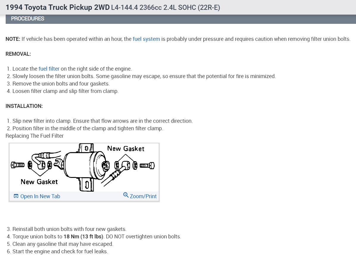

So, these codes are for lean mixture and engine knocking, can I ask how the engine sounds when it is running? The fuel filter on these clogs up so I would start with the filters, also can you upload a video of the engine running? If the engine is worn and has an issue such as timing chain guides or piston noise the knock code will not go away. Please let me know. Check out the diagrams (below). Please let us know what happens. The Fuel Filter is Located at the right side of the engine above the starter motor.

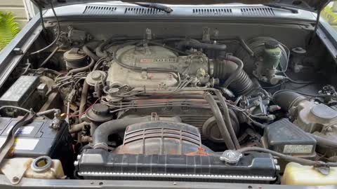

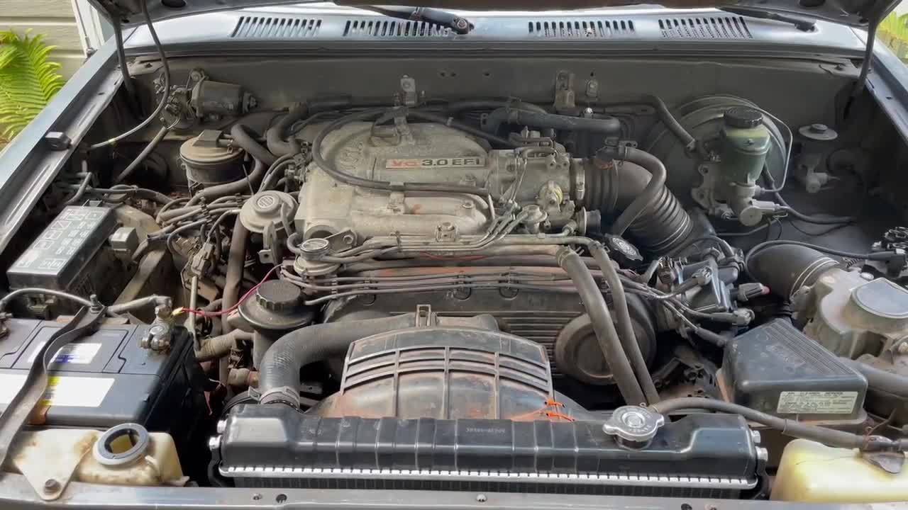

I’ve had this truck for 20 years and it has always ticked when running. Filters are on their way, so I’ll get back to you ASAP. Thanks!
Aug 16, 2022 at 6:16 AM
  • 55,214 POSTS
Thanks for the video, I don't think the engine noise is an issue. It sounds more like an exhaust leak. Also check your MA sensor to see if the flow door moves freely. Let me know after you replace the fuel filter, that should help.

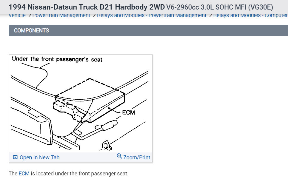

  • 55,214 POSTS
Sorry the ECM (engine control module) Check out the images (below). Please let us know what happens.

  • 55,214 POSTS
Yep, it sounds like the ECM is out, I would try replacing it to fix the problem.
