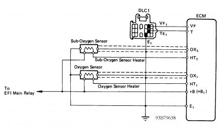

1994 Toyota Pickup 4 cyl Manual 225,00 miles
Check engine light on trouble code 27, replaced front o2 sensor, rear was replaced about 5 years ago, after replacing front sensor I now have 2 codes , 21 and 27; 21 = main oxygen sensor fault, 27 = sub- oxygen sensor signal or heater circuit fault. Would replacing rear sensor fix the problem ? or do I need to do something else....?

Are you using OEM O2s or after market?

The 1 front sensor that I replaced was a Walker oxygen sensor (aftermarket).

Did you have to cut wires and reconnect?

No the plug fit perfectly.

Several things can cause codes leak in air induction spark plugs injectors fuel pressure distributor wiring see schematic
https://images.2carpros.com/forum/automotive_pictures/198357_Graphic_610.jpg
