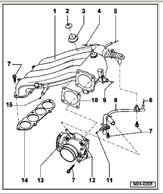

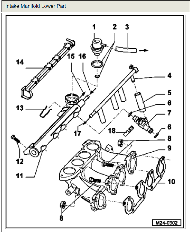

Car lost power and stopped. Coolant had drained. Fixed leak now car will not start. Says I have problem with fuel pressure regulator two control circuit. Can you help?

Okay good, I would say the fuel pressure regulator is having a problem but the wiring diagrams do not show a fuel pressure regulator?
It shows mechanical diagrams below. Is the stats on the car right? Year make model also diesel or euro car?
