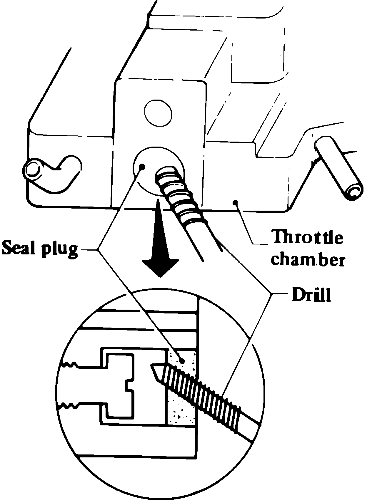

idle up too high. it runs pretty smooth when I drive it, but when push in on clutch idle goes through the roof and won't idle down. it idles high sort of when going down road have adjusted idle speed but hasn't helped.
Mar 14, 2021 at 6:37 AM
  • 110,244 POSTS

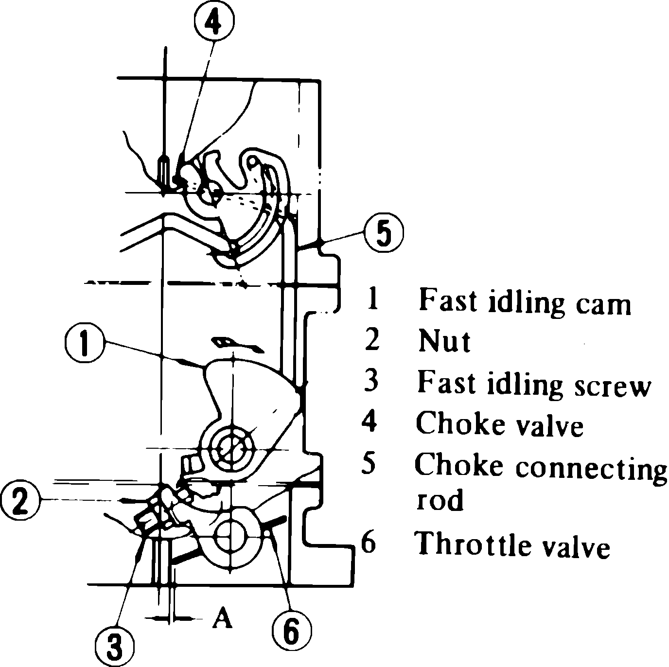

First, remove the throttle cable to make sure it isn't hanging up. Next, is there anything you can do to lower the idle speed? What screw on the carb was adjusted? Did you remove the concealment plug to access the air/fuel mixture screw? See pic 2
Here are directions for setting the fast idle. I'm adding this simply because I'm not sure what is happening yet. You can check it.

FAST IDLE SPEED (OFF-VEHICLE), ADJUST
Fig. 15 Fast idle adjustment.
see pic 1
1. Place fast idle screw on second step of fast idle cam.
2. Turn fast idle adjusting screw until dimension ``A,'' Fig. 15, is according to specifications.
