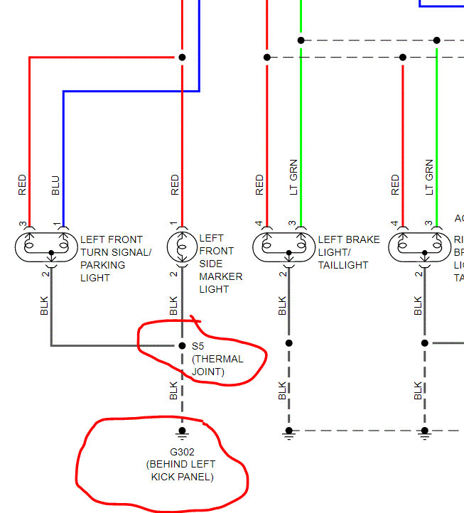

I replaced my headlight since that was the only thing broken when I got hit in the middle of the night while asleep. I would figured the problem would be fixed but my front left headlight that I replaced still doesn’t work Any suggestions?

It sounds like it could be a weak ground. Do me a favor, check the signal ground. It is behind the left kick panel in the vehicle. I attached two places to check.
Here are a couple links you may find helpful:

Hey, so I you were right i was the bad ground all fixed thank you.
