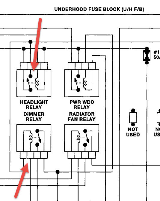

I have the wagon ex model. my lights will not go on, but the high beams will. low beams will not. I do not know what the problem is. my signal on the left side works fine on the right two blinks fast, ABS light is on too. change some relays nothing works. can you please help me? I am getting frustrated. thanks truly yours, Ottomann.
Jan 20, 2017 at 1:58 AM
HMAC300
  • 48,601 POSTS
check all your bulbs for the blinkers have a mechanic scan for codes for ABS to find problem check fuses and relays in picture under hood for headlights. although headlights ground through ABS unit so that may be problem as well or dimmer switch on column.
