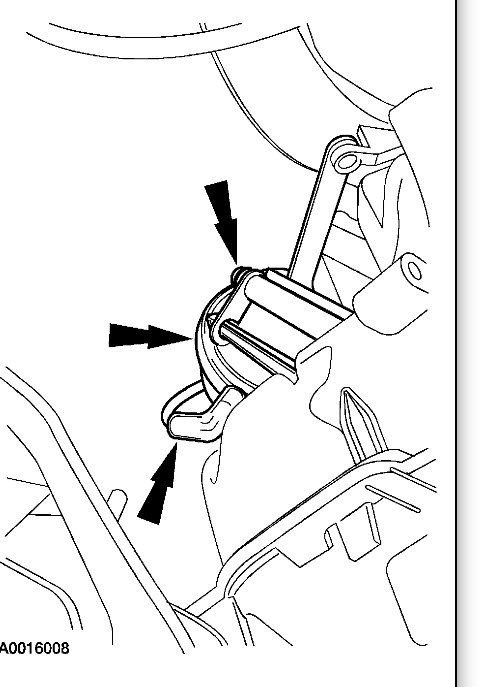

The actuator for the modes is the most common failure for this issue.
I attached a picture of the location and the procedure for you to follow. Most parts stores will carry the part.

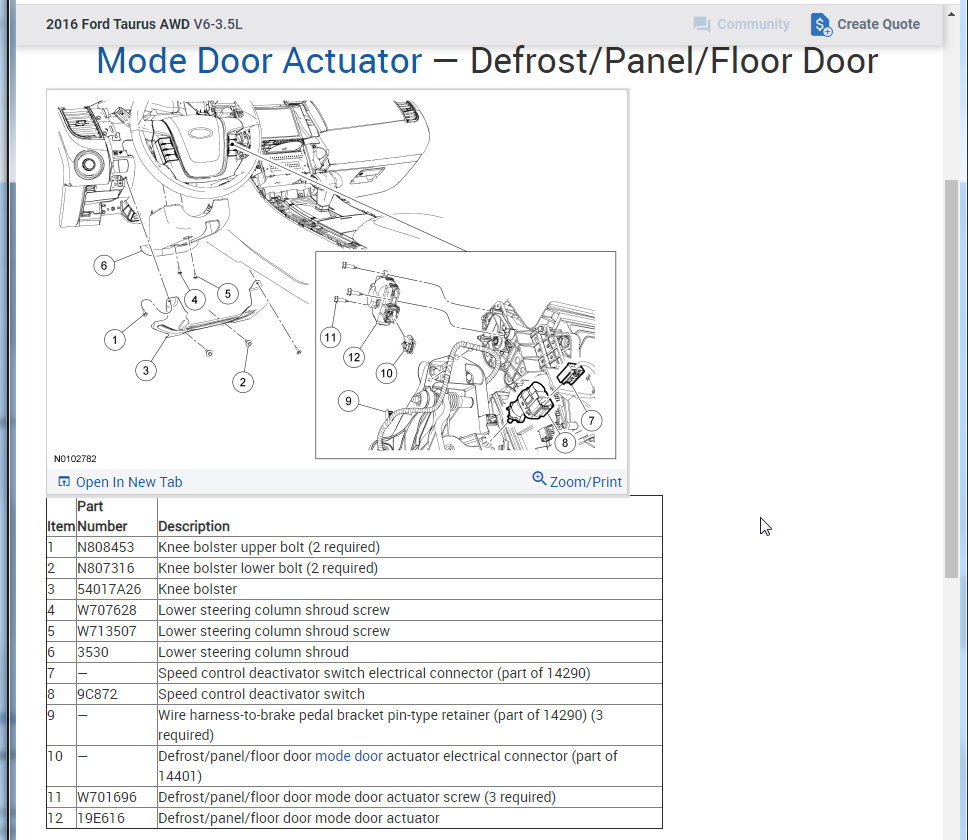

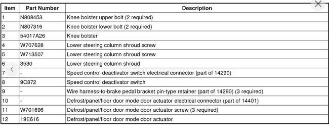

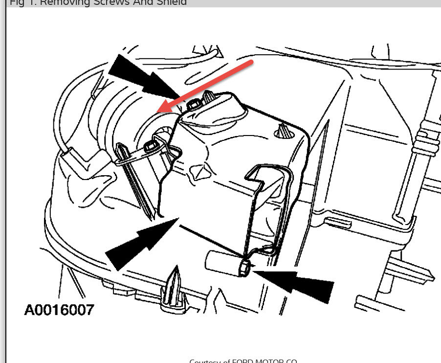

I believe you looked at the wrong actuator. The actuator in this case is called a mode door actuator and more centered behind the dash and closer to the driver's side. Take a look at picture 1. I circled the actuator in question. Is that the one you checked?
Here is a link that reviews and discusses this exact issue. Take a look through it.
https://www.2carpros.com/articles/air-vents-stay-in-the-defrost-position
___________________________

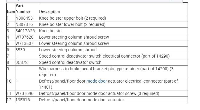

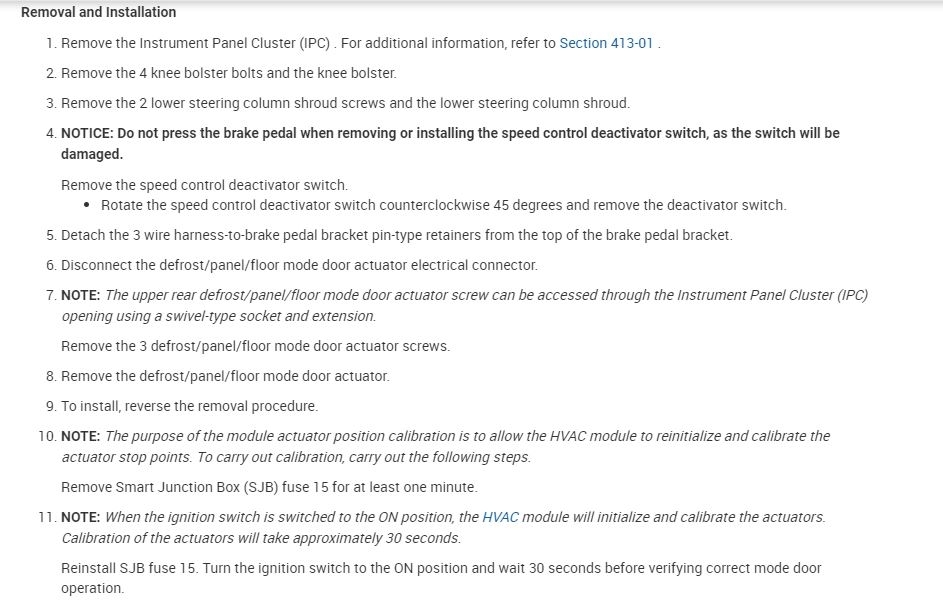

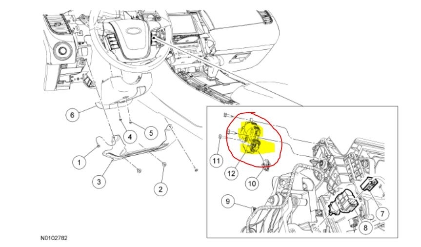

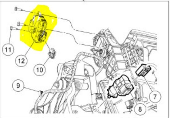

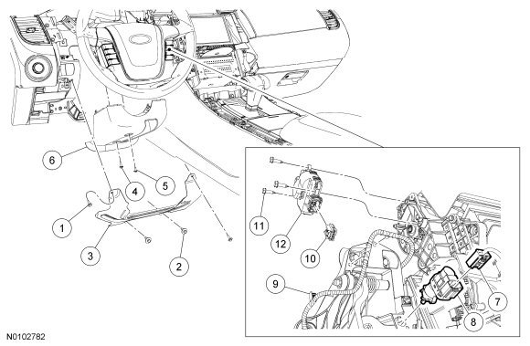

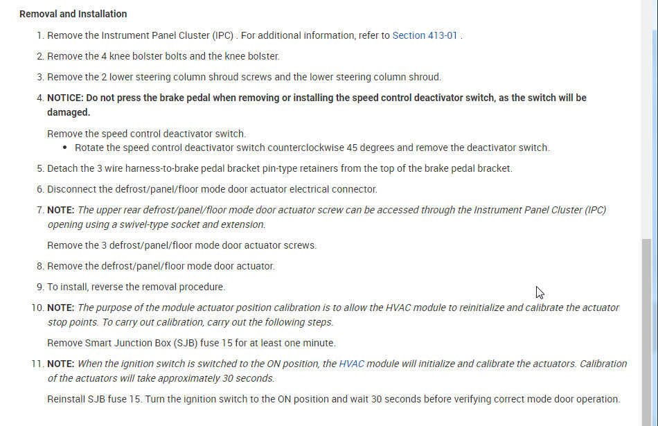

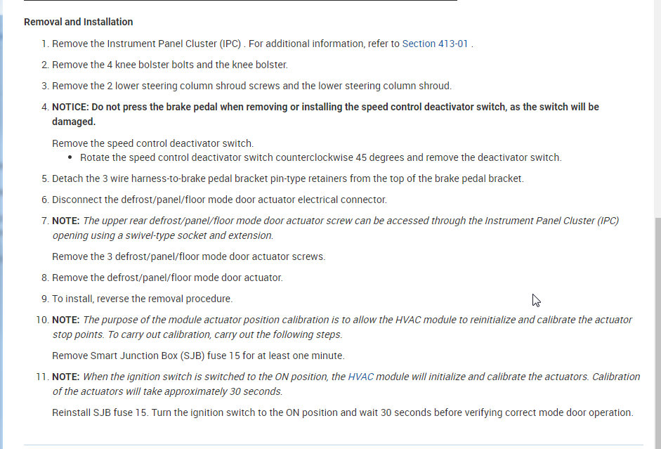

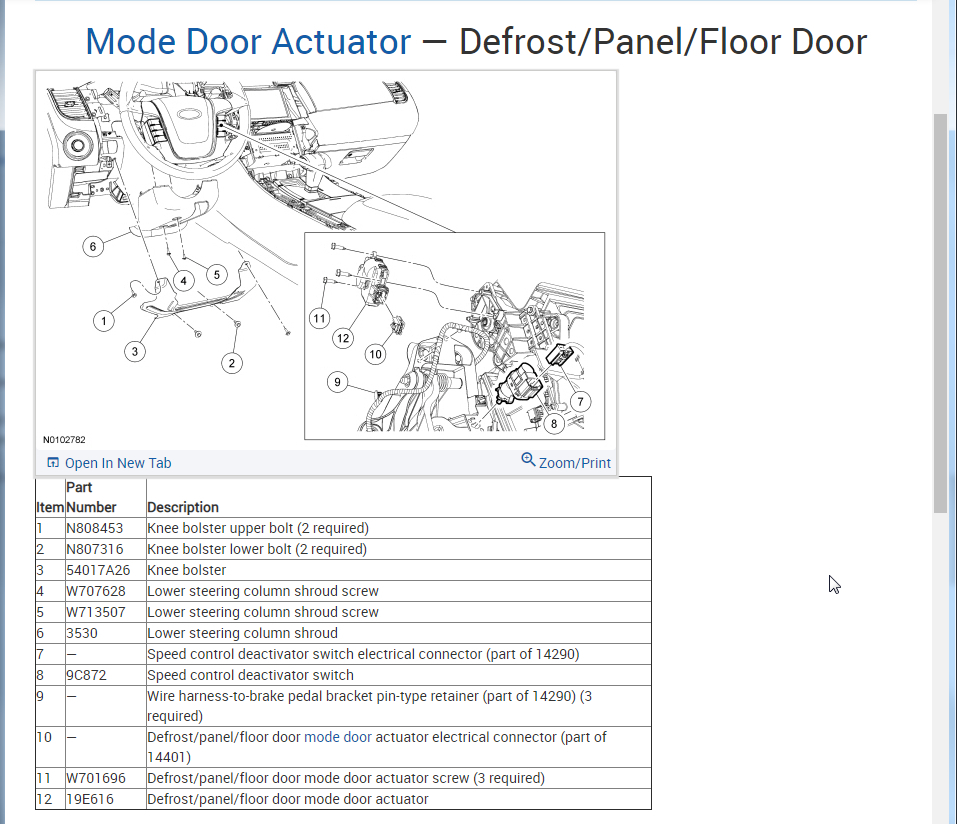

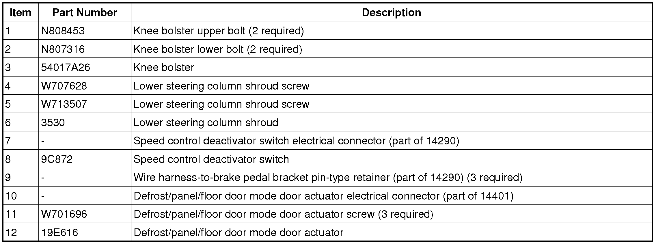

If it isn't the one you checked, here are the directions for replacing it. Pic 2 correlates with the directions.

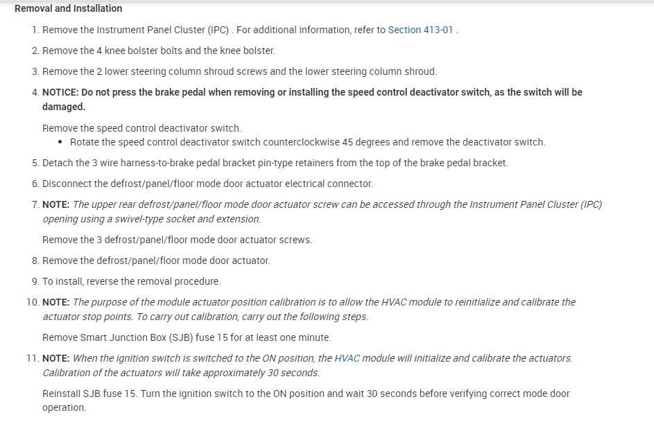

Removal and Installation
Remove the Instrument Panel Cluster (IPC) . For additional information, refer to Section 413-01 .
Remove the 4 knee bolster bolts and the knee bolster.
Remove the 2 lower steering column shroud screws and the lower steering column shroud.
NOTICE: Do not press the brake pedal when removing or installing the speed control deactivator switch, as the switch will be damaged.
Remove the speed control deactivator switch.
Rotate the speed control deactivator switch counterclockwise 45 degrees and remove the deactivator switch.
Detach the 3 wire harness-to-brake pedal bracket pin-type retainers from the top of the brake pedal bracket.
Disconnect the defrost/panel/floor mode door actuator electrical connector.
NOTE: The upper rear defrost/panel/floor mode door actuator screw can be accessed through the Instrument Panel Cluster (IPC) opening using a swivel-type socket and extension.
Remove the 3 defrost/panel/floor mode door actuator screws.
Remove the defrost/panel/floor mode door actuator.
To install, reverse the removal procedure.
NOTE: The purpose of the module actuator position calibration is to allow the HVAC module to reinitialize and calibrate the actuator stop points. To carry out calibration, carry out the following steps.
Remove Smart Junction Box (SJB) fuse 15 for at least one minute.
NOTE: When the ignition switch is switched to the ON position, the HVAC module will initialize and calibrate the actuators. Calibration of the actuators will take approximately 30 seconds.
Reinstall SJB fuse 15. Turn the ignition switch to the ON position and wait 30 seconds before verifying correct mode door operation.
Let me know if this helps or if you have other questions. I have a feeling that you were looking at the blend air door actuator behind the glove box.

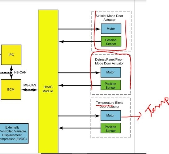

Are there any other actuators or just the 2? Is there an EATC self test diagnostic mode to enter? I know others with physical buttons are able to but mine are all touch. Thanks
Jun 22, 2021 at 3:59 AM (Merged)
  • 110,251 POSTS
I believe the one you changed is wrong. However, not being there makes it hard for me to determine. Now, there is no self test that I can find available for this vehicle. However, I am attaching the air distribution description and operation. It discusses the two different types, manual and automatic. Take a look through it and see if there is anything that helps. As far as mode door actuators, there is one for fresh air or recirculate and one for the air flow direction.

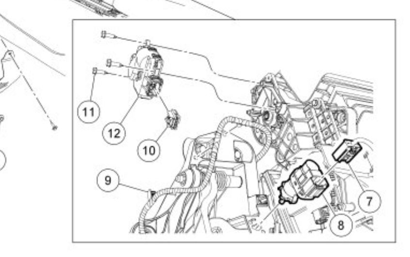

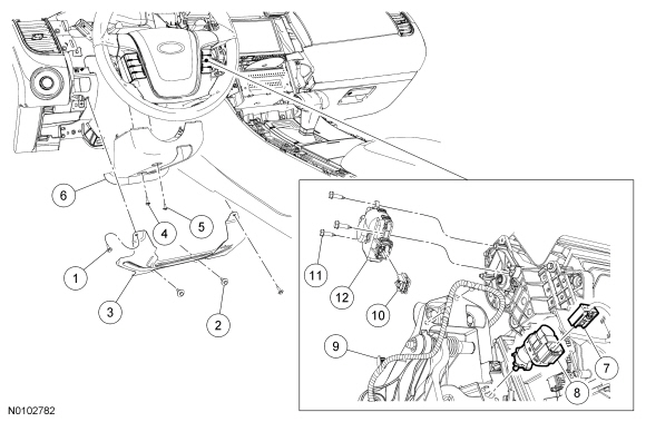

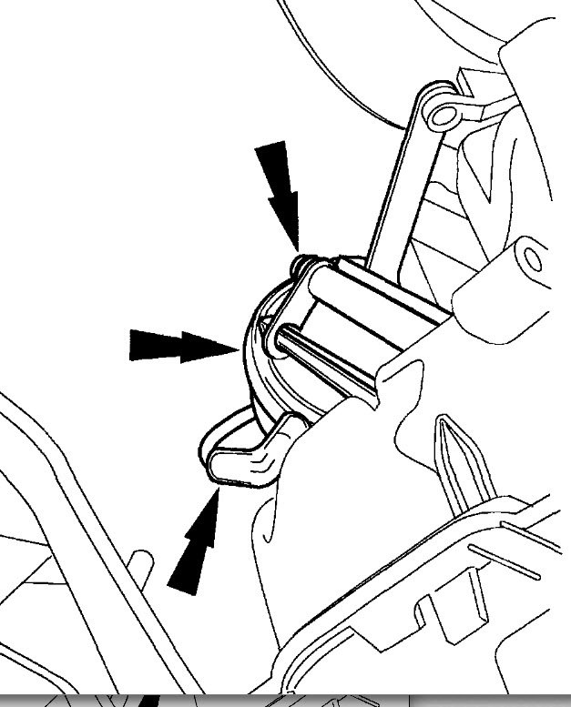

Take a look at the attached pic for mode doors.
Let me know what you find.
TIMEBREAKER101
  • 5 POSTS
I got the dash and IPC, but could not see anything that resembles that part, most of it is covered. Is it above-beside the steering column and more than likely needs the air vents etc. removed to get to it or is it below the air vents and shouldn’t need to remove them? The driver side temperature is lower to the ground. Thank you
  • 110,251 POSTS
Have you removed the knee bolsters? Also, it should be up higher on the HVAC box. I feel really bad, but the pic I attached above is the best I have. It should be on the steering column side and about the same height.

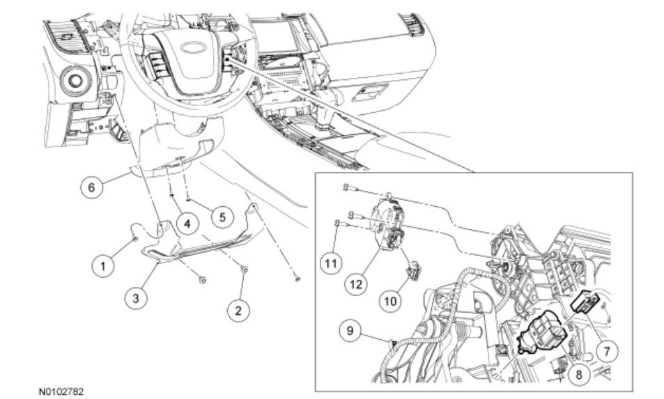

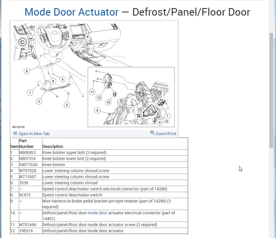

Here are the directions for replacement. It isn't the easiest job, but if you plan to do it yourself, if needed I will help you through it. The attached pictures correlate with the directions. In the last picture, picture 3, I highlighted the actuator.
MODE DOOR ACTUATOR - DEFROST/PANEL/FLOOR DOOR
Mode Door Actuator - Defrost/Panel/Floor Door
pic 1
pic 2
1. Remove the Instrument Panel Cluster (IPC). For additional information, Refer to 413-01 .
2. Remove the 4 knee bolster bolts and the knee bolster.
3. Remove the 2 lower steering column shroud screws and the lower steering column shroud.
4. NOTICE: Do not press the brake pedal when removing or installing the speed control deactivator switch, as the switch will be damaged.
- Rotate the speed control deactivator switch counterclockwise 45 degrees and remove the deactivator switch.
5. Detach the 3 wire harness-to-brake pedal bracket pin-type retainers from the top of the brake pedal bracket.
6. Disconnect the defrost/panel/floor mode door actuator electrical connector.
7. NOTE: The upper rear defrost/panel/floor mode door actuator screw can be accessed through the Instrument Panel Cluster (IPC) opening using a swivel-type socket and extension.
8. Remove the defrost/panel/floor mode door actuator.
9. To install, reverse the removal procedure.
10. NOTE: The purpose of the module actuator position calibration is to allow the HVAC module to reinitialize and calibrate the actuator stop points. To carry out calibration, carry out the following steps.
11. NOTE: When the ignition switch is switched to the ON position, the HVAC module will initialize and calibrate the actuators. Calibration of the actuators will take approximately 30 seconds.
Reinstall SJB (Smart Junction Box) fuse 15. Turn the ignition switch to the ON position and wait 30 seconds before verifying correct mode door operation.

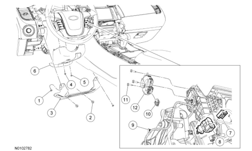

The mode door actuators are shown in the above picture. As far as the blend air door actuators, here are the directions with pictures of the locations:

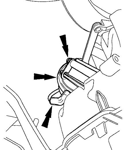

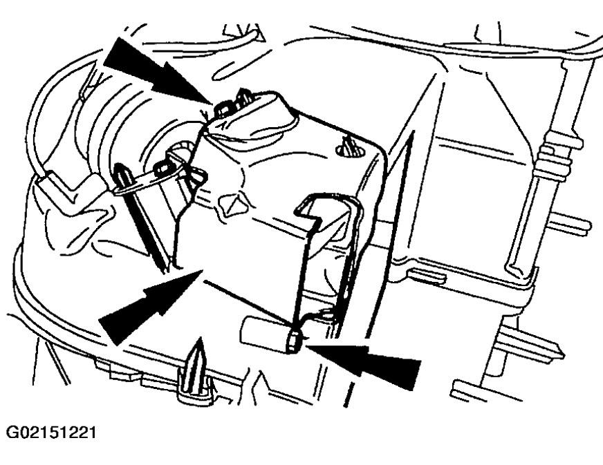

Mode Door Actuator - Air Inlet Door
1. Detach the glove compartment damper and lower the glove compartment.
pic 5
2. Disconnect the air inlet door actuator electrical connector, remove the 2 retainers and the air inlet door actuator.
pic 6
3. To install, reverse the removal procedure.

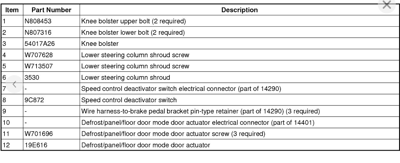

Good afternoon,
There is a mode door actuator that controls this. It is above the fuel pedal and I attached a picture for you to view.
When you are done, remove the fuse for the A/C for 5 minutes.
Then reinstall and turn the key to on position and wait 5 minutes. The system will calibrate the actuators.
1. Remove the Instrument Panel Cluster (IPC). .

Should there be two actuators on the drivers side? I have found one directly above the accelerator pedal,but after removing it and turning the door by hand it changed the air temperature on the drivers side.
Jun 22, 2021 at 4:00 AM (Merged)
Yes, there are 2. One for the blend door and one for the mode control. Look above it and toward the firewall.
Use a nice bright LED light to find it.

HMAC300
  • 48,601 POSTS
see if vacuum is going to motor in picture. it can be reached through driver's foot well. if it is the vacuum motor is bad, if not check for a vacuum leak at heater switch it may be leaking there.

HMAC300
  • 48,601 POSTS
the red arrow in picture shows what this looks like this is accessed through driver's foot-well. that means by the gas pedal. there is a shield that other arrows point to so it can be removed.
