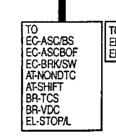

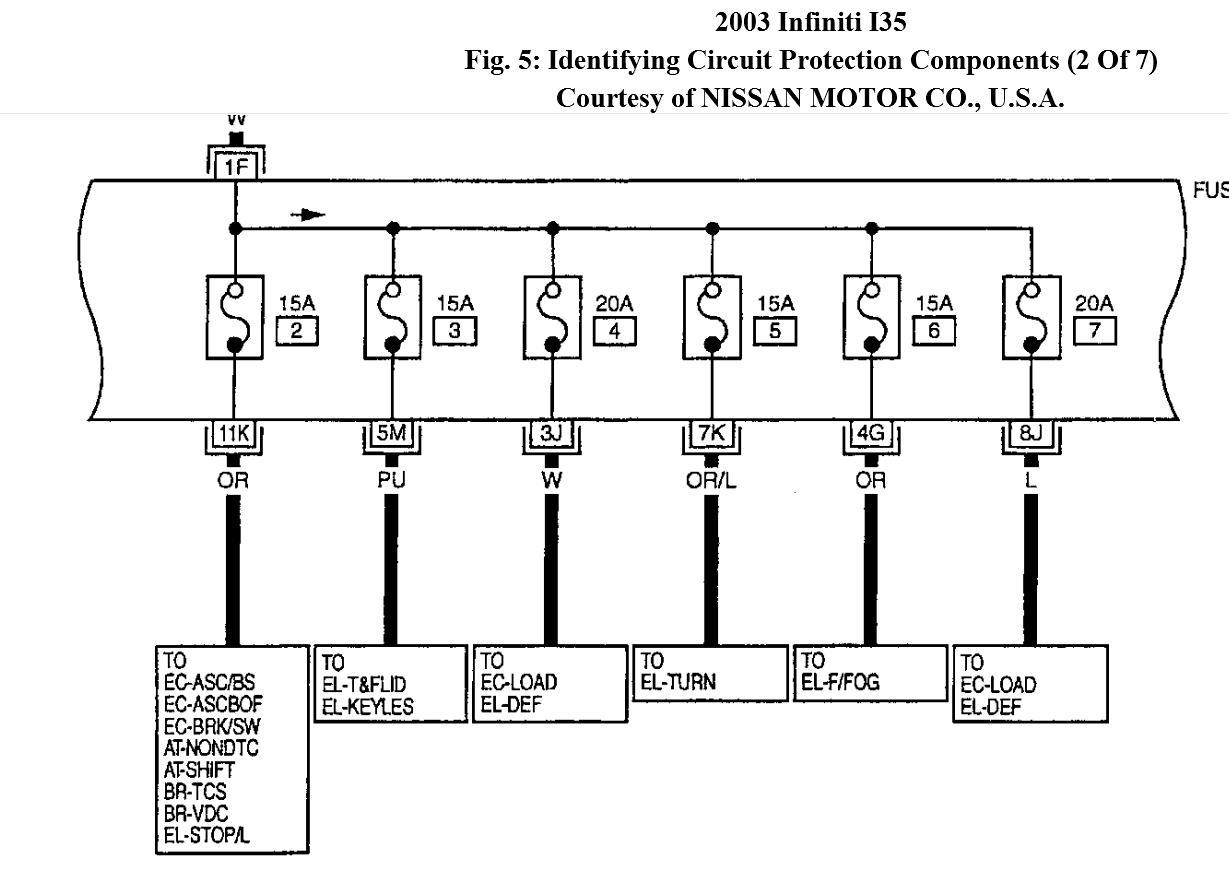

I have the same problem. I have discovered that if I pull the engine control fuse 2 15-A the noise stops. If I try to turn on the car without the fuse in the engine wont start. Could this be a valve or an issue with the fuel pump? Please help!

Diagram shows what are the components linked to this fuse. I don;t see any problem why you can't start as the list does not indicate any reference to engine control.
