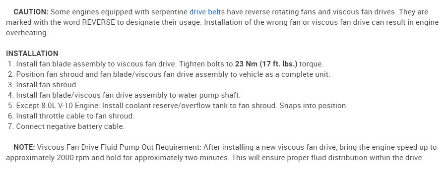

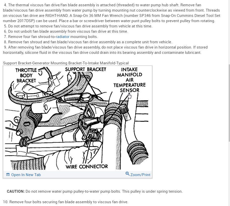

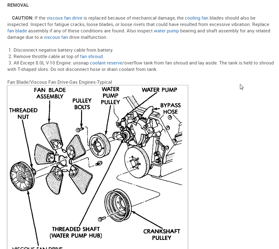

Do you have the special tools to remove it? Here is a guide that shows a set of them. They are basically just thin wrenches but if not, I attached a video that shows another way to get them off. You need an air impact hammer for this way.
https://www.2carpros.com/articles/fan-clutch-removal
https://youtu.be/VIaAFlhs0Es
Please let me know if you still can't get it and we can come up with something else. Thanks
Thursday, May 13th, 2021 AT 12:20 PM
DANNY L
  • 5,648 POSTS
Hello, I'm Danny.
Here is a tutorial showing what is involved for removal/installation. You will need a 36mm wrench for the job.
I've attached step-by-step instructions below.Hope this helps and thanks for using 2CarPros.
