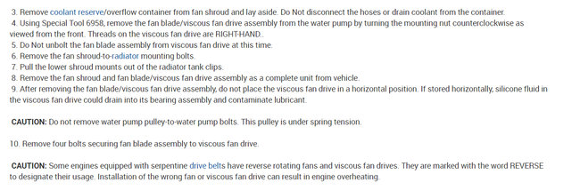

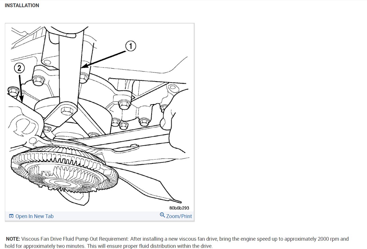

I have a 2005 Ram 1500 with the 4.7L V8 and only 67,000 miles on it. Engine temp is right where it needs to be until I am stopped in traffic or at a light at which point the temperature starts creeping up. If I put the truck in nuetral and rev the engine a bit, the temperature starts coming back down. I have replaced the thermostat as well as flushed the radiator and the problem still persists. The water pump is less than a year old so I don't think that is the issue. I am fairly certain it is not a head gasket issue since I changed my oil and found no trace of coolant in the oil. What could be going on with my truck?

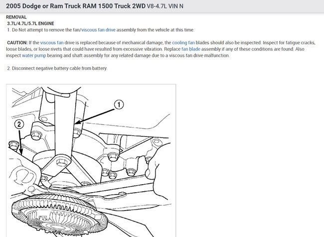

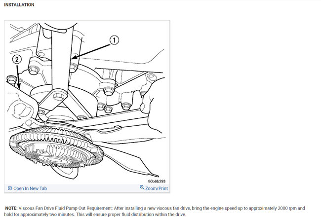

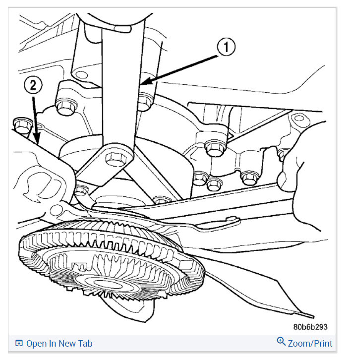

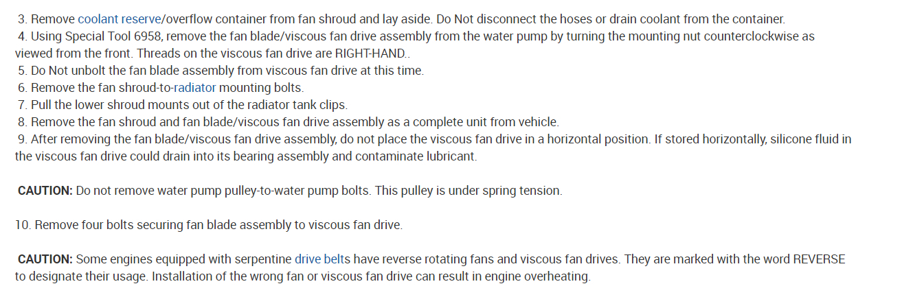

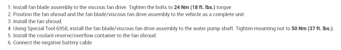

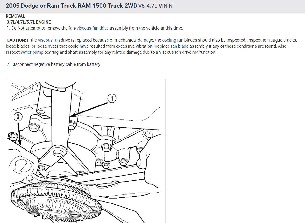

Dandy observation that increasing engine speed brings the temperature down. Be sure the shroud is in place behind the radiator and there are no places air can bypass the radiator. This video shows the job being done on a similar car but the process is the same.
https://youtu.be/N_-MLVlBHk8
and
https://www.2carpros.com/articles/fan-clutch-removal
