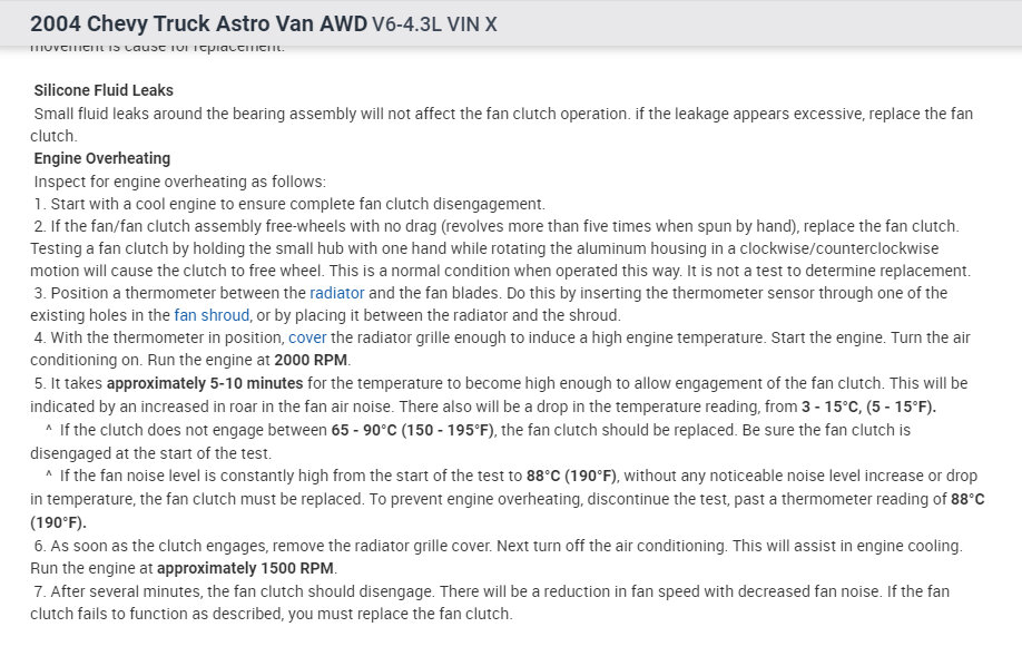

When it starts to overheat, does the fan make excessive noise? Also, has the same brand clutch been used each of the three times?
If you look below, I included the clutch fan diagnostics. Here is the thing. If the fan is excessively loud when it is overheating, there is a different issue causing the overheating. If the fan slows down when overheating, it has to be the fan clutch. That's why I ask if it was replaced all three times with the same brand. You may be getting faulty fan clutches.
Let me know your thoughts.
See pic below.

Thanks, Joe. The fan seems to make less noise when it gets too hot. *210-*240!
Each fan clutch came from different stores; different brands. A skilled mechanic in a professional shop has been doing all the work on it over several days now. I drive 45 miles from there and the exact same symptom comes back= No Power, Excessive Fuel Consumption, Excessive Fan Noise and it Overheats. All of these ideas are pointing to another Bad Fan Clutch. That's crazy!
