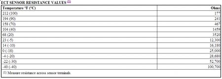

Jerry, first this is the IAT and ECT do the show within 5 degrees of each other? And do the OHM show what it should be as well as the temp? Here's the table, and the readings are the same for both sensors. Check ignition switch as switch signal must be present for injectors to fire.

The IAT and ECT do show reasonable values via the OBDII. I have not ohmed them out yet ( I assume that's what you mean by OHM? ).

When it stops raining, I'll go out, perform the passlock and ohm those temperature sensors.
