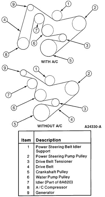

My cooling fan is literally hanging. the belt won't stay on and antifreeze comes out from behind the fan shaft near where the fan is housed against the water pump. how do I fix this?
Dec 9, 2020 at 11:41 PM
  • 110,240 POSTS
If there is a coolant leak where you described, the water pump is likely bad. The water pump pulley may be loose. See if there is excessive play in it. Chances are that is causing the belt issue.
Take a look through this link It explains what I am referring to.

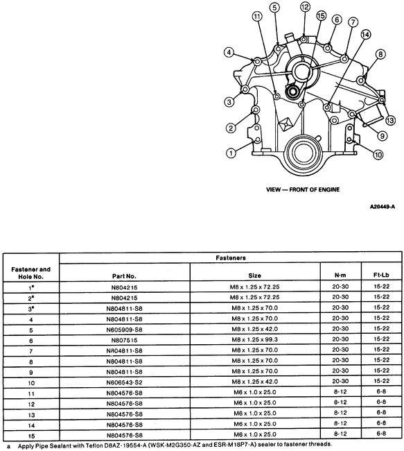

2. Position a new gasket on water pump sealing surface using Gasket and Trim Adhesive to hold gasket in position.
pic 1
3. Install water pump on engine front cover and hand-tighten 12 attaching bolts. Tighten to specifications on accompanying chart.

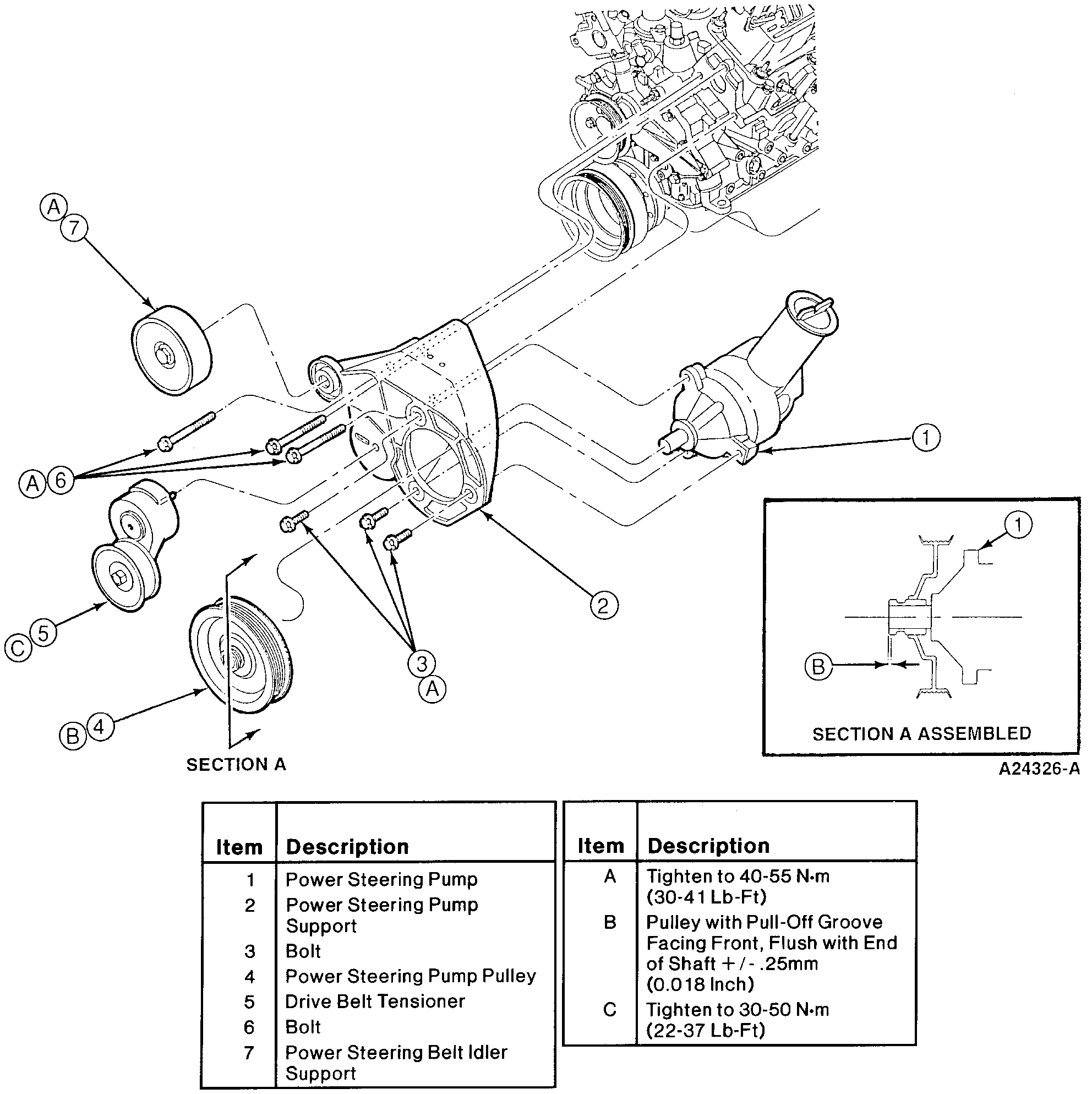

pic 2
5. Reinstall power steering pump support bracket to engine and torque to 48-61 N.m (35-45 lb-ft).

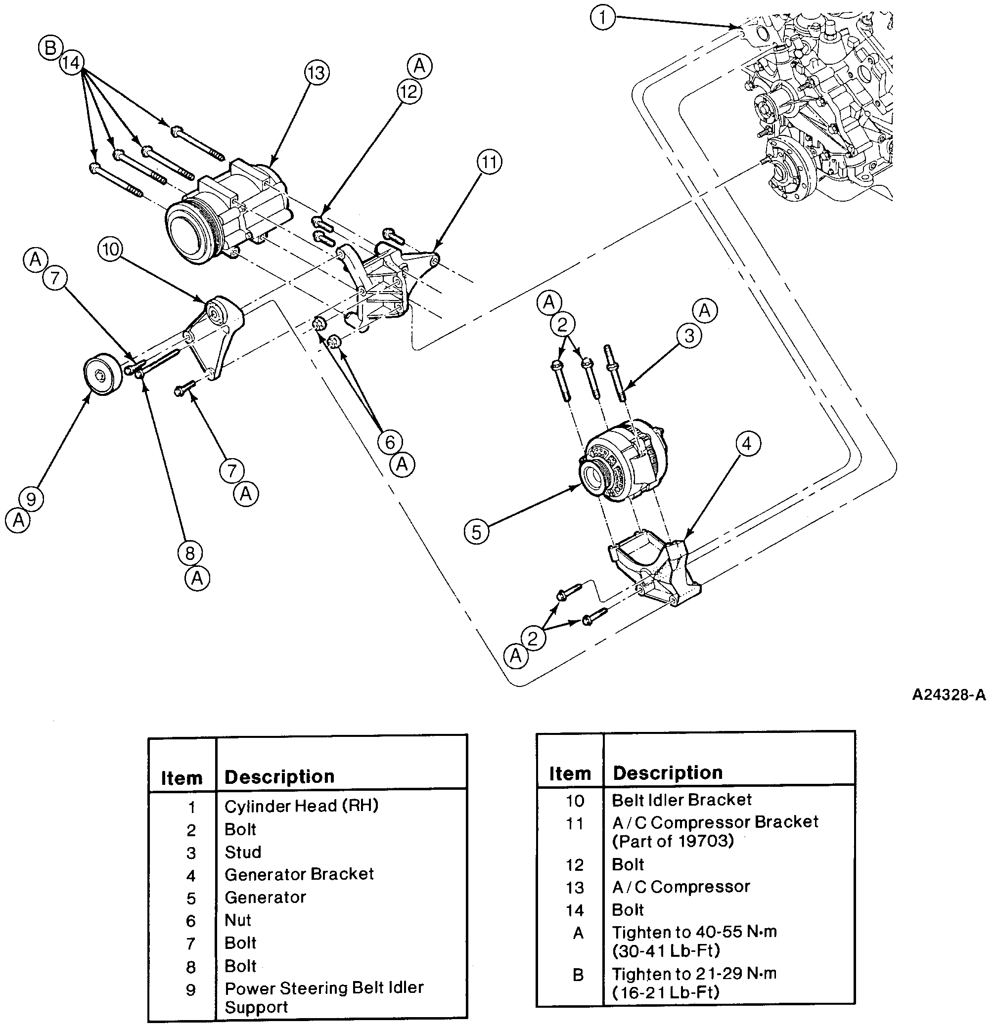

pic 3
10. Reinstall generator and bracket assembly to right cylinder head with 3 bolts and torque to 40-54 N.m (30-40 lb-ft).
11. Reconnect 3 wiring connectors in generator.
12. Install oil fill tube bracket over stud at generator and torque retaining nut to 42-50 N.m (32-37 lb-ft).
13. Install water pump pulley on water pump hub and tighten bolts finger-tight.
pic 4
14. Wrap engine accessory drive belt around all pulleys except generator. ROTATE belt tensioner CLOCKWISE and when belt clears, slip over alternator pulley.
15. Torque water pump pulley bolts to 23-32 N.m (18-24 lb-ft).
