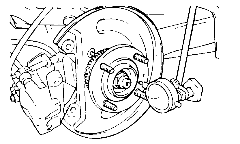

WHEEL BEARING END PLAY INSPECTION
1. Inspect the play of the bearing while the vehicle is jacked up and resting on floor jack.
2. If there is any play, remove the hub cap and then release the parking brake.
pic 1
3. Check the bearing end play. Place a dial gauge against the hub surface, then move the hub in the axial direction and check whether or not there is end play.
Service limit mm (inch): 0.005 - 0.025 (0.0002 - 0.001 or less
4. If the end play exceeds the limit, the rear wheel bearing nut should be tightened to the specified torque and check the end play again.
5. Replace the rear hub bearing unit if an adjustment cannot be made to within the limit.
Not always is there play in and out or side to side, so spin the wheel to see if there is any noise that is heard or if it feel rough.

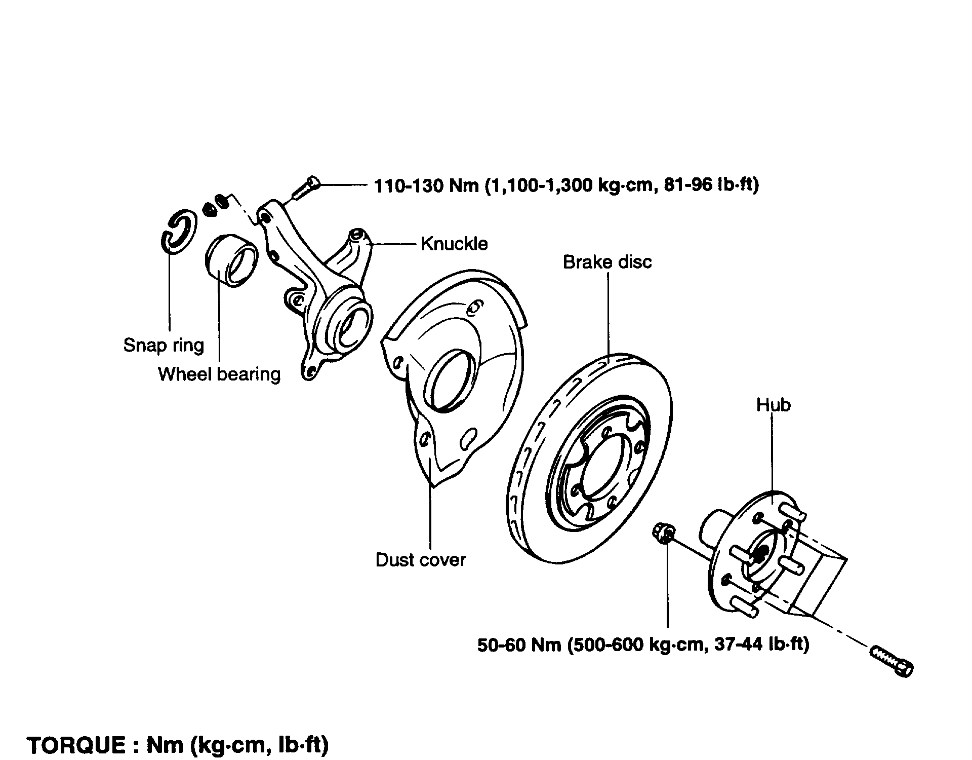

Chances are that is the problem. Here are the directions for replacement. The attached pics correlate with the directions.
___________________________________________

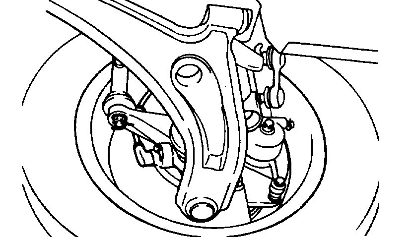

FRONT
pic 1
REMOVAL
1. Remove the wheel and tire.

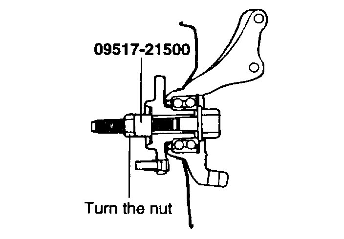

Pic 2
2. Remove the drive shaft nut.
3. Remove the vehicle speed sensor from the axle assembly.

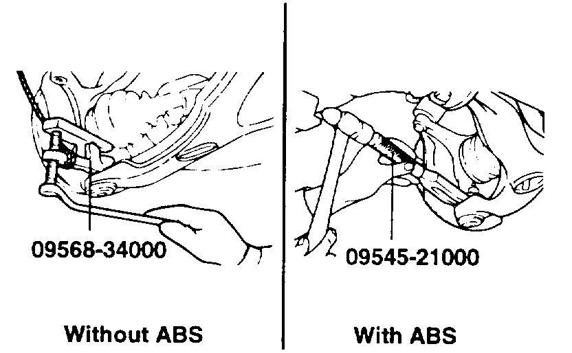

Pic 3
4. Remove the front brake assembly from the knuckle and suspend with a wire.
NOTE: Brake hose does not need to be disconnected from brake caliper. Be careful not to depress brake pedal, or piston will pop out.

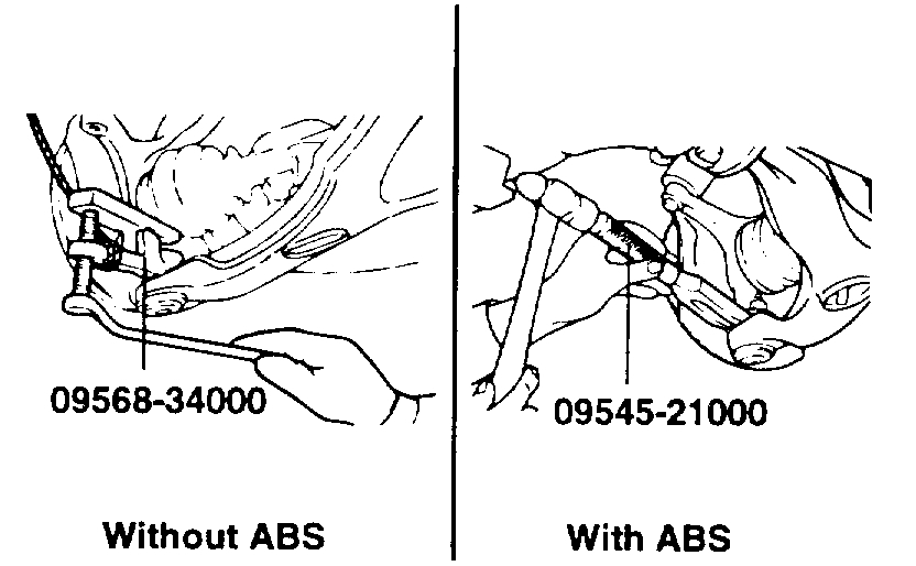

5. Disconnect the lower arm ball joint from the knuckle using the special tool.

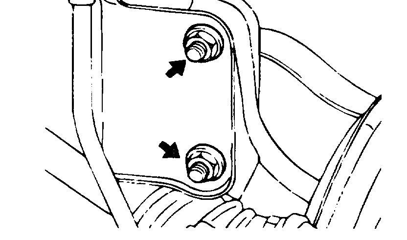

Pic 4

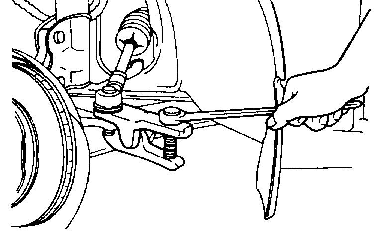

6. Disconnect the tie rod and ball joint from the knuckle using the special tool.
NOTE:
1) Be sure to tie a cord to the special tool and to a nearby part.
2) Loosen the nut but do not remove it.
Pic 5

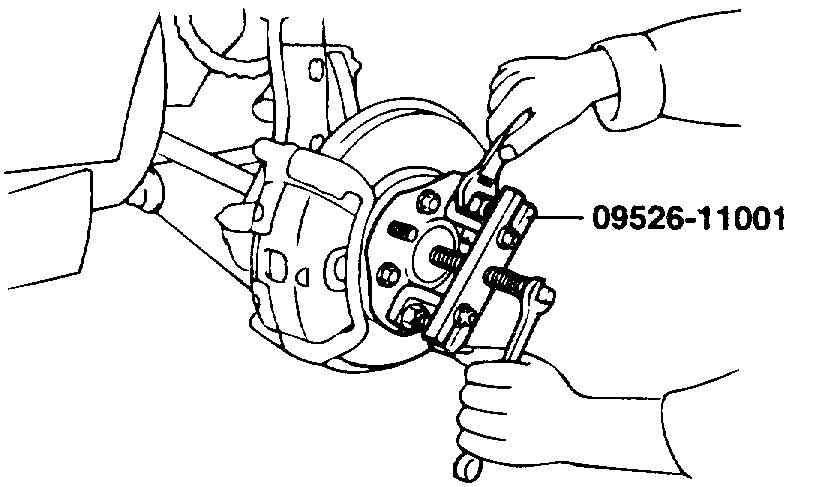

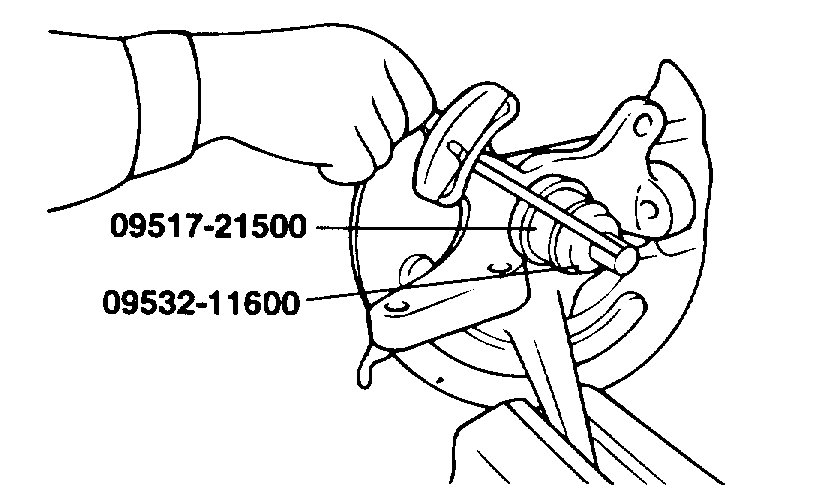

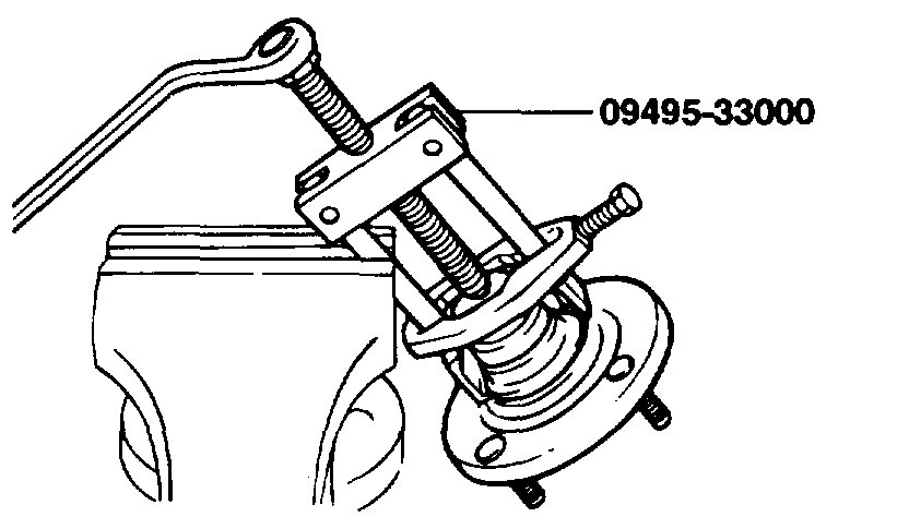

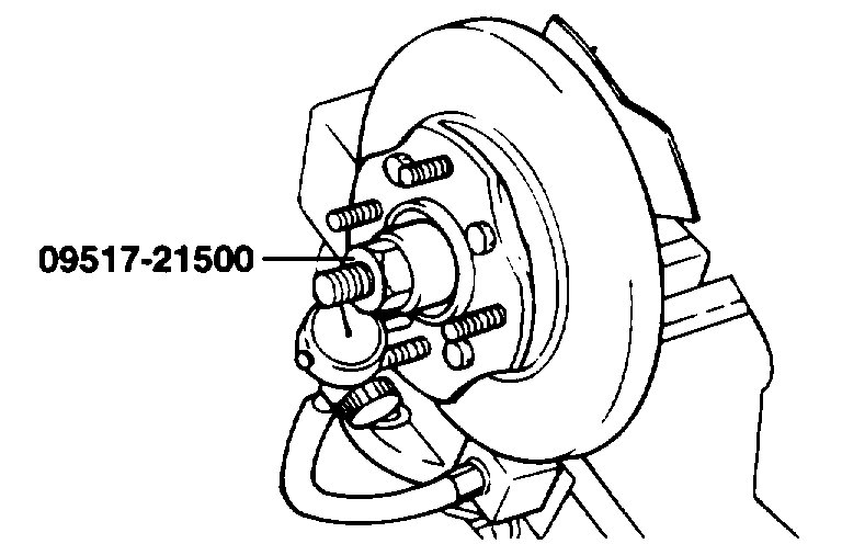

7. Disconnect the drive shaft from the hub using the special tool.
Pic 6
8. Remove the hub and knuckle as an assembly from the strut.
INSPECTION
1. Check the hub for cracks and the splines for wear.
2. Check the snap ring for cracking or damage.
3. Check the steering knuckle for cracks.
DISASSEMBLY
pic 7

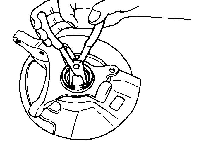

1. Remove the snap ring.
Pic 8

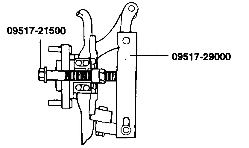

2. Attach the special tools to the knuckle and hub.
3. Secure the knuckle in a vise.
4. Tighten the nut of the special tool and remove the hub from the knuckle.
NOTE: When removing wheel hub or wheel bearing from knuckle, replace wheel bearing assembly (outer race, inner races and grease seals) with a new one.
Pic 9

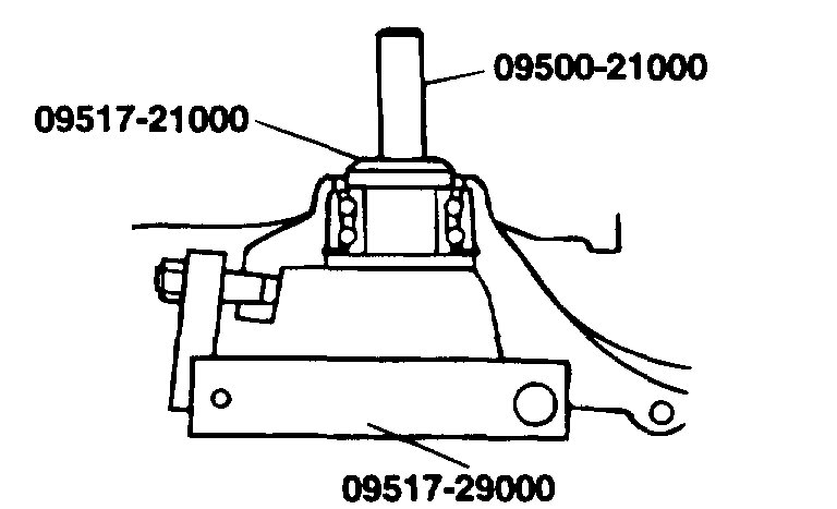

5. Using the special tool, remove the wheel bearing inner race (outside) from the front hub.
Pic 10
6. Install the inner race (outside) that was removed from the hub to the wheel bearing, and then use the special tool to remove the wheel bearing.
INSPECTION
1. Check the hub and brake disc mounting surfaces for scoring and contamination.
2. Check the knuckle inner surface for scoring and cracks.
3. Check for a defective bearing.
REASSEMBLY
1. Fill the wheel bearing with multipurpose grease.
2. Apply a thin coating of multipurpose grease to the knuckle and bearing contact surfaces.
Pic 11

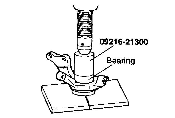

3. Press-in the bearing by using the special tool.
NOTE: Do not press inner race of wheel bearing assembly.
Pic 12
4. Install snap ring into groove of knuckle.
Pic 13
pic 14

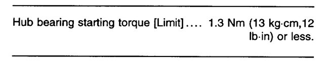

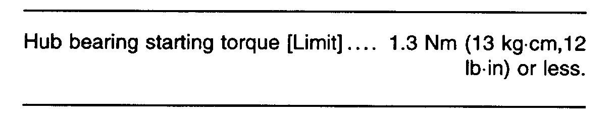

5. Measure the hub bearing starting torque.
Pic 15

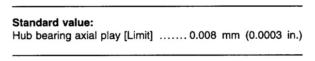

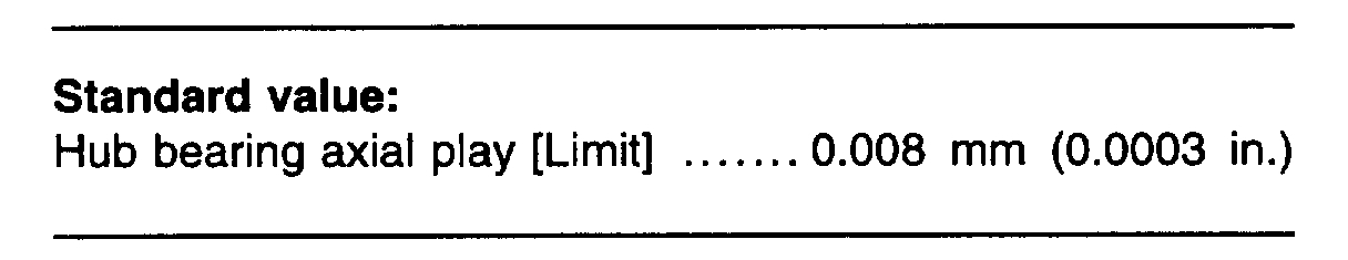

6. If the starting torque is 0 Nm (0 inch lbs.), Measure the hub bearing axial play.
Pic 16
7. If the hub axial play exceeds the limit while the nut is tightened to 200 - 260 Nm (2,000 - 2,600 kg-cm, 148 - 192 ft. Lbs.), The bearing, hub and knuckle have not been install correctly.
Repeat the disassembly and assembly procedure.
