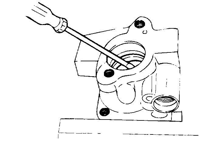

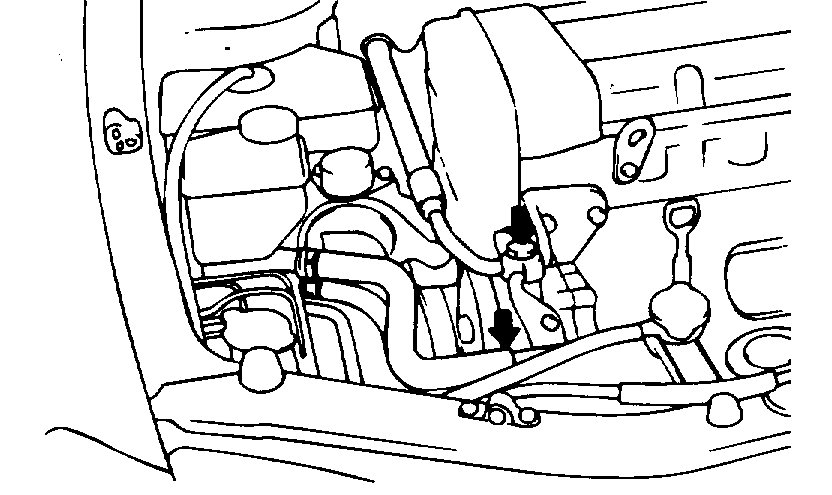

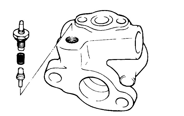

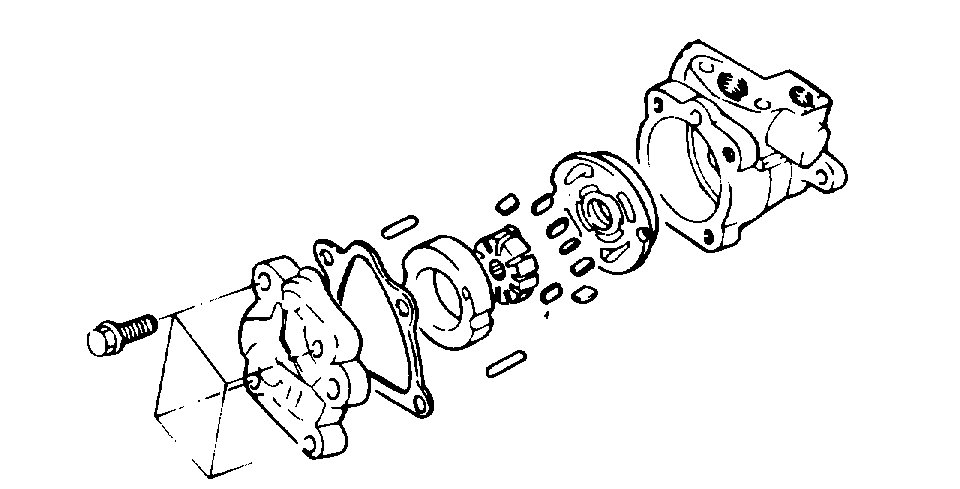

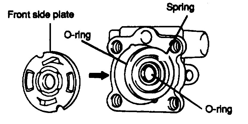

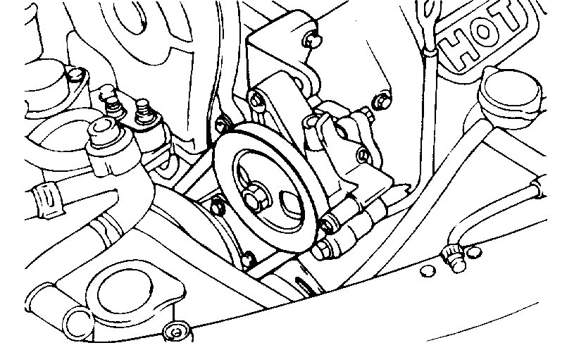

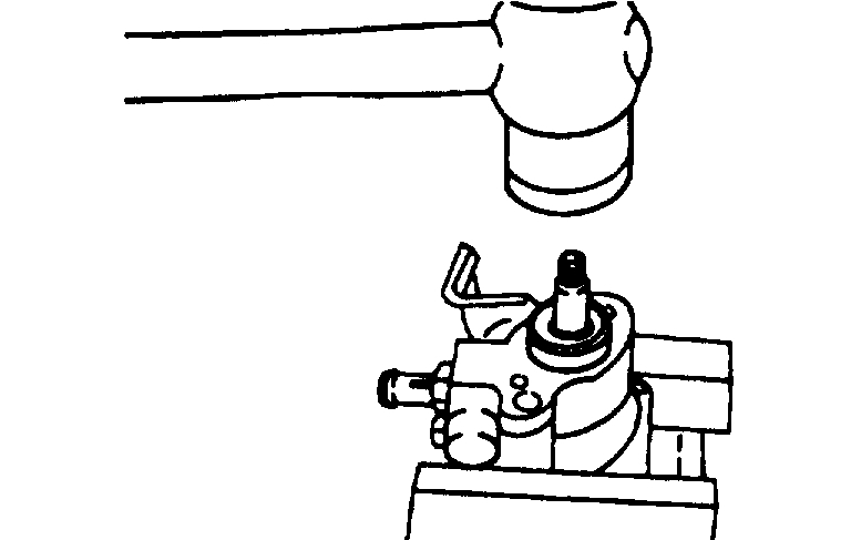

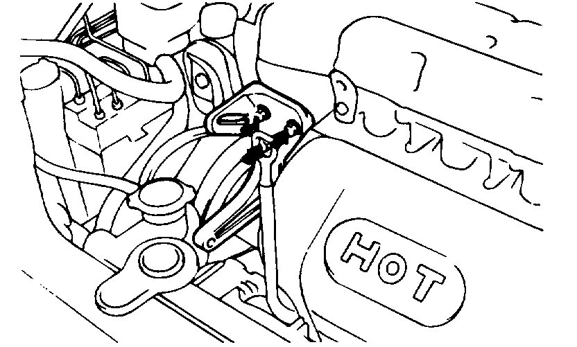

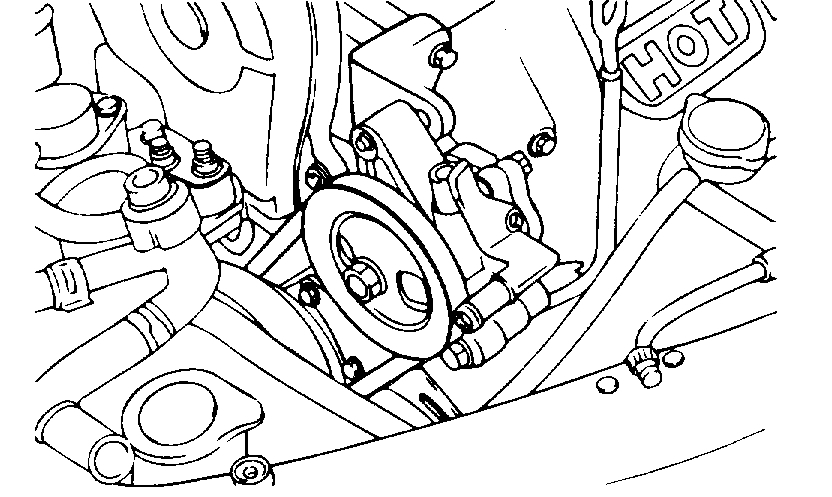

If you decide to rebuild the one in the vehicle, here are the directions specific to your vehicle for an overhaul. I also wanted to include this because it shows how to remove and replace the pump if you decide to just get another pump. All attached pictures correlate with these directions.
_________________________________
UNIT OVERHAUL

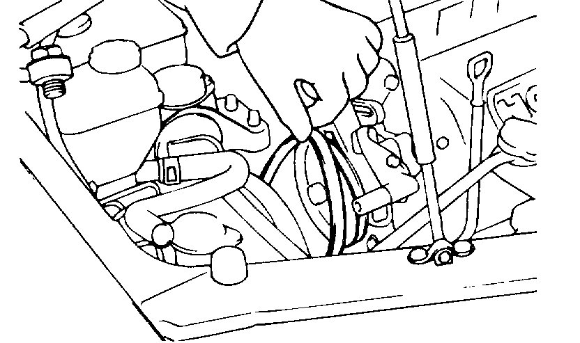

REMOVAL
1. Remove the pressure hose from the oil pump.
2. Disconnect the suction hose from the suction connector and drain the fluid into a container.
3. Loosen the oil pump mounting bolts to remove the V-belt.
4. Loosen the tension adjusting bolt.
5. Remove the power steering drive belt from the power steering oil pump pulley.
6. Remove the power steering oil pump mounting bolts and the tension adjusting bolt.
7. Remove the power steering oil pump assembly.

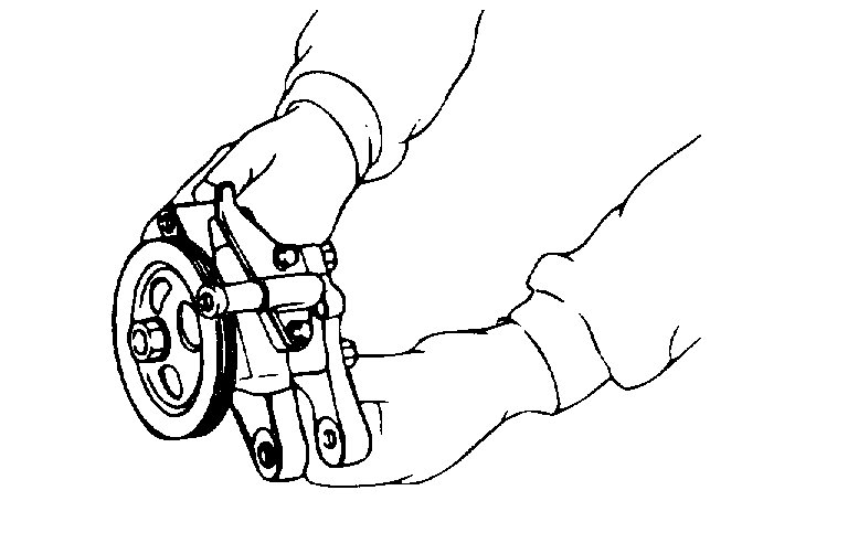

NOTE: Be careful not to drip fluid from the power steering oil pump.
8. Remove the power steering oil pump mounting bracket.
9. Remove the suction pipe and the O-ring from the oil pump.

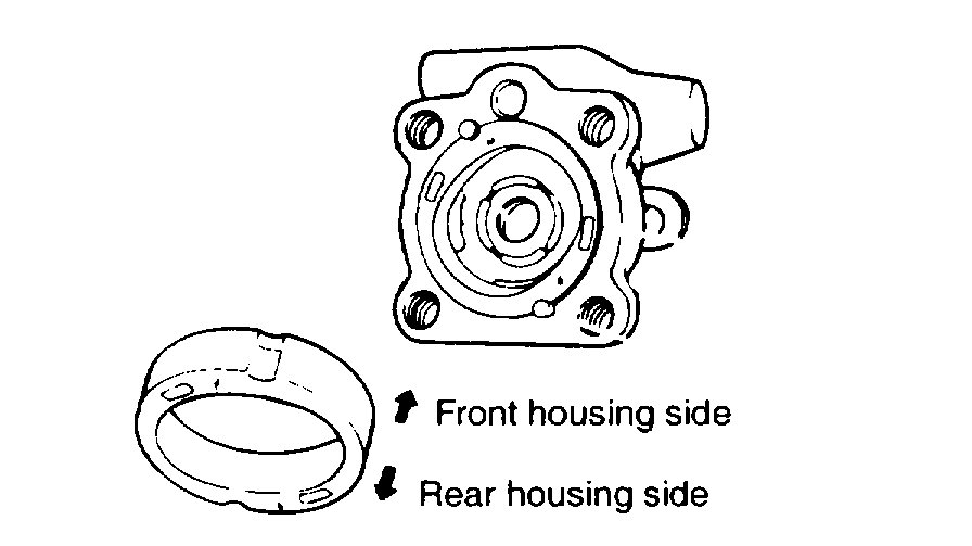

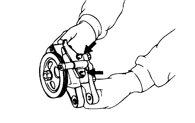

10. Remove the rear cover with the gasket and pins.
11. Remove the cam ring.
12. Remove the rotor and vanes.
13. Remove the front side plate.

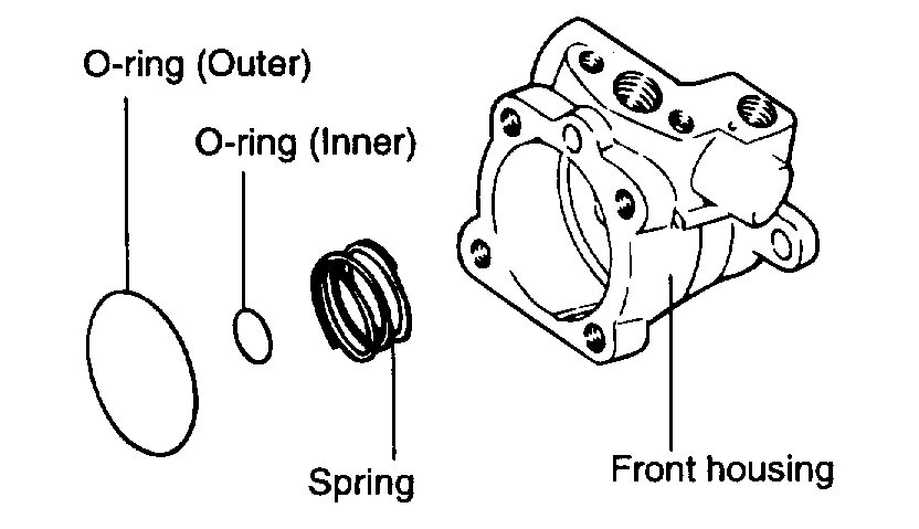

14. Remove the inner and outer O-ring.
15. Remove the spring.
NOTE: When assembling, use a new gasket and O-ring.

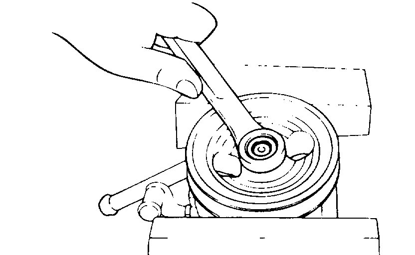

16. Remove the pulley nut with the spring washer.
17. Pull off the pulley and the woodruff key.

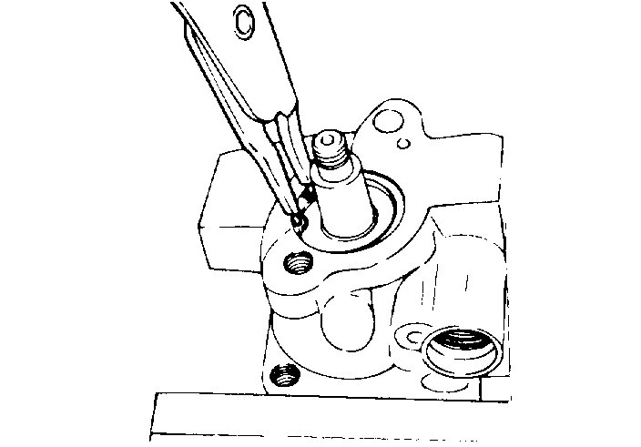

18. Remove the snap ring using snap ring pliers.
19. Drive out the pulley shaft with the bearing. If necessary, use a plastic hammer.

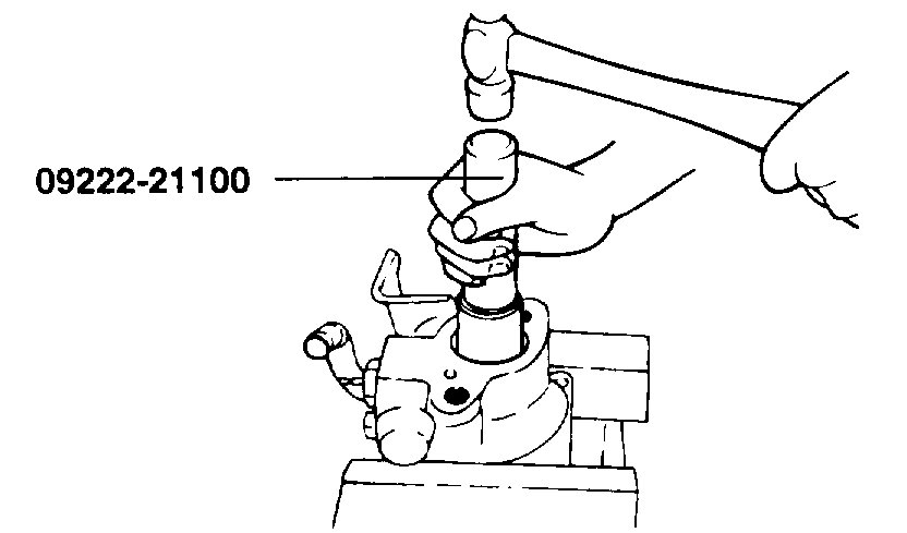

20. Remove the oil seal from the oil pump body.
NOTE: When assembling, use a new oil seal.
21. Remove the guide bracket and nut.

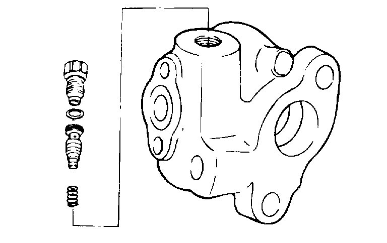

22. Remove the connector from the oil pump body, and take out the flow control valve and the flow control spring.
23. Remove the O-ring from the connector.
CAUTION: Do not disassemble the flow control valve.
24. Remove the oil pump switch.
25. Take out the spring and the spool.
26. Remove the O-ring from the oil pump switch.
REASSEMBLY
1. Install the oil pump switch.
2. Install the flow control valve spring, valve and connector in the pump body.
NOTE: Apply a thin coat of specified ATF DEXRON II type fluid to all the replaced parts including the oil seal and the O-ring.
3. Install the guide bracket and nut.
4. Using a special tool, install the oil seal into the pump body.
5. Gently insert the shaft assembly and install the snap ring.
6. Install the pump pulley with woodruff key in place.
7. Install the spring and the inner and outer O-rings.
8. Install the front side plate.

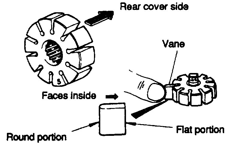

9. Insert the pins into the pin grooves of front housing, then install the cam ring, paying attention to its direction.
10. Install the rotor with its punch marked side facing towards the front side plate.
11. Install the vane plates with the round end facing outward.
12. Install the gasket and the rear cover.
13. Tighten the suction connector.
14. Installation is the reverse order of removal.
NOTE:
1. Install the hoses so that they are not twisted and they do not come in contact with any other parts.
2. Install parts by referring to the torque specification.
3. Replenish the fluid.
Recommended fluid Specified PSF - 3 type
4. Bleed the system.
5. Check the oil pump pressure.
INSPECTION
1. Clean all disassembled parts with a suitable cleaning solvent.
2. If any inside parts of the oil pump have been damaged, replace the pump as an assembly.
3. If the pulley is cracked or deformed, replace it.
4. If oil leaks around the pulley shaft oil seal, replace the oil seal.
5. If the serrations of the pulley or pulley shaft are deformed or worn, replace them.

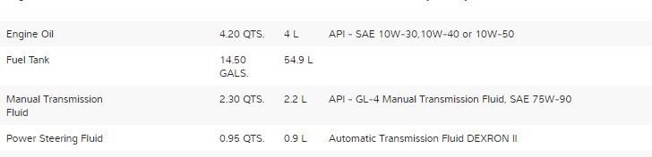

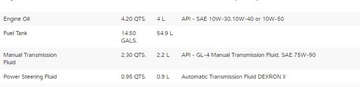

I do not have the owner's manual. Anyone has the PDF? I called both AutoZone and Advanced Auto and they both said their store brand generic power steering fluid should be fine. Do you know what kind of power steering fluid used by 2000 Hyundai Elantra? I checked the reservoir and the cap and they did not say what type of fluid to use. I am planning to use Walmart Supertech power steering fluid.
Dec 8, 2018 at 2:49 PM
  • 110,244 POSTS
Welcome back.
I attached a picture which indicates the type of power steering used in this vehicle.
Dexron II which is actually automatic transmission fluid. Regardless, that is what it requires.

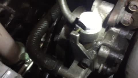

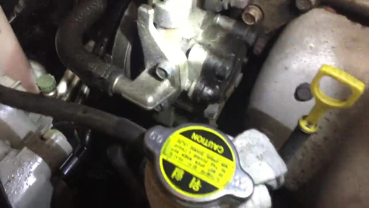

There was an incident. The car lost power steering ability while driving and then several minutes later some of the power in steering came back. After opening the hood I saw power steering fluid around the power steering reservoir and even on the hood, so the old fluid leaked for some reason. I was supposed to siphon out the old fluid anyway in order to get rid of the whining noise. This incident kind of helped me getting rid of the old fluid.
Previously, there was a grinding/whining sound coming from the drive belt area that's why I started this thread, now the noise is even louder since the incident.
Bought a Sea Foam Hydra Trans Tune and a quart of Dexron II and III compatible ATF. Added 6 ounces of Sea Foam and filled the rest of the power steering reservoir with the ATF.
Started the car, rotated the steering end-to-end, idled for a while and then drove around. When the steering rotated to either ends, the whining got louder. Didn't see any fluid leaking.
I took the power steering belt off and checked the power steering pulley and it was wiggling up to a few millimeters which didn't feel normal. I have audio and video, will it help if I upload? Is it a bad power steering pump or just the pulley?
Jan 5, 2019 at 3:41 PM
  • 110,244 POSTS
If you are getting up and down play in the pulley, that isn't normal. Also, you may be getting a leak from the seal at the front of the pump where the shaft comes through to attach to the pulley.
Upload the sound and if you can, a video of you moving the pulley so I can see how much play is there. If it leaked once, it's going to again. Also, since is sprayed, either the high pressure line leaked (which would still be leaking) or fluid came through the aforementioned shaft, hitting the pulley and flinging everywhere.

Used an online tool and created a video from the audio file and a photo that this website will allow uploading. Here is the audio:
Jan 18, 2019 at 2:14 PM
  • 110,244 POSTS
I got it. I hear a bearing noise which is most likely the pump. My belief is the pump is causing the belt issue. Other than the bad bearing noise that I'm hearing, I can't hear anything from the belt itself, but suspect it the pump is causing the problem.

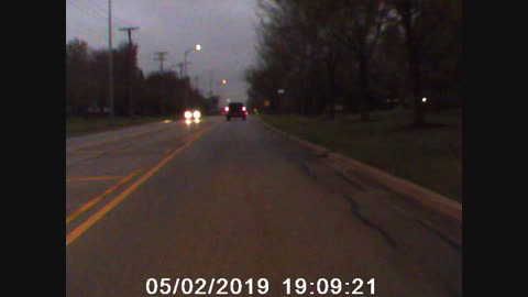

YOURMINKY
  • 106 POSTS
Here is another low resolution dash-cam video with audio. You can hear the rubber-ducky type sound when going round at the cul-de-sac towards the end. Previously I mentioned the rubber-ducky type sound was gone.
I boosted the audio gain by 20dB on the youtube video which may appear a bit noisy, my bad. I tried uploading the 2 "clean" MP3 audio files to 2carpros but your website stated "file type not allowed". Is there any way to send you those audio files? Advanced thanks for your help.
