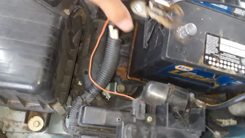

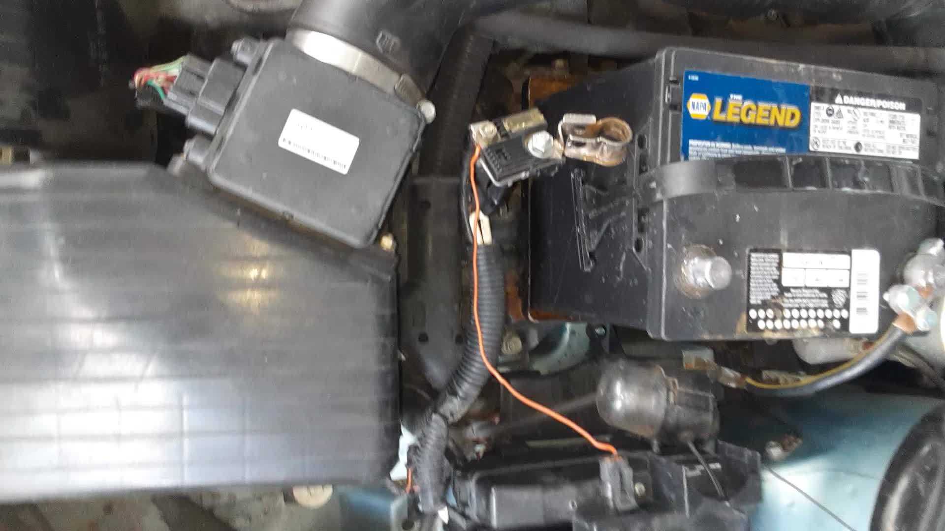

I plugged in my new battery and when I did both exterior lights kept flashing.

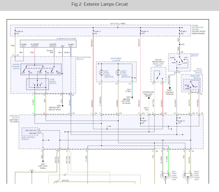

I'm sorry to keep asking questions, but this is a first. Especially since it is just the front lights. Also, let me know if it is the headlamps or the marker lights. I will have to study the wiring schematics to try and figure out what could cause this.

Can you send me your number so it can be easier and I can show you my problems on video because it wont let me send a video on here. I do not know why.
Jun 13, 2020 at 5:17 PM
  • 110,244 POSTS
Joel, we aren't permitted. What happens when you try to send the video? I can have someone from admin check into it for you.
Jun 14, 2020 at 9:20 AM
JOEL LOPEZ
  • 6 POSTS
I don't know how to.
Jun 14, 2020 at 9:22 AM
JOEL LOPEZ
  • 6 POSTS
I sent it.
Jun 14, 2020 at 9:31 AM
  • 110,244 POSTS
That's perfect. Inside the fuse box, there are relays. They are the black boxes about 1" square. Place your finger on them one at a time until you feel the clicking. Let me know which relay it is.
Jun 14, 2020 at 11:19 AM
JOEL LOPEZ
  • 6 POSTS
I tried it, it did not work.
Jun 18, 2020 at 3:40 AM
  • 110,244 POSTS
Were you able to locate anything in that box that was making the noise?
Jun 18, 2020 at 1:56 PM

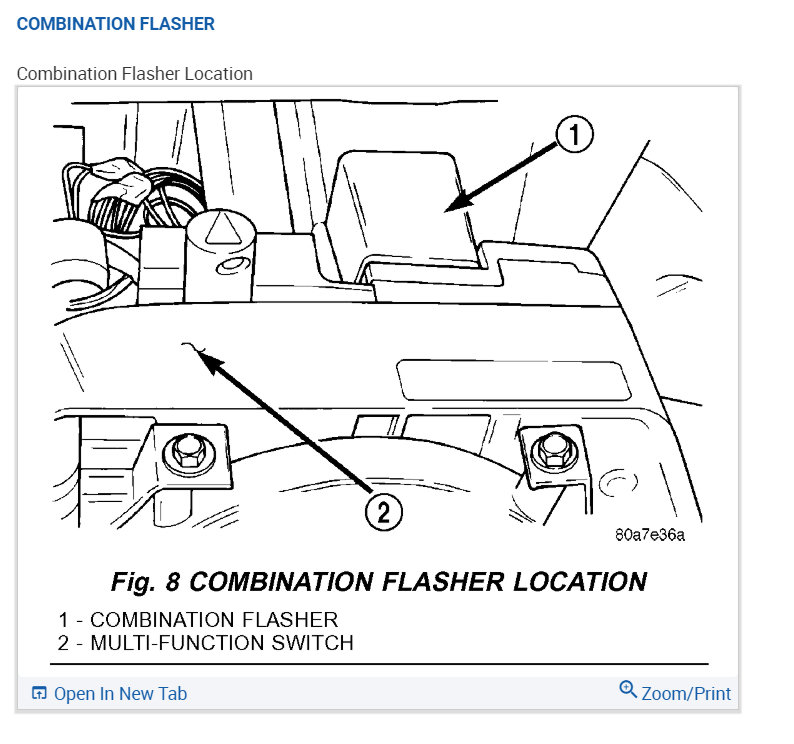

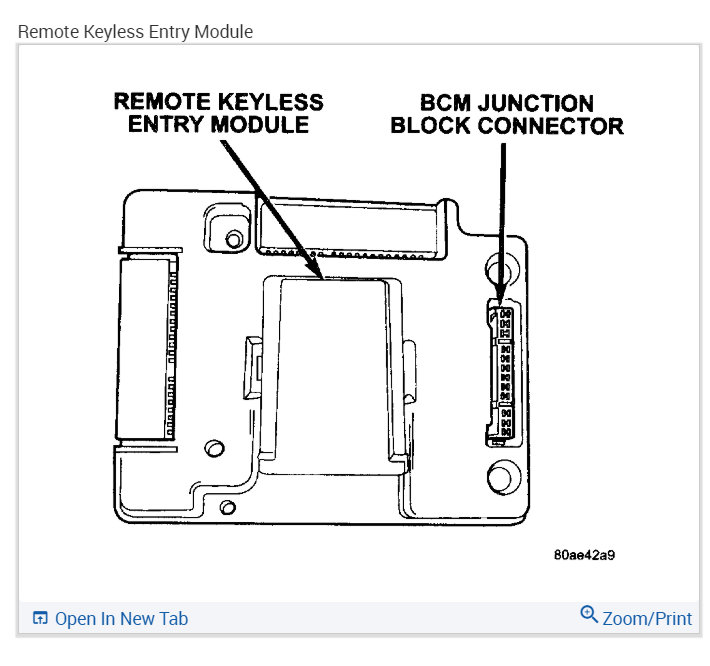

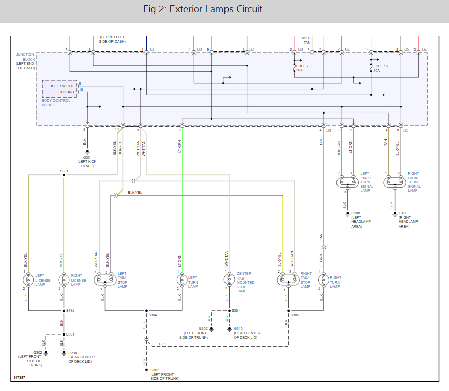

If I can jump in here it sounds like the BCM or combination flasher has gone out due to a voltage surge when the battery was replaced. I would do a CAN scan to confirm the issue. To be sure lets do a CAN scan which is the future of automotive repair you can get a CAN scanner from Amazon for about $50.00. here is a video to show you how:
https://youtu.be/InIlnsjOVFA

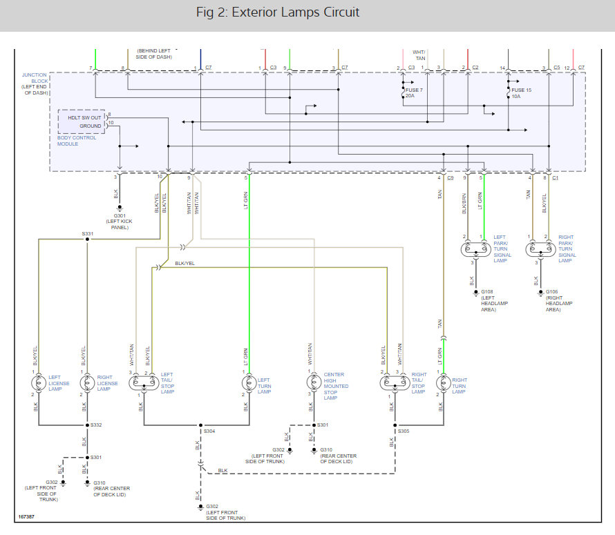

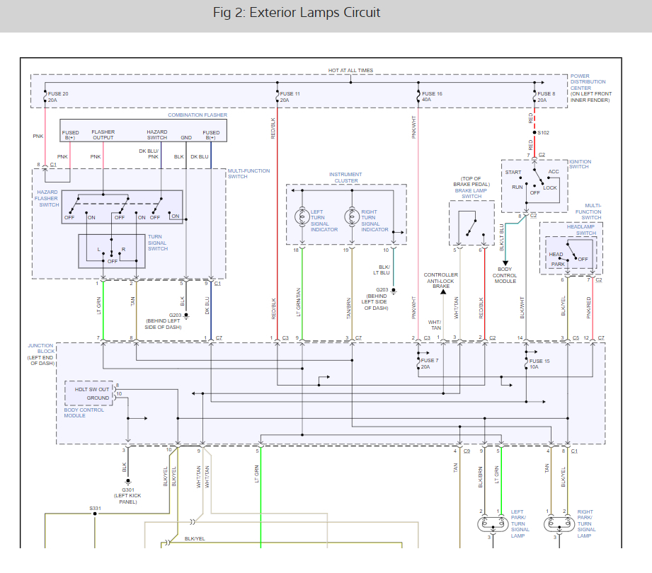

Here is the flasher and BCM location and the blinker wiring diagrams so you can see how the system works so you can check it out.
REMOVAL
The flasher is mounted to the back side of the multi-function switch. To gain access, the upper steering column cover must be removed. The flasher can be removed by pulling it forward. The flasher is serviced separately from the multi-function switch. The flasher is black in color for ease of identification.
INSTALLATION
The flasher is mounted to the back side of the multi-function switch. To gain access, the upper steering column cover must be removed. Push the flasher toward the rear of the vehicle. The flasher is black in color for ease of identification.
