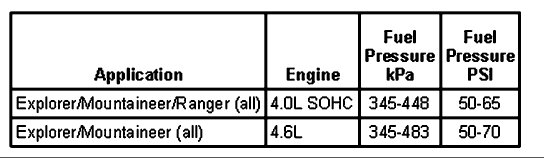

To start, either fuel or spark must be missing. The easiest way I have found to determine which is the problem is to see if it will start for a couple seconds using starting fluid. If it does, then it is a fuel related issue. If it does not then check for spark to the plugs.
Here is a link for a no start situation:
Next, if there is no spark or fuel, check the EEC relay in the power distribution box under the hood. Switch it with one with the same part number.
I attached a picture of the fuel pressure requirements if you need them.
