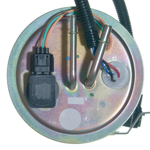

Thanks for assisting me troubleshooting my expi, I jsut have a quick question, prior to the replacement of the fuel motor, I saw the fuel sensor broken and was dangling at the side the the fuel assembly, I wanted to know what the fuel sensor was for. It was broken on the attachment from the top of the fuel assembly. So it wasn't in place but the mechanic just glued it back on. Did that possibly helped my fuel pump to work again?
Thanks

I will have to look at one to see what it is for, it may just be a fuel temp sensor, if so this would not affect the pump operation.

Attached is a picture of it. Its the square one that was dangling when the mechanic pulled out the assembly. Also is it normal for the engine to rev 2krpm when you cold start it?

I would say that it is the pump loom, the other would be the gauge sender, if it is broken, I would be replacing the module as an assembly.
