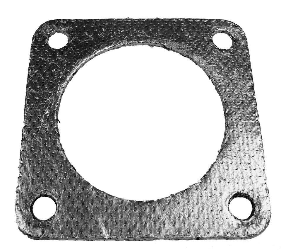

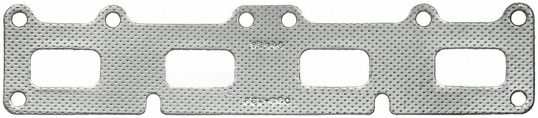

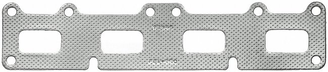

You need to be a bit more specific. There are two actual exhaust gaskets in the system. Exhaust manifold to cylinder head, Exhaust manifold to converter. Then there is the EGR gasket. Plus there is the flex pipe. Those are the common leaks. Unless the pipes are rusted. The pictures are the manifold and front pipe gaskets.
If the bolts are rusted either of them can be a tough replacement.

thank you, exactly what you just explained the exhaust seal is where i thought it was. the shop i brought it to said the seal was outside the bolted area, and they did put an exhaust wrap? what they called it, so who did wrong? my guess or there mechanic?
Apr 12, 2017 at 10:53 AM
CARADIODOC
  • 34,414 POSTS
I do not have any idea what was done. When I worked at a very nice family-owned Chrysler dealership, I was allowed to bring customers into the shop to show them what was found, and explain what was needed to solve the problem. Not all shop owners allow that, but in most states you have the right to have old parts returned or made available for your inspection. If you have anything you can post a photo of, I can tell you what it does.
