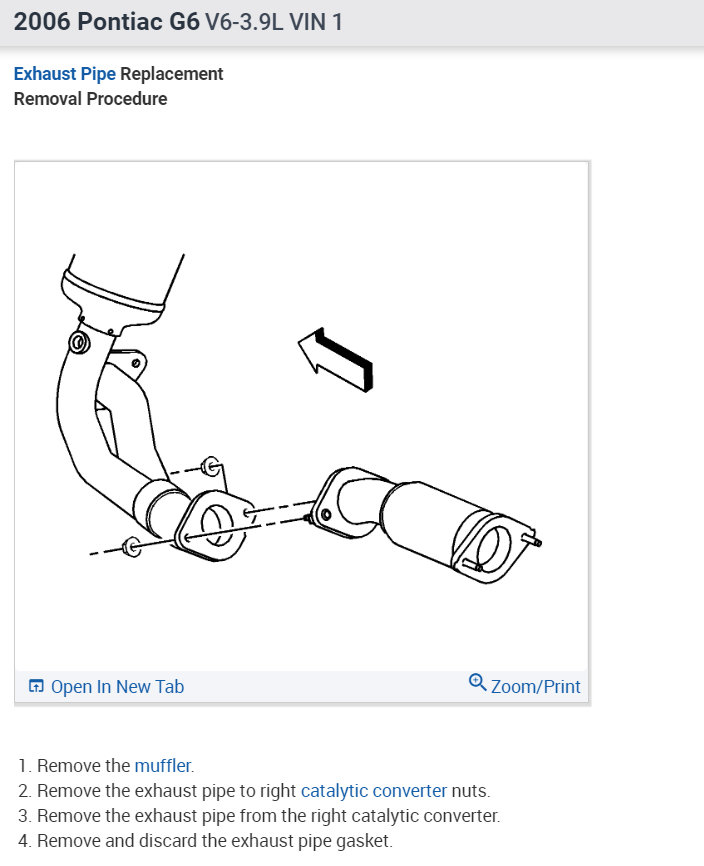

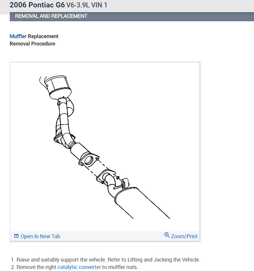

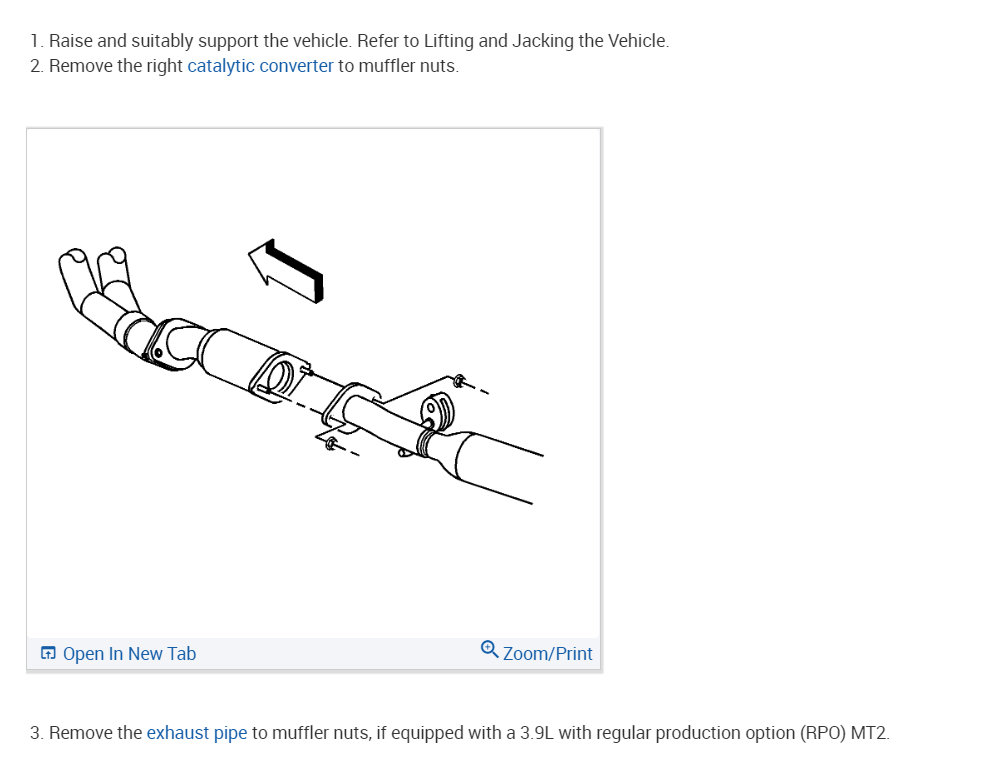

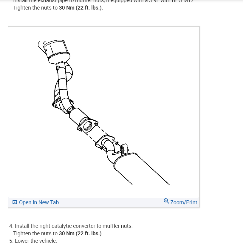

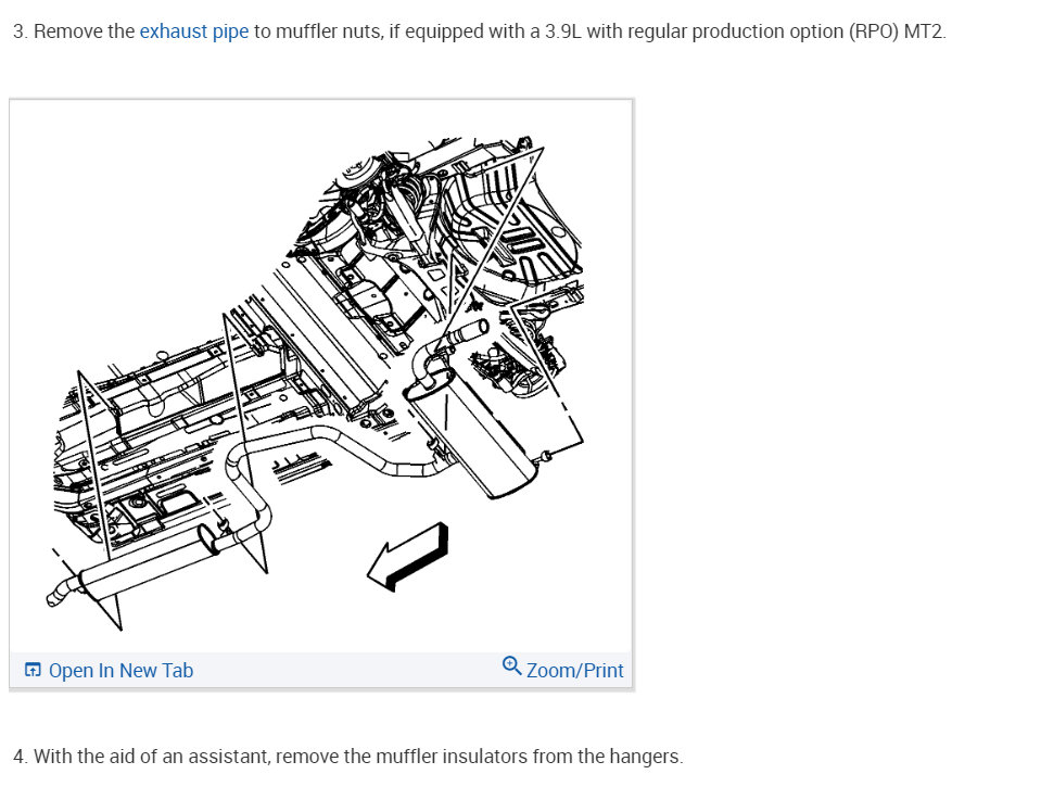

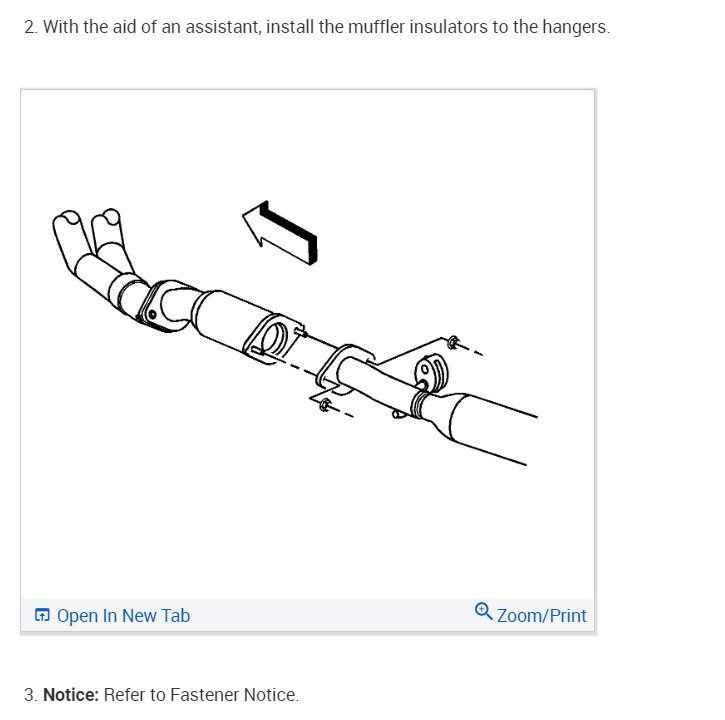

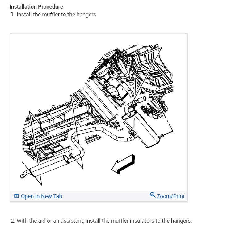

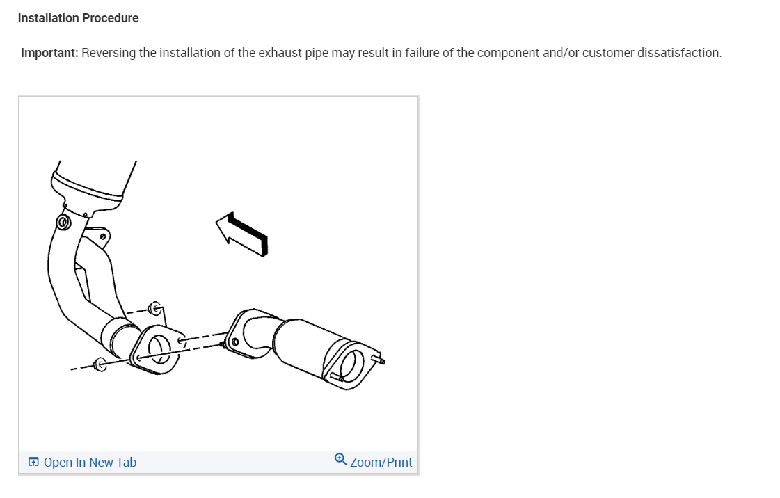

I think you can here is the information the manual gives you, I have also found diagrams on how the exhaust system looks (below) and how to install it with bolt tightening specs.

The exhaust system carries exhaust gases, treated by the catalytic converter, through a resonator, if applicable and into the exhaust muffler where exhaust noise is lessened.
In order to secure the exhaust pipe to the exhaust manifold, a flange and seal-joint coupling is utilized. The exhaust system may utilize a slip-joint coupling design with a clamp and a U-bolt or a flange connection with a gasket.
Exhaust hangers and rubber insulators help to support the weight of the exhaust pipe along with insulating any exhaust system vibration, rattle, or noise.
Exhaust hangers also space the exhaust system away from the underbody of the vehicle and allow the exhaust system to expand as the exhaust system warms up.

Resonator
Some exhaust systems are equipped with a resonator. The resonator, located either before or after the muffler, allows the use of mufflers with less back pressure. Resonators are used when vehicle characteristics require specific exhaust tuning.

Muffler
The exhaust muffler reduces the noise levels of the engine exhaust by the use of tuning tubes. The tuning tubes create channels inside the exhaust muffler that lower the sound levels created by the combustion of the engine.
