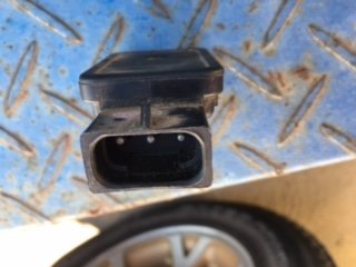

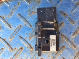

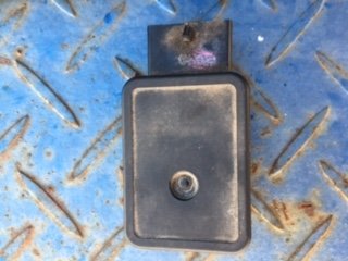

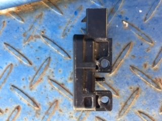

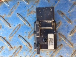

Thanks Ken. Pulled the MAP out and did MAP Sensor Test using multimeter and my breath. Sensor appears to be working at 0 in. Hg ... 4.67V and decreased as vacuum increased then increased to 4.67V as vacuum released.
2 Questions:
Is there anyway to clean MAP Sensor as appears to be sealed unit?
Even though appears to be working, considering its age and kms travelled, now that it is off would you recommend I replace it?
What else may be causing the excess fuel use?

The map sensor does seem to be working and there is no need to clean it. A couple of things come to mind, first has the engine been tuned up lately? Next there can be a vacuum leak causing the problem here is a guide to help you find it.
and third is a plugged exhaust system mainly the catalytic converter. Here is a guide so you can test that as well.
Please run some tests and get back to us so we can continue helping you.
