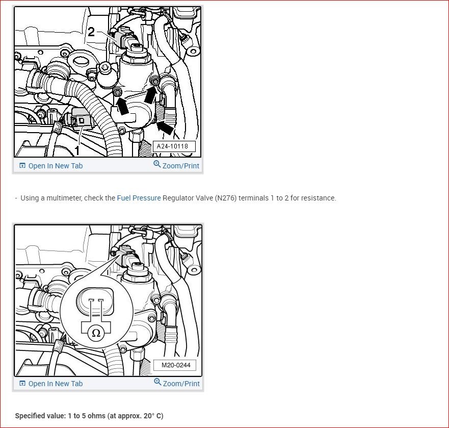

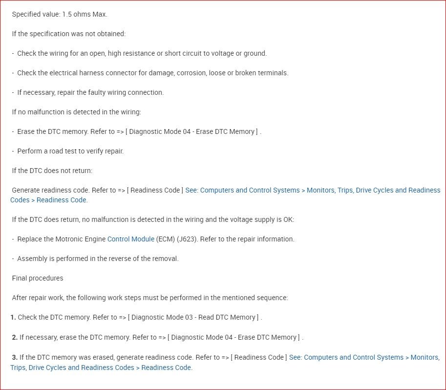

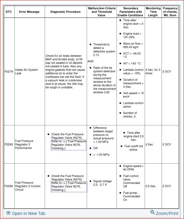

Purchased the car listed above and it doesn't start. I got error codes p0171 and p2294. not sure what to fix.
Apr 11, 2019 at 11:54 AM
Hi Zach,

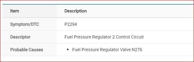

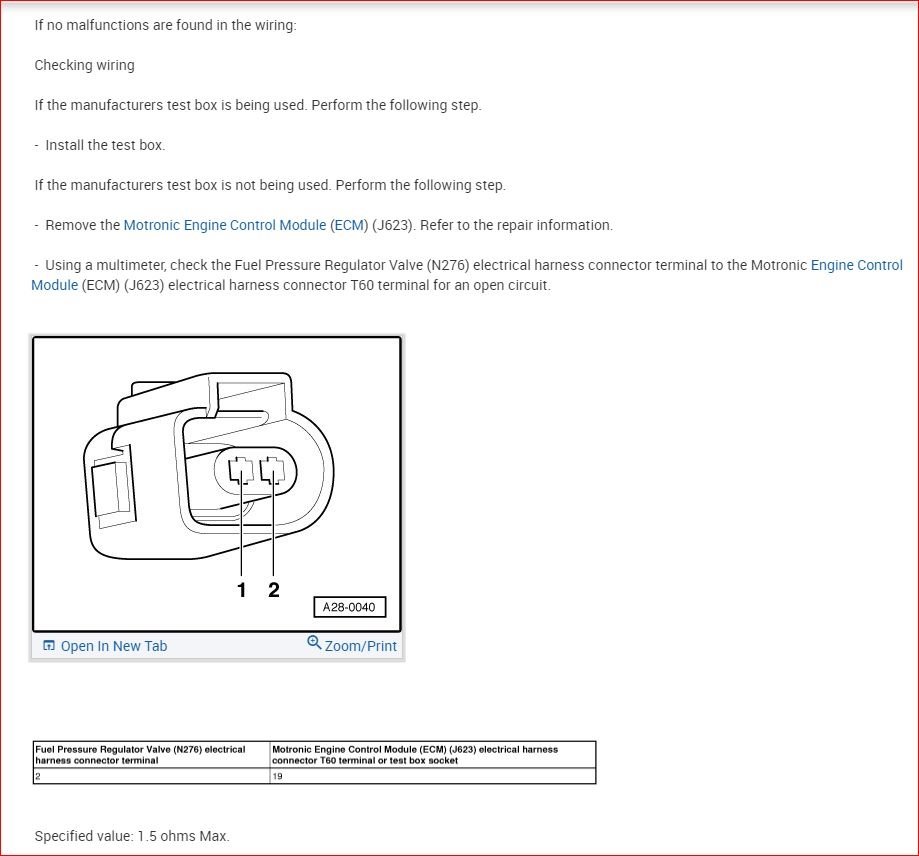

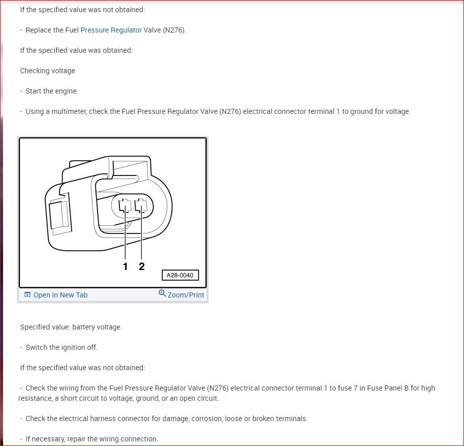

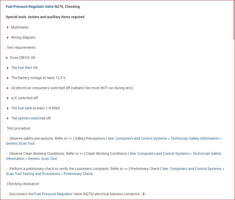

The P0171 is a bank 1 lean code so that is a symptom of your issue. The P2294 is a Fuel Pressure Regulator 2 control circuit DTCs. This is the one you need to chase.

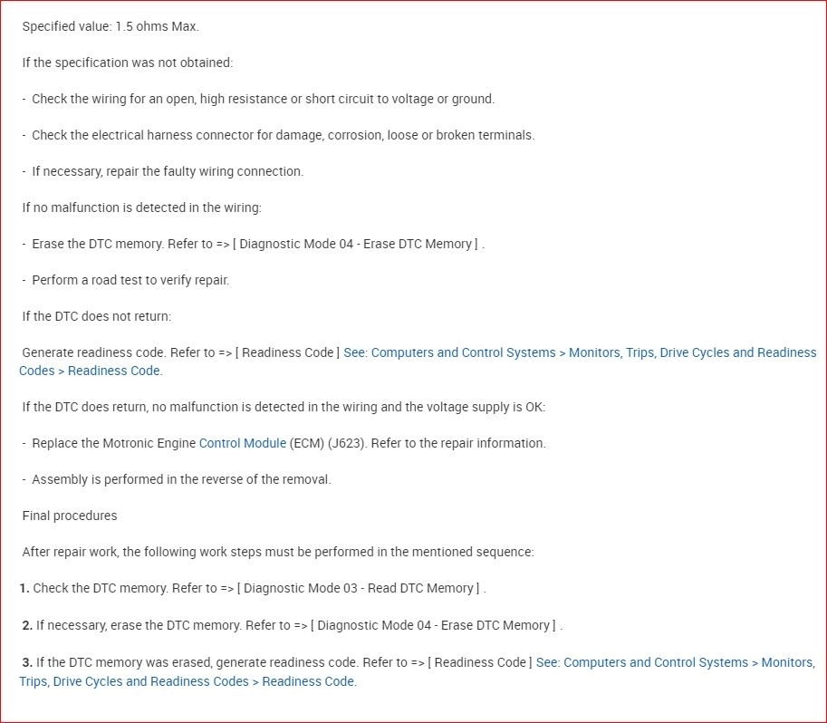

I attached all the info for this DTC including this testing procedure.
Here is a link on how to use a voltmeter to do this testing:
Let me know what you come up with and we can go from there. Thanks
