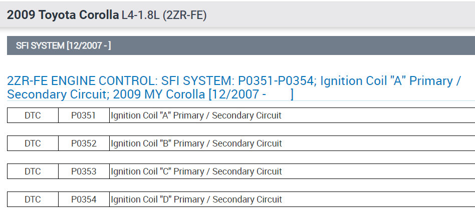

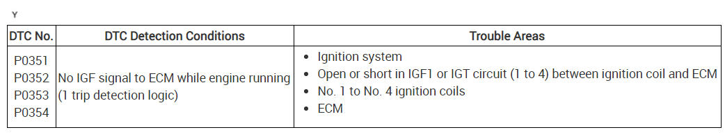

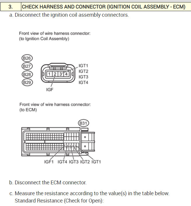

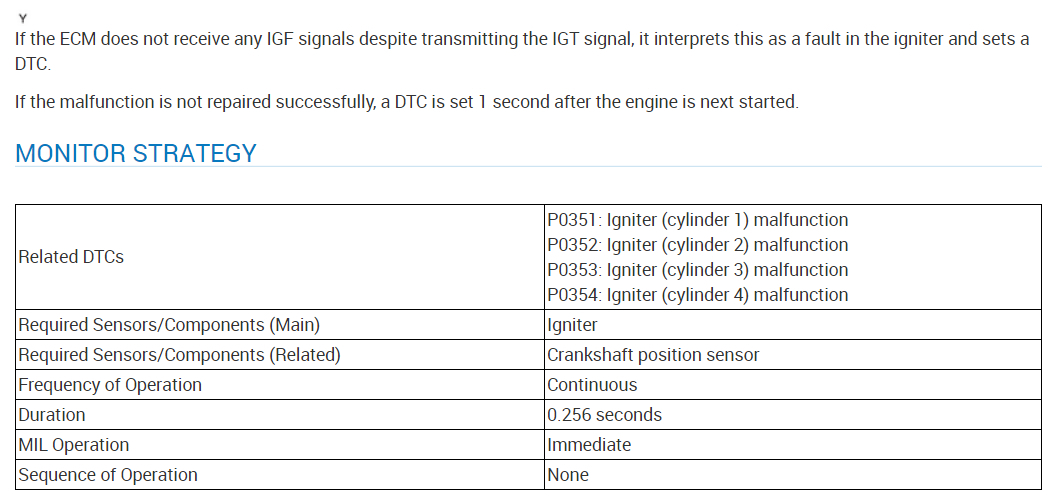

I have an error code of P0352 in my car, and my question is which coil is B? The car is a four cylinder, and I just do not know if B is the second coil from the left or the second from the right when standing in front of the car?
I have already wasted about three hours on google images and YouTube trying to figure this out, and sadly, I am still stumped.
Please help!
Matt
Nov 6, 2014 at 2:49 AM
MLDANIELS2000
  • 227 POSTS

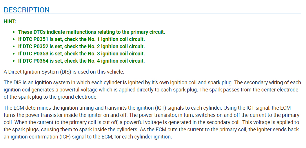

Coil B is the number two cylinder. Second from the front or crank pulley. From left to right is a, b, c, d or 1, 2, 3, 4. B is second from left. Please let us know if you need anything else to get the problem fixed.
Nov 6, 2014 at 5:31 AM
DANNY L
  • 5,648 POSTS

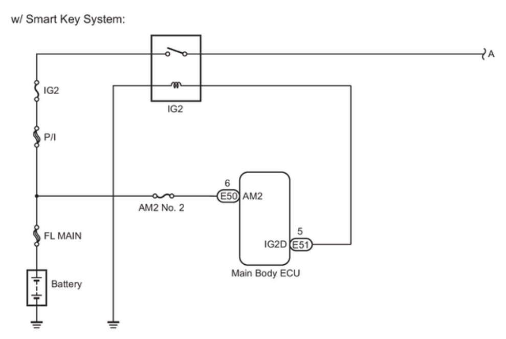

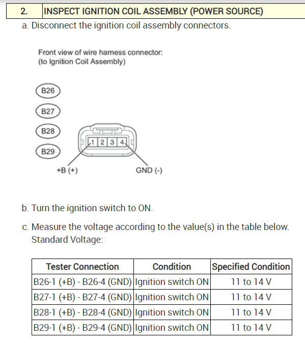

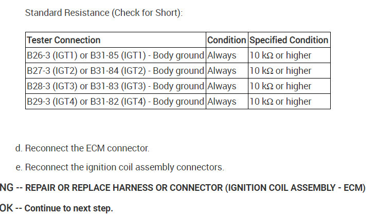

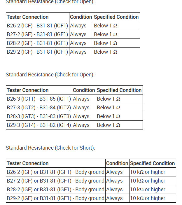

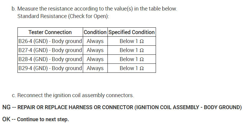

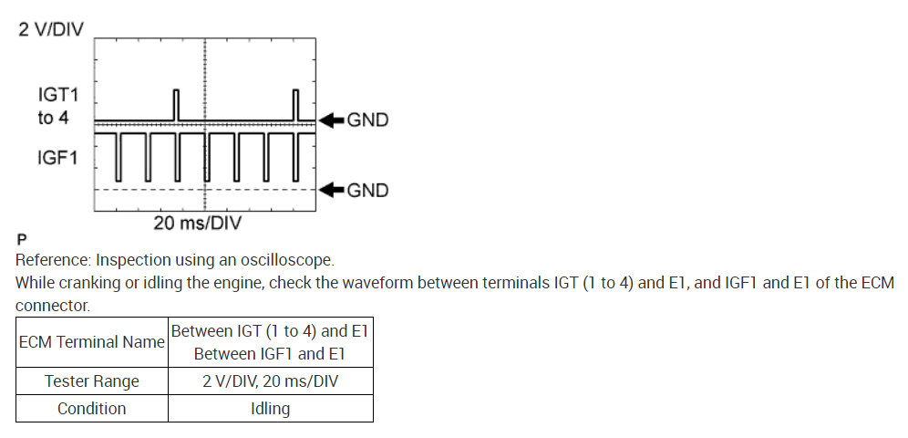

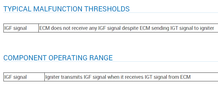

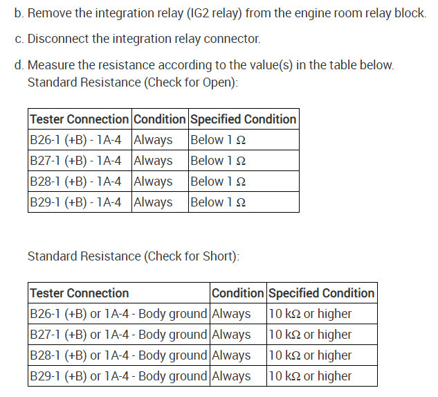

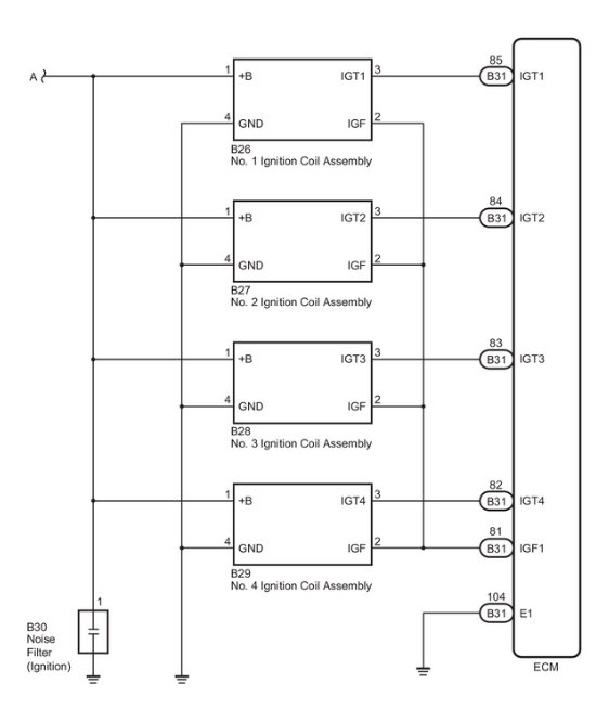

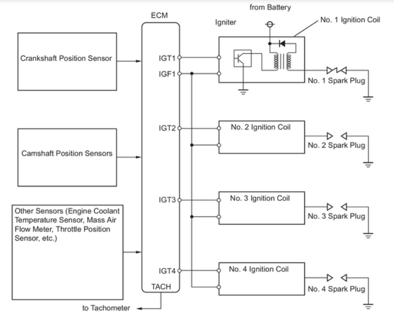

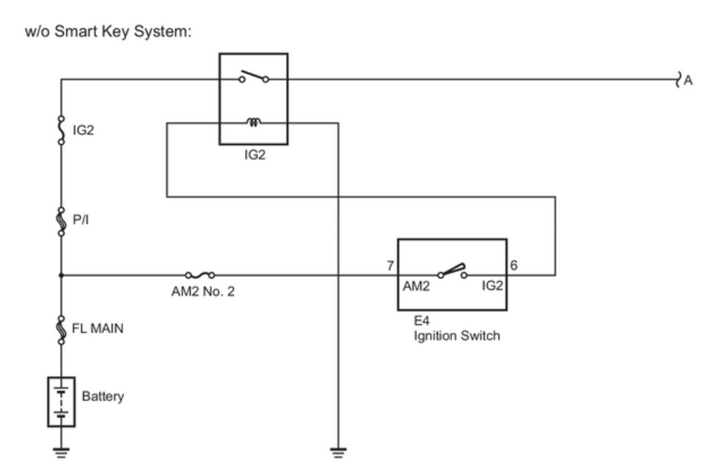

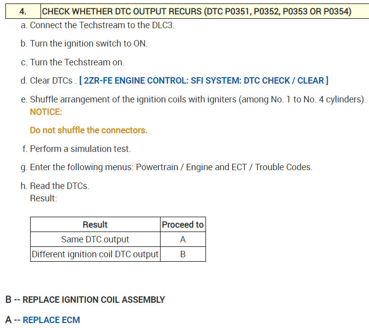

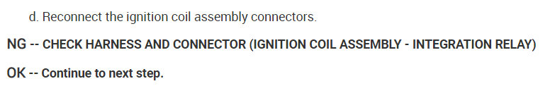

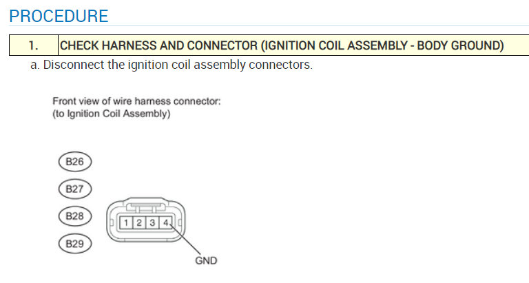

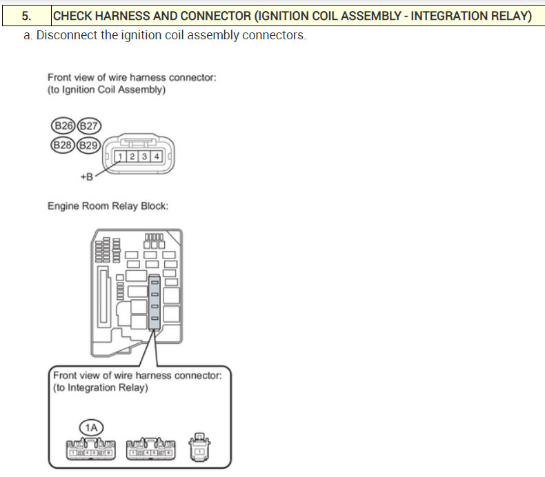

Hello, I'm Danny.

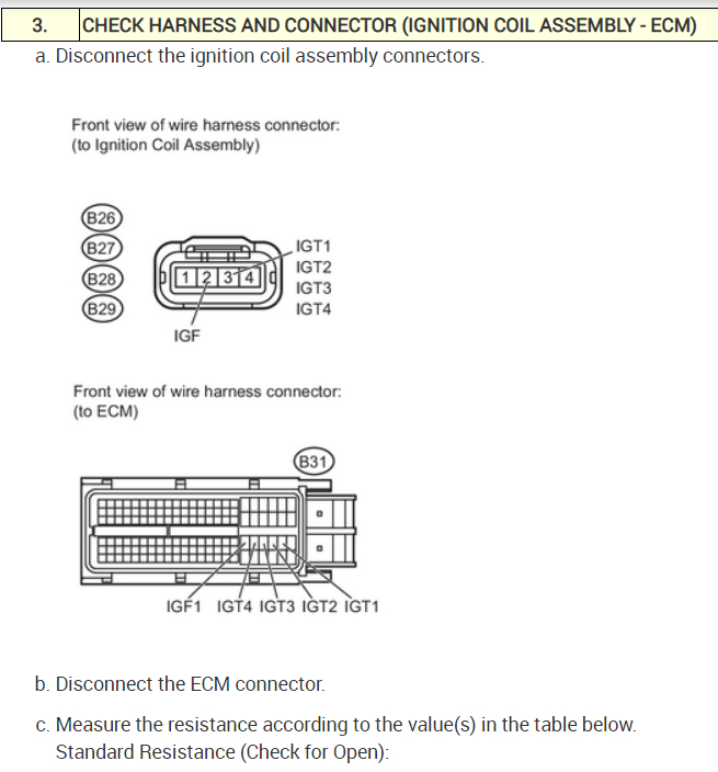

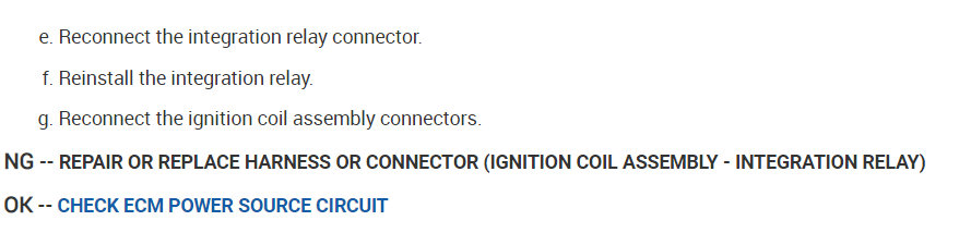

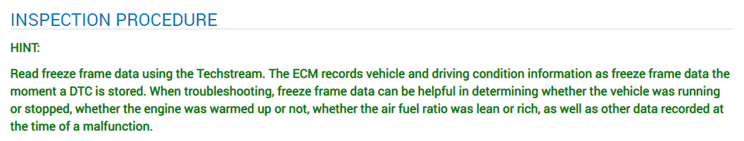

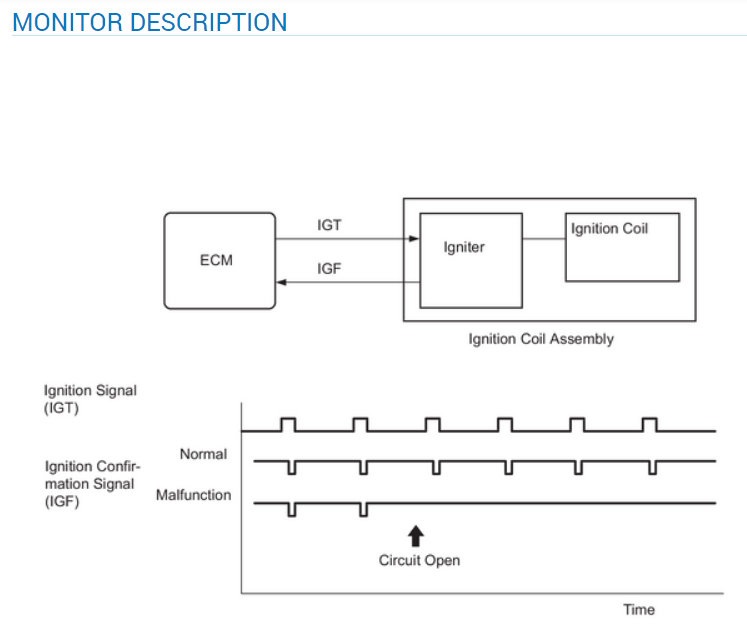

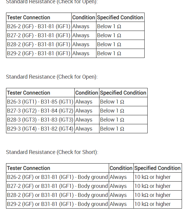

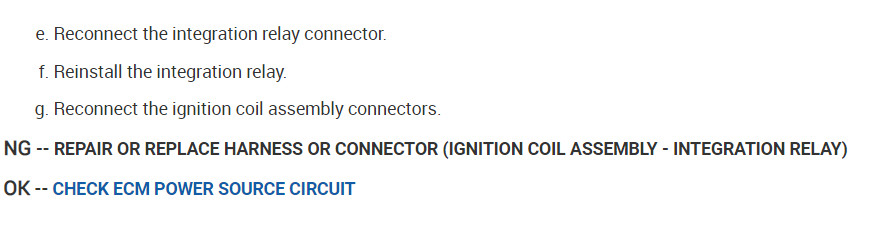

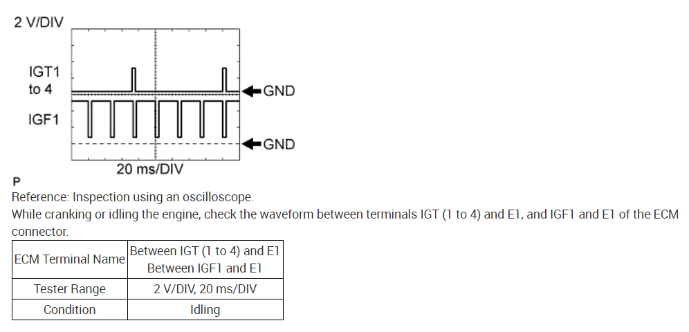

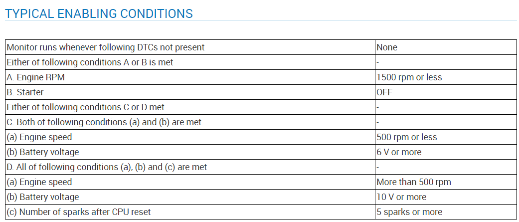

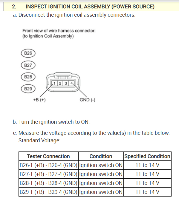

Sorry to hear you're frustrated with this diagnostic code on your car. Here is a tutorial showing how to test wiring it may come in handy:
I've attached all information relating to code P0352 below as diagnostic picture steps for your car. Hope this helps and thanks for using 2CarPros.

CARADIODOC
  • 34,383 POSTS
There's a better way to diagnose this than by replacing parts. Code 302 means cylinder 2 is misfiring. If the car is due for new spark plugs, change them first, then swap the ignition coils between cylinders 2 and 3, and the injectors between cylinders 2 and 4. Erase the fault codes, then see which cylinder sets the next misfire code. If it's still cylinder 2, suspect a valve or compression problem. If the misfire moves to cylinder 3, suspect that ignition coil.

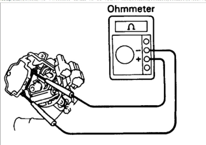

JODY007
Electrical problem 4 cyl Two Wheel Drive Automatic
my corrola is not getting spark . I replaced plugs, wires, cap and rotor? I suspect the coil is bad. how can I test it to find out what exactly to replace?
thank you
jody
Dec 26, 2020 at 4:10 AM (Merged)
  • 55,433 POSTS
Here is a great guide on how to test your ignition coil, This is for a multi coil system but it will work just fine for your car.
Inspect Primary Coil Resistance
Using an ohmmeter, measure the resistance between positive (+) and negative (-) terminals.
Primary coil resistance (Cold): 1.1 - 1.7 ohms
If the resistance is not as specified, replace the ignition coil.
Inspect Secondary Coil Resistance
Using an ohmmeter, measure the resistance between the positive (+) and high-tension terminals.
Secondary coil resistance (Cold): 9 - 15 k ohms
If the resistance is not as specified, replace the ignition coil. diagram (below)
